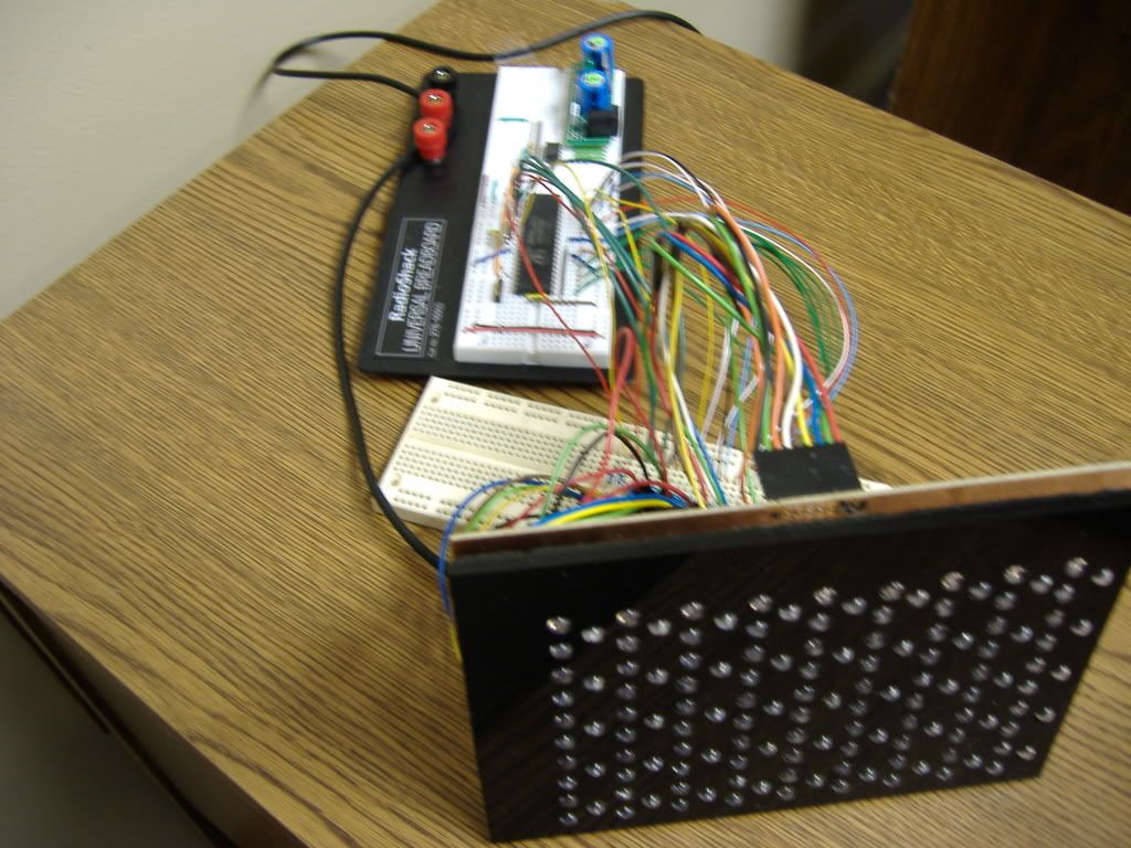

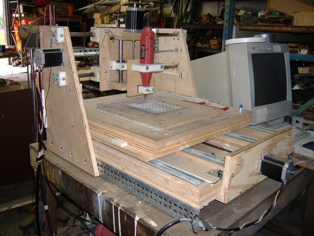

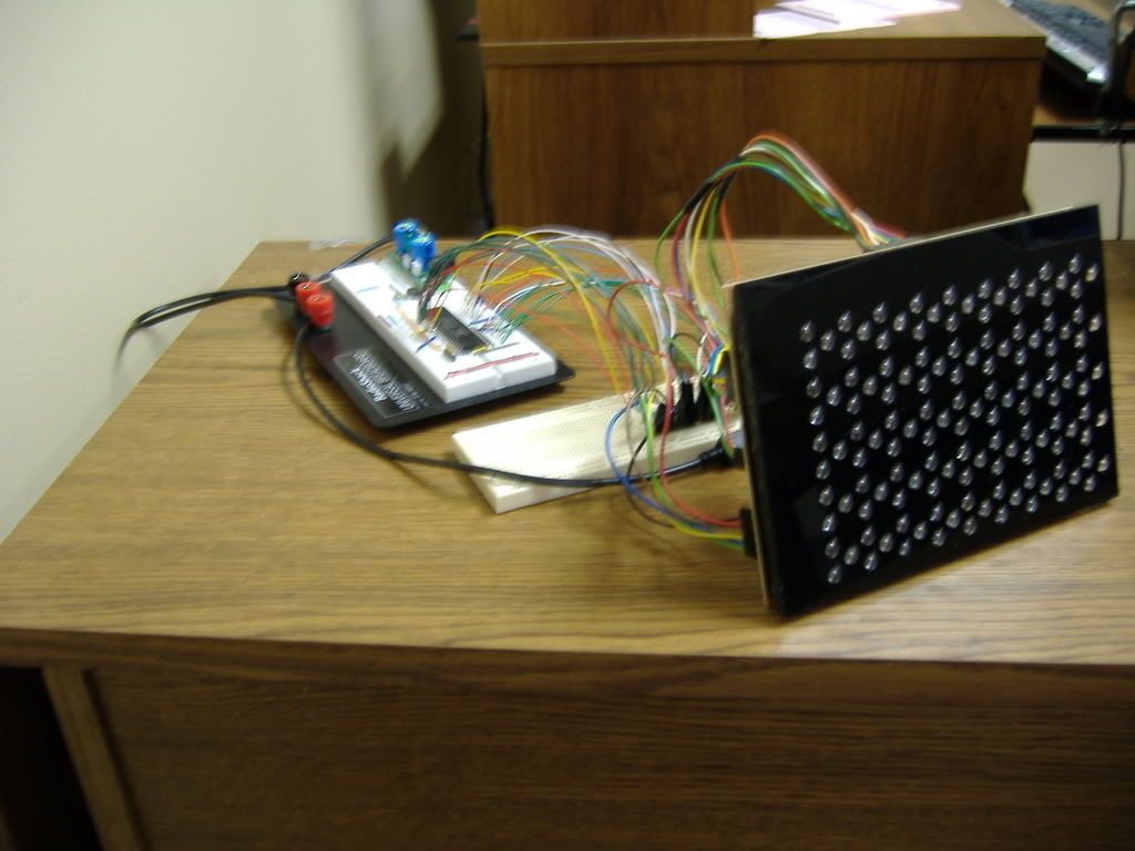

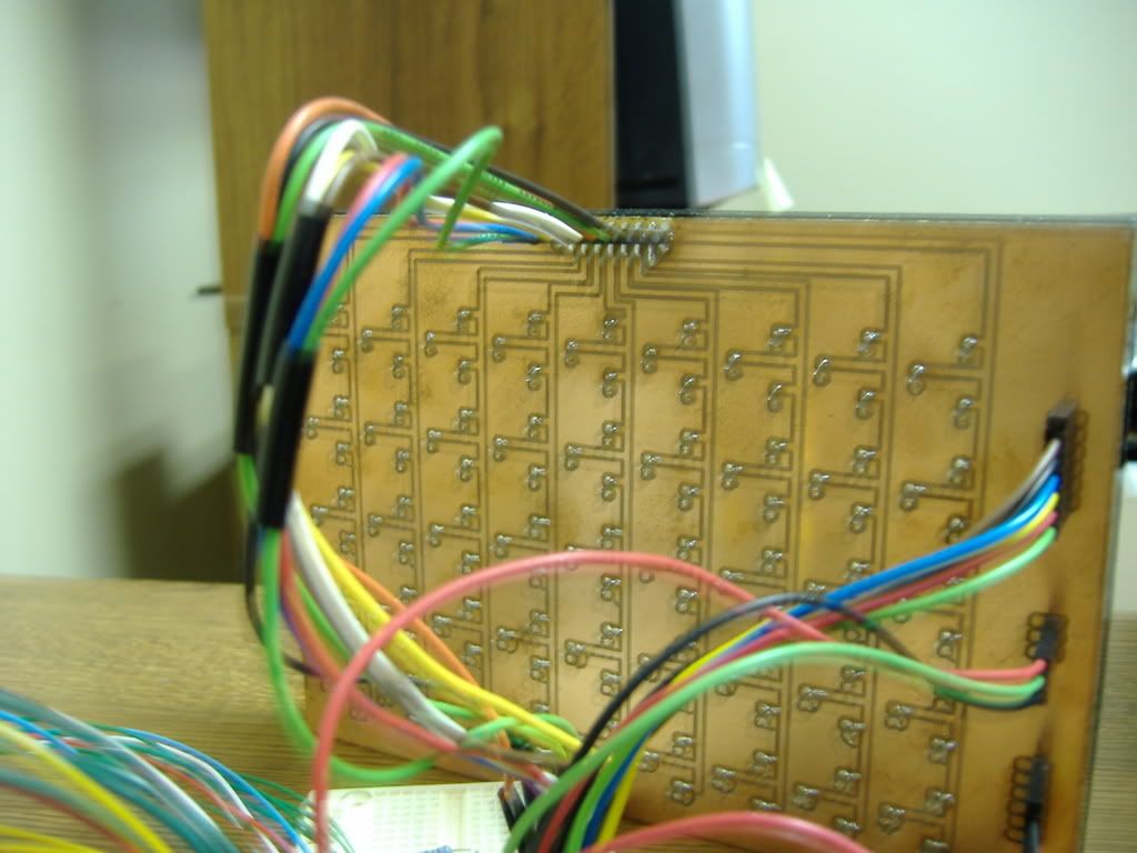

Ok,

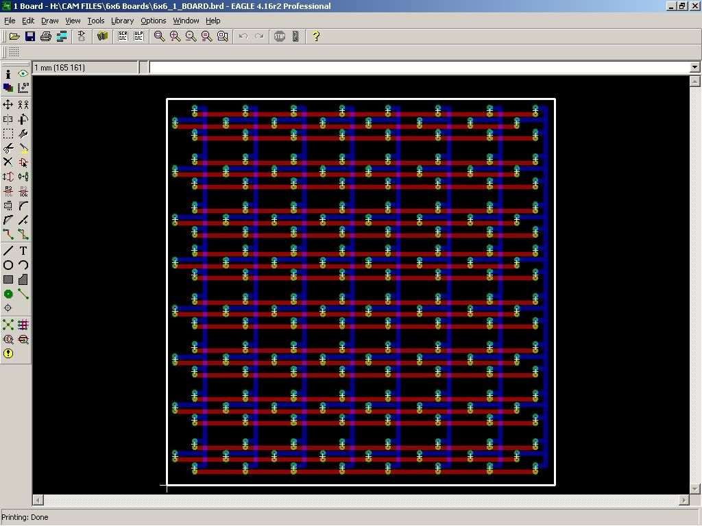

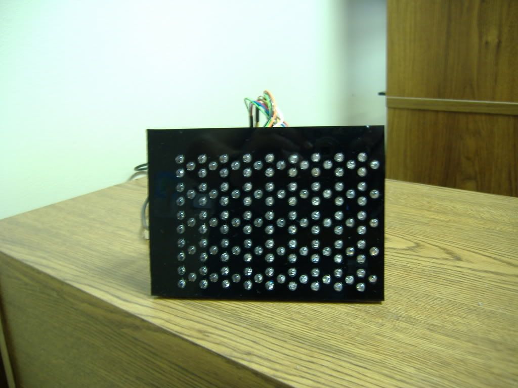

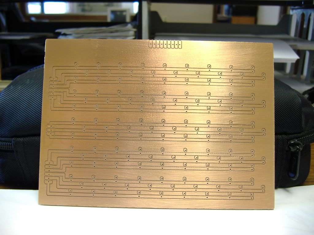

Here's what I've managed to get done on this so far. I first had to build a CNC machine
so I could mill the double sided PCB and drill the holes in the black acrylic panel.
This lab panel is just 9x15, it's 19mm Dot Pitch and uses three Led's per pixel, they are RG & B.
I'm going to be building 1ft. panels (soon), that are connectable, so I can make any size sign.
The plan is to use the Propeller Protoboard as the center controller for each 1ft. panel
I think I need to code a Pixel object in spin that works with the three basic pixels in a group
and also I need to add a duty cycle so I can do color mixing.
I'm going to be adding some Led drivers like the TLC5940, maybe Fram Memory etc. etc.
I'm almost ready to do some 1ft. panels that will snap together, I'm talking to a PCB manufacturer in Japan.
I really need some help after working with that DIY CNC machine !
I've still got to do allot of electronix work and spin/asm programming.
I'm hoping to have a completed product ready for JIT & BTO in about 3 months.
WOW, nice work on all that. I noticed the LEDs have a fairly narrow viewing angle, is that going to cause problems? For indicator LEDs on my projects I often use sand paper scratch up the LED's lens for a wider viewing angle.
Lunch cures all problems! have you had lunch?
I had not thought much about the viewing angle, most of the specs I looked
at used that led (5mm 20~25 deg). It may be, I think I will know more when I do one of the larger panels.
The cheap movie was done on my cheap camera, and it looks like some of the led are not showing up.
But you can really see them. Viewing angle might be a problem if your looking at a 7x8 ft. sign passing
on the road.

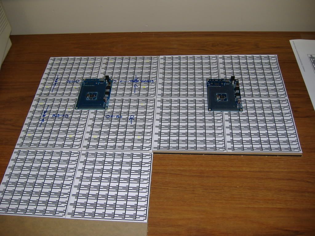

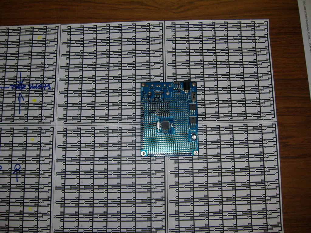

Here's some pictures of the 1ft. mach up's with the Propeller Protoboard as the controller in the center.
I hope to have the fully completed 1ft. panels with all the Led's in 1-2 months. Then all I'll need is to finnish the controller
circuits with the Propeller.
I've got to code a Pixel object in spin that has a PWM duty cycle so I can regulate each of the three RG&B led's so I can do color blending. Has anyone done anything like this kind of Pixel object ?
I used Eagle and a script called PCB-GCODE to generate the Gcode commands.
It took allot of work to get it right, her's a picture of the CNC machine.

Here's some pictures of the basic panel, I just have wires hooked up to
the Led Matrix directly from the Propeller.
Here's a general picture of the unit...
The space accross the top and side of the face panel is for some control switches and knobs
to do some cool stuff a little latter.
http://i192.photobucket.com/albums/z59/deleteallusers/DSCF0504.jpg
A different angle...
http://i192.photobucket.com/albums/z59/deleteallusers/DSCF0505.jpg
Front of the panel...
http://i192.photobucket.com/albums/z59/deleteallusers/DSCF0506.jpg
The copper PCB connected from the back...
http://i192.photobucket.com/albums/z59/deleteallusers/DSCF0508.jpg
An Eagle schematic
http://i192.photobucket.com/albums/z59/deleteallusers/6x6.jpg
A picture of one of the first boards (Columns back side). (It has some isolation problems that were fixed)
http://i192.photobucket.com/albums/z59/deleteallusers/DSCF0485.jpg
The front side... remember this was the first board I cut
http://i192.photobucket.com/albums/z59/deleteallusers/DSCF0484.jpg
on the road.

The next goal is to do a 2'x2' prototype so I have somthing to work with... (Each 1ft. panel is going to be managed by a Propeller.)
Then a 7'x9' (Thats in feet). That would boost my confidance a little. ( I already have many, many parts, and I'm going to
Hong Kong in about two weeks)

Here's the photo's
http://i192.photobucket.com/albums/z59/deleteallusers/DSCF0511-1.jpg
http://i192.photobucket.com/albums/z59/deleteallusers/DSCF0510.jpg
