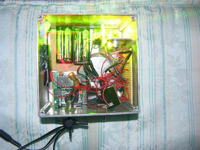

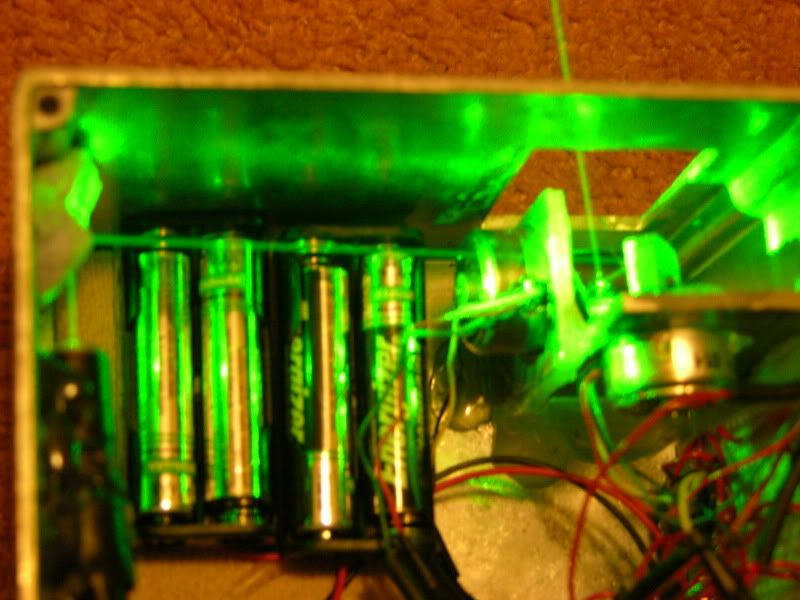

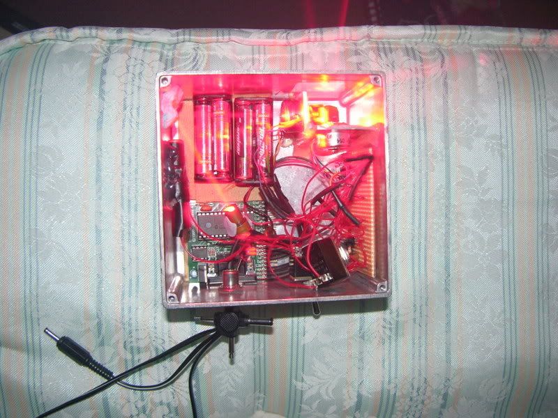

    a few pics of inside my box of tricks -
    http://i80.photobucket.com/albums/j185/andy_con/lasers/scanner/DSCN3079.jpg
    http://i80.photobucket.com/albums/j185/andy_con/lasers/scanner/DSCN3078.jpg
    My site - www.laser-man.co.uk

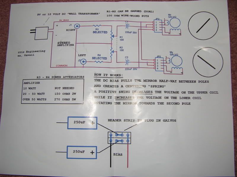

    Andy, Please send me or post the info on the galvo's as well...
    I can't find the ones you have on ebay, and commericial ones are way to expensive for a hobby.
    Rodney
  • andy_conandy_con Posts: 53
    edited 2006-11-20 22:34
    here are mate - the info i got with them
    http://i80.photobucket.com/albums/j185/andy_con/DSCN3066.jpg
    http://i80.photobucket.com/albums/j185/andy_con/DSCN3065.jpg

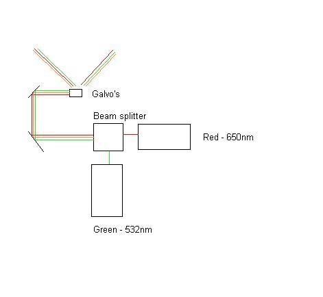

    this is what i want to do.
    Providing i can use the controller to turn the red and green laser on and off.
    The orange line is for when both laser are on together it makes a yellow/orange colour
    http://i80.photobucket.com/albums/j185/andy_con/beamsplitter.jpg
