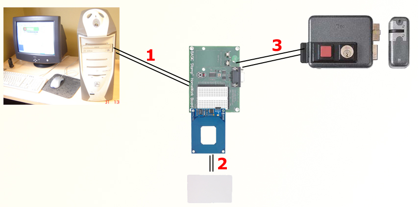

····Right now·I am using pbasic to recognize the tag and·activate the lock,·my problem it·is that I do not know··how to accede to a database from·a bs2, i don't know if i could use the·Stamp Daq for excel, the module Pink or another thing. Help.
Thanx
Best Regards from Chile
Goten
To do so, you ONLY need to create a program, not to buy any other devices than the RFid reader, the automated lock and your PC.
This program will listen/talk through a serial port (COM1 or COM2 or ...).
The BS2 will be at the other end of the serial cable and that's all folks, you're done !
The stamps is waiting for a card...
The stamp reads a card (and tell the PC through serial line).
The PC then knows an RFID event happend, and wait for the ID number.
The stamp then tell the ID number to the PC.
The PC checks in the database.
The PC returns a status code to say 'ok' or 'no' (I suggest a beep to tell user " ").
The stamps is waiting for a card (and so on)...
This require a bit of programming langage other than PBASIC (such as java, c, etc..) and an adapted database (mySQL) and the SQL driver to interact with the database.
Interesting project, keep us informed !
PS. I dont know how commanded/automated locks work so I did not mention this aspect of your project.
PS². If there are only a few people who will use a RFid 'key', how about using a flat file '.txt' instead of all the database mecanic ?
Post Edited (Tibot) : 2/7/2006 10:00:52 PM GMT

Basically you need to define what you’re trying to do in more detail, instead of us guessing.
i saw on internet (black box) a rs232 to rj45 converter. but i thought that i could use 2 rfid reader with just one bs2.
i really don't know to much about programming, i just had use pbasic... what you suggest?· Tibot said Java, Paul Bake Visual Basic... and others c++, think that i'm a newbie

I advise that you stick with the RS232 link with the stamp for now, it eliminates the need for purchasing the PINK module and simplifies the programming on both the Stamp and PC side. You want to make the first iteration of your design as simple as possible. Once you have that working like you want, you can then think about moving it to ethernet communications.
·1+1=10
Post Edited (Paul Baker) : 2/10/2006 2:22:35 PM GMT
This may seem like a lot of work, but you will be much better served by the things you learn and the gratification of completing each of these tasks.
Good Luck!
