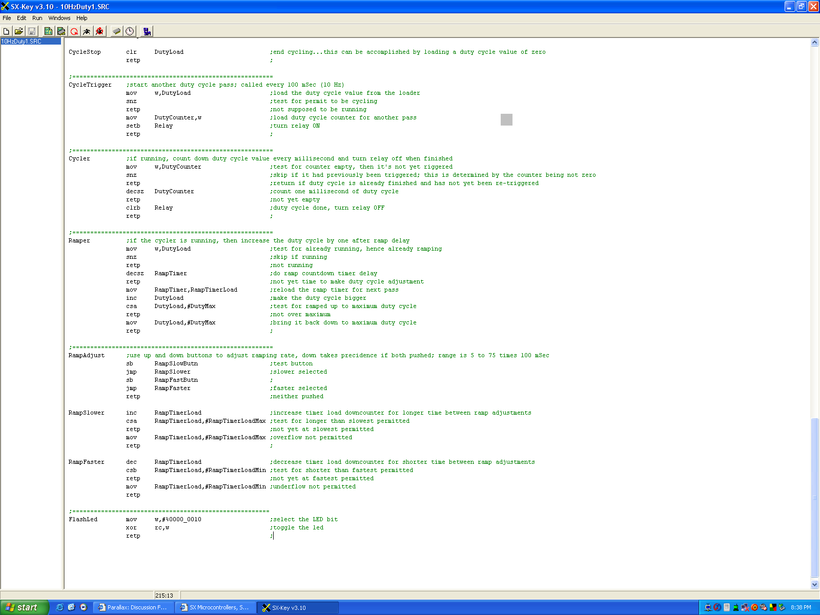

    I thought your requirements to be an excellent example of how to use a simple (non-preemptive) RTOS, so I coded up your program for you so others could see the benfit of using such a time-structured approach.
    But because I am somewat SX/B illiterate and for efficiency,·I wrote it in my favourite......assembler.
    Please do understand this is just one particular implementation; there are MANY ways to skin this cat....only one example is given. And not necessarily the best or fastest or shortest, just something with LOTS of comments so many people can more easily follow it.
    The main thing to understand is the scheduler. The interrupt sets a flag every 5 uSec, and the main loop simply waits for that to occur. Then all heck breaks loose. I have somewhat arbitrarily·chosen the scheduler to have 100 uSec, 1mSec, 10 mSec, 100 mSec and 1 Sec time ticks to run the various tasks that are required in·THIS rendition. Actually some of those ticks are not directly used, so they might be combinable with other time ticks. However, their inclusion does not hurt, and for generality it demonstrates the RTOS better.
    Each of those ticks is triggered by counting off the decade of faster ticks above it. They need not necessarily be what I chose, but, hey, I like nice numbers.
    So, every 1 millisecond I call the·RAMPER that controls how fast the duty cycle changes from minimum to maximum; I call the CYCLERUNCHECK to see if the input conditions (rb.2) asks that the duty cycling should operate at all; and I call the CYCLER which actually calculates and puts out the relay duty cycle on rc.0.
    Then every 10 milliseconds the RAMPADJUST is called to accept push button input (rb.0 and rb.1) to·adjust the·ramping speed slower or faster. These have limit sets from 5 units to 75 units.
    Every 100 milliseconds the CYCLETRIGGER is called to initiate yet another complete duty cycle, and it is this trigger of course that sets the 10 Hz cadence.
    So for fun, you could relocate the·1·second·LED flasher (rc.1) to·the 100 millisecond tick level and see what happens.
    The beauty of this scheme is that all these tasks are (apparently) simultaneous and independent, and one need not concern (much) about timings of one event affecting another event. That said, though NO task may hog all the processor time and lock up the system. Delay loops are an ABSOLUTE NO-NO!!!!! After all, that is why we use an RTOS!
    Run it through Guenther's simulator, and single step it in "debug" it with your SX-Key until you really get the hang of it.
    Holler if you have questions.
    Cheers,
    Peter (pjv)
    Sorry about the screen image quality, I'm still experimenting on the best way to tackle that!

    Guenther, thank you very much for the reply, and your absolutely correct the PWM command will not support what I wish to do. Your outline is actually quite helpful. I'm still a little lost on running an ISR as far as timing and interfering with other functions of a program so for now running the counters in the main program is probably best for me. A quick clarification on ISR's though if I may. Using the RTCC to trigger an ISR my understanding at the moment is that wherever the program is it will jump from there to the ISR and then return to execute the next line of code. Is this correct or will it return to the program start or Main? If I understand that right then the few clock ticks it takes to increment the timers in an ISR would only have a negligable effect on whatever else I'm doing. Also thanks for the book that came with my SX Kit, the time I've spent leafing through it at this point has given me a fantastic glimpse of what the SX is capable of, and enough understanding to gain useful information of PJV's code example.
    PJV, Even though assembly is still a mostly foreign language to me your code example goes a long way to giving structure to what Guenther was describing and how to accomplish of what I am looking for. The commands I mostly dont understand but the structure and program layout seems like it would be the same in SX/B at least I didnt see anything that couldnt be implemented. Between the layout and the comments its a tremendous help, and I'm sure will go a long way toward helping me accomplish my eventual goal of getting more into assembler. Just sat and went through it for the last hour getting a feel for what its doing. It looks like the key I was missing was selecting units of time that fit in with how I wanted to ramp the duty cycle and the fact that I could basicaly run a clock not in absolute time but tailored to what I want to do, and the light hits as I sit here and reply, I was looking for the math to calculate absolute constants for the steps in percent of duty cycle to acheive the ramp rate I was looking for when in actuality all I need to do is increment a variable from 5-95 one increment at a time over a set time period and snatch the duty cycle variable from that count as time passes...... Thanks again for the example, I'm not sure of thats exactly what your doing but it helped a lot.
    Javalin,·Thanks for pointing this out, I'm off to search for his project and see what I can glean from it, if I remember right though it was controlling duty cycle through external commands via serial and the part that was stumping was basicaly ramping through a scheduler. Either way I'm sure I'll pick up something useful from it. If nothing else maybe I can puzzle out the scheduling now that its considerably later with much more reading since the last time I looked.
