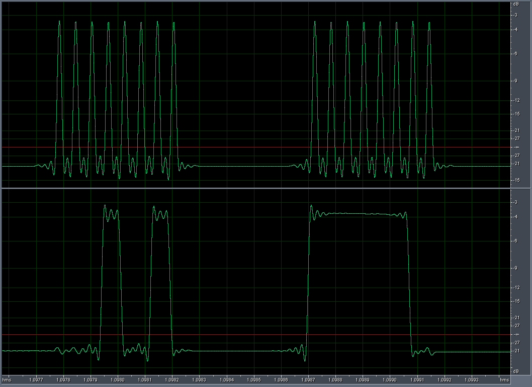

    So after checking out all the different software out there to turn your sound card into a o-scope.
    I found out they all kinda SUCK.
    I have had better results with literally recording the data like a sound clip and then zooming in with my favorite sound recording program (cool edit pro) aka adobe audition.
    Check out the image attached. It recorded the clock line and the data line coming form my BS2 to a serial LCD. (using shiftout)
    I was able to see each clock cycle perfectly, and each high and low data perfectly. (you just have to zoom in enough)
    I guess I just found my LOW END storage scope.
    My sound card is an old SBLIVE (pci)
    I used buffer hardware to cut the voltage down. The inputs were connected directly with the BS2's P0, P1.... So I am putting in 5volts. And after the buffer hardware, it puts out about 1.5 volts to my sound card line in. (look at image)

    Cool Edit is indeed a fantastic program I have the 96 lite version, same as 2000 sans spectrometer, only 3 function groups at a time, but I just restart it to obtain a different group, a free program that outperforms most commercial sound editing programs with no loss of functionality, just a minor annoyance.

    Heh. heh. You surprised us all.
    I have a Audio program[noparse][[/noparse]an MP3 recorder and editor], but I never thought of using it as a recording O-scope. It can go on for hours.
    Anyway, they are all limited by the ADC in the sound card and related computer inards.
    And, they all seem to leave you without any reasonable emprical callibration [noparse][[/noparse]because you have to externally divide voltages over about +3 and time bases are somewhat ball-parked].
    So the audio program is just as good at giving you something to work with a beginning.
