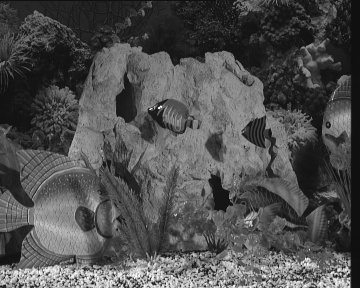

    Paul, a computer would be fine for the processing, and a normal sized desktop is not at all out of the question, in fact, thats what I thought I would have to use in the first place. The comparing line 14 to 16 example is EXACTLY what I had in mind. I have 2 black and white cameras (280 lines of resolution).
    If you can't visualize what I'm after here, I found an example:
    original left stereo(left), depth map(right)
    anyway, I guess this is going to involve some coding, but I think that I can handle that OK, I was just wondering if anyone had seen any thing that looks like that.

    Yeah, I think a few labs at UF were doing things along these lines. While I wasn't a member of any of them, its likely talking with researchers in the medical imaging lab and the sattelite imaging lab that the cross correlation thing came from. Most depth plots Ive seen use white as the foreground color but your example is the opposite, my personal experience is·from creating sterograms.
