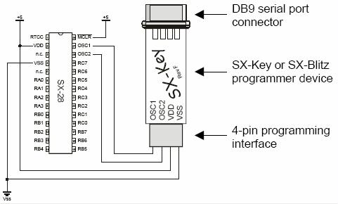

I am getting an error message while trying to program a SX28 on a custom board. The message I receive is "chip connection failed". The board should work but does not. What possible reasons would there be for receiving this message(I did not use sleep).
I based the programming part of the circuit on the attached image. The only difference·being that I added a 10k resistor from MCLR to Source like on the sx tech board.

    Have you read the voltage Vdd to Vss as you try to program it?

    Do you think the voltage is dropping when I program? Perhaps the capacitors hooked up to the power regulator·are inapropriate. On the tech board there is a 10uf cap which I am not using, as I followed the spec sheet for the LM2937 which suggests a .01uf and .1uf cap. I will try to replace the .01uf cap with a 10uf cap and see if it helps.

    FYI the SX Tech board also has a 0.1uF capacitor (C3) between the Vdd and Vss conections - placed right next to the processor. I think it's important to keep this capacitor as close to the SX processor as possible.

    Replaced the capacitor to be inline with the tech board, still no luck... What Am I missing confused.gif

    Is there anything else connected to OSC1 or OSC2 ?

    Are you absolutely sure your supply is a SOLID 5V? You indicate it is 5 Volts, but is that with a scope or a meter?
    Only a scope can tell you whether or not there is a glitch on the line; even a short (few millisecond) dip on the power line will upset the Key.
    A meter can only tell you if the DC level of the power is bad; it cant tell you that there are no glitches.

    Looks like you have a resonator connected to osc1 and osc2, but that shouldn't prevent you from programming.
    Usually the causes are:
    Not a stable 5V supply
    MCLR not held high
    Something connected to OSC1 or OSC2
    SX-KEY plugged in backwards
    The only other thing I can suggest is if you look at my sx-video schematic, I made 50 of these and every one is programmed on the board.

    ^^ that helped alot, I spotted a problem, I am connecting VSS to pin 3 instead of pin 4. Stupid mistake·blush.gif· I need sleep i guess.

    That shouldn't be too hard to fix. Pin 3 is listed as No Connection (I don't know if that mean no connection INSIDE the chip, or that YOU shouldn't connect anything to that pin).
    But a little jumper should fix you right up. Let us know if that fixes the program.

    I cut the trace with a hobby blade, and placed a small piece of stripped wire to pin 4.
    As I stare at the mess around me, I thank you all for helping me analyse my problem. The power source which you guys kept stressing panned out. Now that the first is over and done, I look forward to making thousands of boards smilewinkgrin.gif
