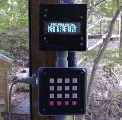

    An image of our display controlling a garden watering system using a
    keypad
    http://www.matrixorbital.com/forum_imgs/Gallery/Pond/backwash.jpg
