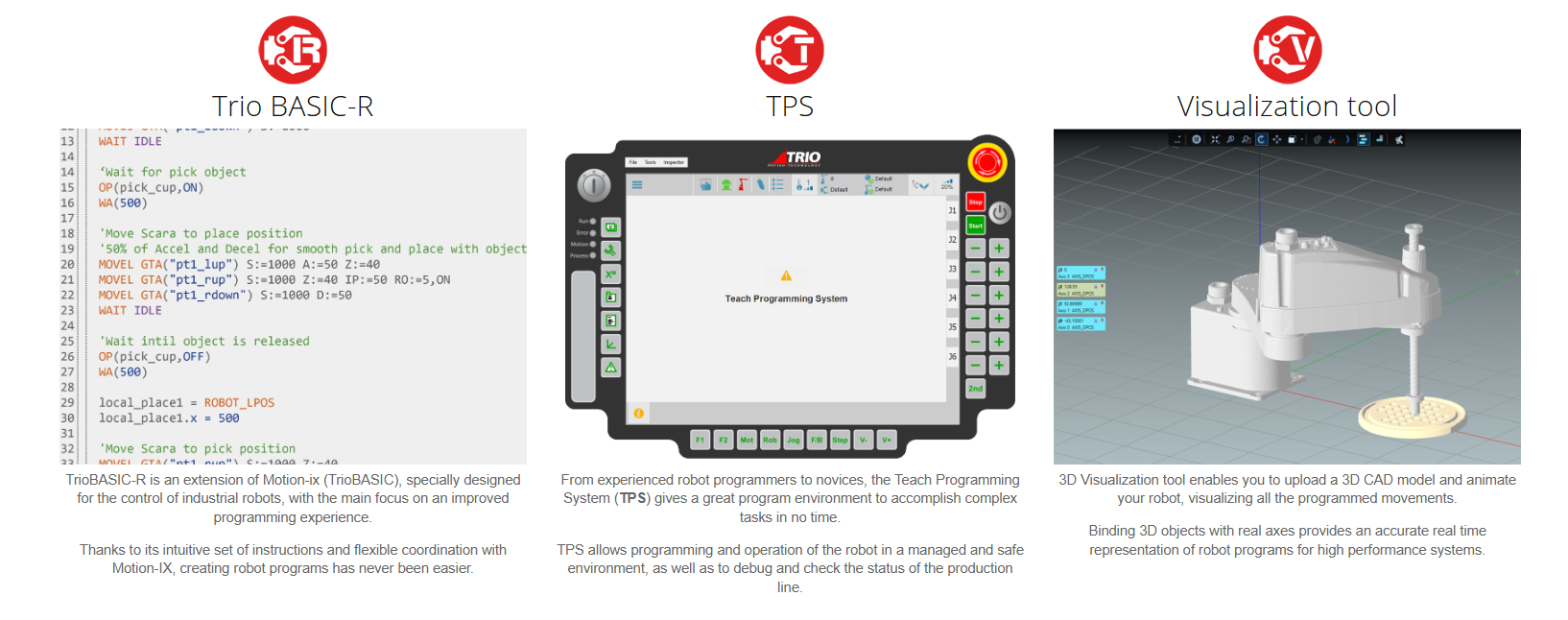

    Here is an example of a multitasking BASIC on a high-end controller:

    Hm, yes, these are nice looking tools. It's hard for me to recognise BASIC in the text though?!? And their controller https://www.triomotion.com/public/products/p660-p665.php has 1.2 GHz, 64 Bit Dual Core ARM Cortex A55 Processor, 1 GBit DDR3 Memory. = 256*P2 That's a very very different world to P2. How many man-years to develop such software?
    What language do you actually use for P2? FlexBasic?
    In my experience the choice of language for a microcontroller is not so important in relation to the availability of libraries to access hardware, sensors, smartpins. (The code snippet for "BASIC-R" above does not show any BASIC but mostly special commands to access hardware. They even use := ) To use the original SPIN2 interpreter or a slightly modified one, still working for SPIN, would enable to use OBEX library, that's the idea here. Also the combination should be compact.

    The orange words are the Basic statements. Yes, the shown statements are particular to the Trio because they are dealing with the specialised hardware. The regular Basic statements like PRINT/GOSUB/GOTO/FOR/NEXT/WHILE/WEND/DO/UNTIL/IF/OR/AND/LEN$/MID$/... they all still exist too.
    There is a function declaration mechanism that's also very useful. It's almost like an object in that a group of functions have to have their own locality and are stored in a separate .BAL program file. While the regular Basic programs are stored in .BAS files.
    It has a nice simple way of doing multitasking too. Each program file is launched as a task with priority according to the task number. There is one large global shared variable array that can be accessed as both symbolised and by array look up. This same array is where remote devices like Modbus/Ethercat also have their mailboxes located.
    The Trio's aren't great with strings but then a motion control system isn't going to be used for heavy string processing.
    My one niggle is it doesn't support symbolised bit memory.
