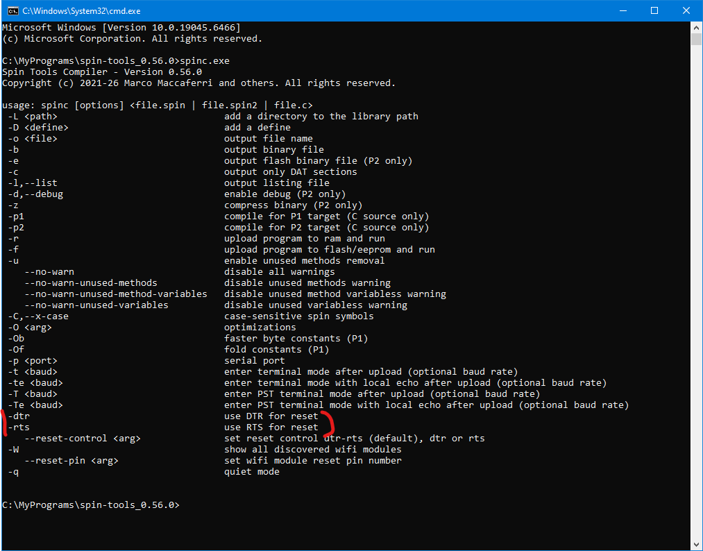

Or can use RTS instead? That looks to be more easily supported?
PST has the ability to toggle DTR and RTS, so this leads me to believe that Propeller loaders probably followed this scheme to allow one or the other.
Marco's spinc.exe has switches for DTR and RTS.
