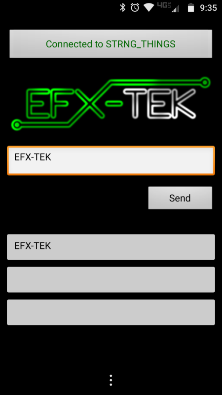

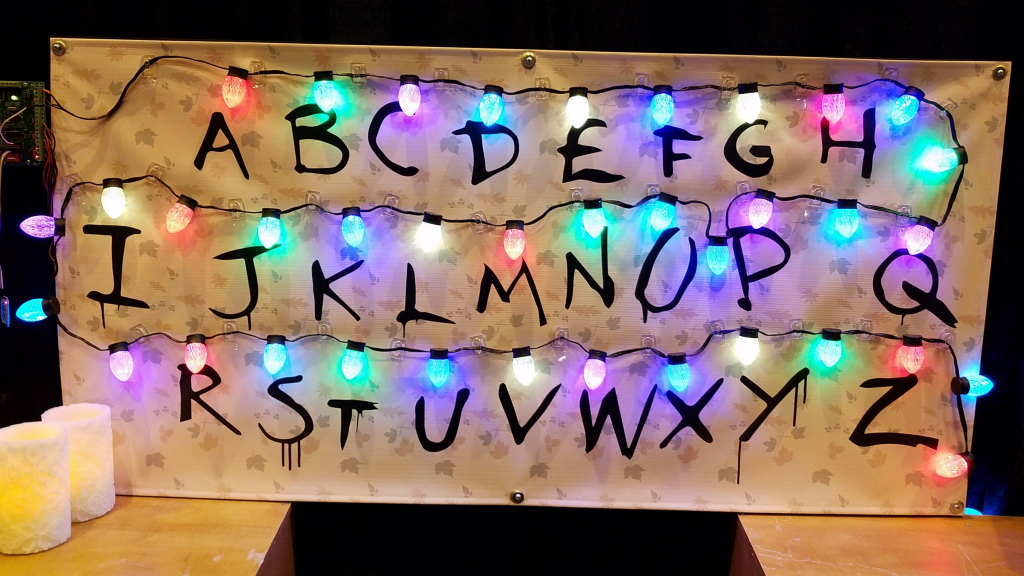

    About 8 years ago I created a display for the EFX-TEK booth at Transworld (a giant Halloween trade show). I uses the EFX-TEK HC-8+ (I designed teh circutry) and an off-the-shelf BT module to control WS2811 Christmas lights to make a sign thayt was an omage to the show Stranger Things. After getting things working with a basic Bluetooth terminal I made a little custom program using MIT App Inventor. Here's the sign.
    Here's the little Android app (I've heard that MIT App Inventor works for iPhones now, too):
    The program on the P1 understands a list of words and will treat them as commands. Any word that is not in its dictionary gets spelled out on the lights. It was a big hit at the show.

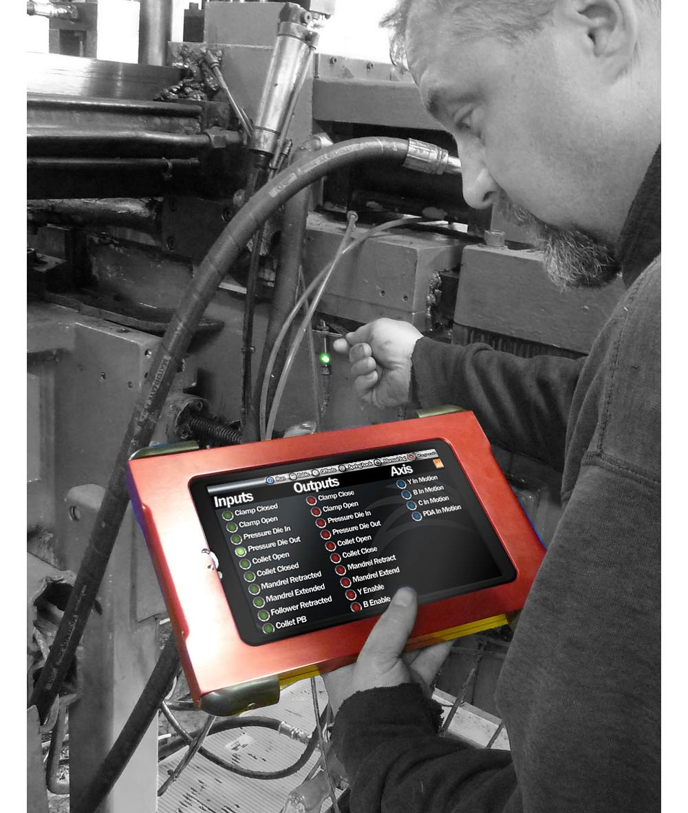

  • I have been controlling closed-loop servos (hydraulic and electric), solenoids, etc., for many years, using BASIC and mobile devices.
    When diagnosing a sensor problem, no need to recruit help....Take the HMI to the area of interest.
    Problem finding the machine schematics? Keep them on the device.
