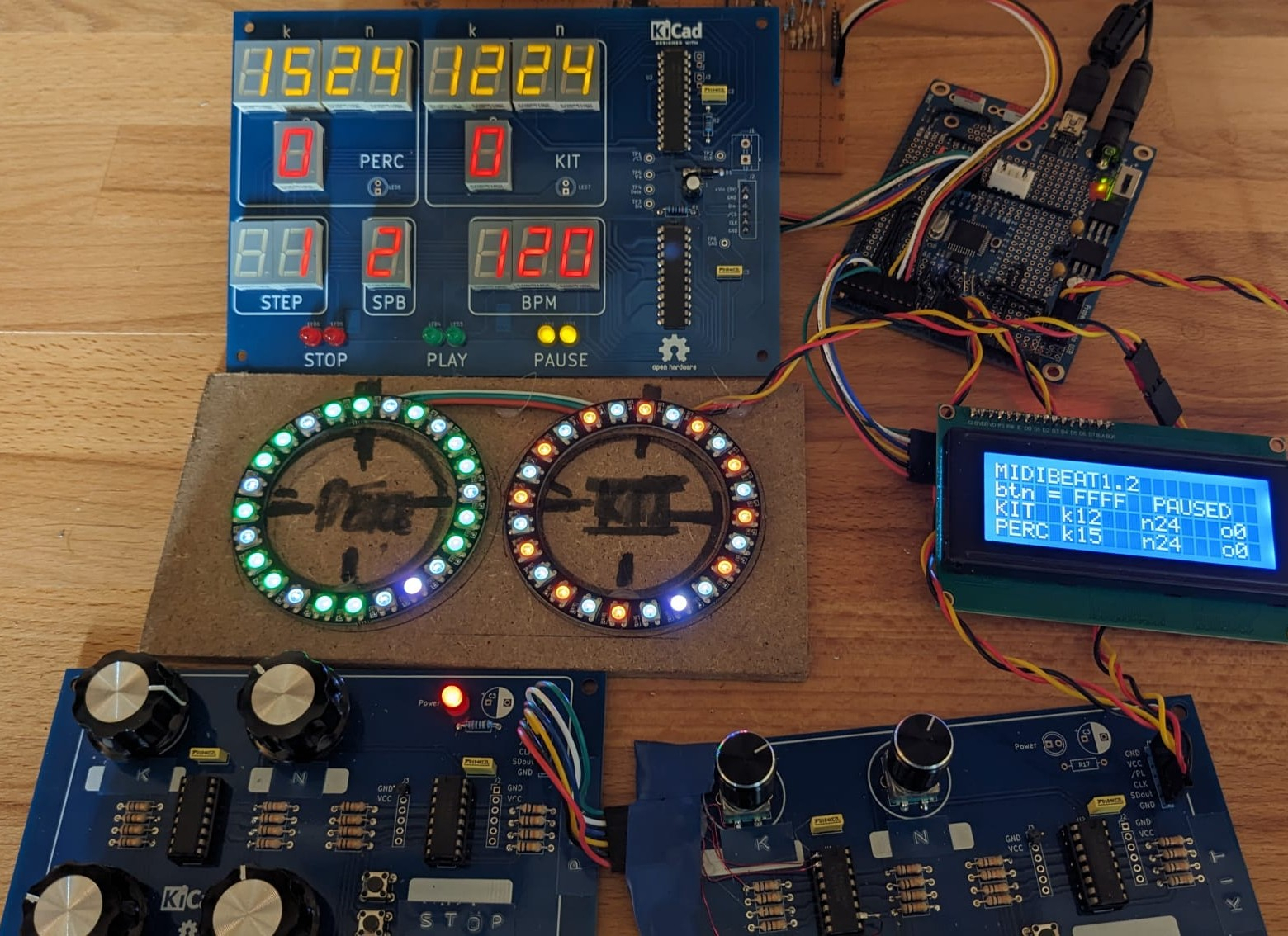

Playing with the free Deep Seek chat bot this morning, took several iterations but the result works.

    Where did all the gear come from? That's not just programming there.
  • the gear is a couple of very simple PCBs I designed with KiCAD and had made by JLCPCB. Some bits & bobs from Ali express, including RGB LED rings and I²C LCD, all hooked-up to an old P1 project board. Two input PCBS are daisy-chained to provides 32-bit serial data for encoder and button patterns, other PCB is a 16 x 7-seg LED display with 8 LED indicators, again serial data from the P1. There is also a MIDI output port, still on some strip-board hiding in the background.
  • evanhevanh Posts: 17,317
    That doesn't sound cheap. What was the assembly cost?

    The PCBs are approx £5 each inc. shipping. No assembly cost, all through-hole parts, easily hand soldered, cost pennies. Can't remember the cost of the RGB LED rings or I²C display but they were not at all expenisive, check Ali-express etc. I already had the P1 project board, it's at least 10 years old and was originally used in a long-forgotten camera trigger project! Best of all KiCAD and Spin Tools are free!
    I think this is all VERY low cost, it's kept me busy for a few months!
