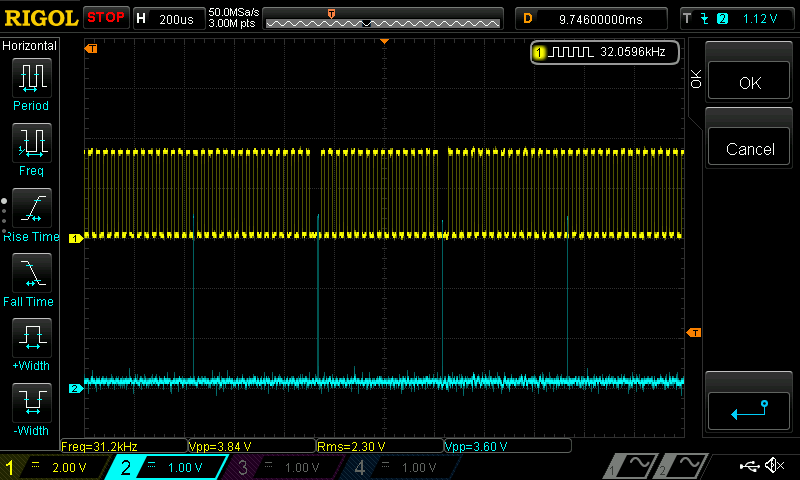

Goal: Output a group of 16 pulses to drive a step driver module with the Smart Pin Pulse Mode and then output the next group. With only a very small gap due to the time needed for new setup.
Problem: Although the smartpin mode is completely stopped after every group (see code) the pulse stream is not realigned to the setting intervals. (Which are timed with waitct1)
To show the bug in this case setting interval is 17 cycles. So you would always expect a gap of slightly more than one output cycle. Instead the start of the next group shifts in relation to the setting and sometimes the gap is there and sometimes not.
Blue is port 48 to show the relation.

(If you are using the IN bit of the smart pin to restart the group you always loose one output cycle.)
Neither wrpin #0 nor dirl does really stop the smart pin.
Please verify and include this to the known Bugs. It has cost me some hours.
Christof

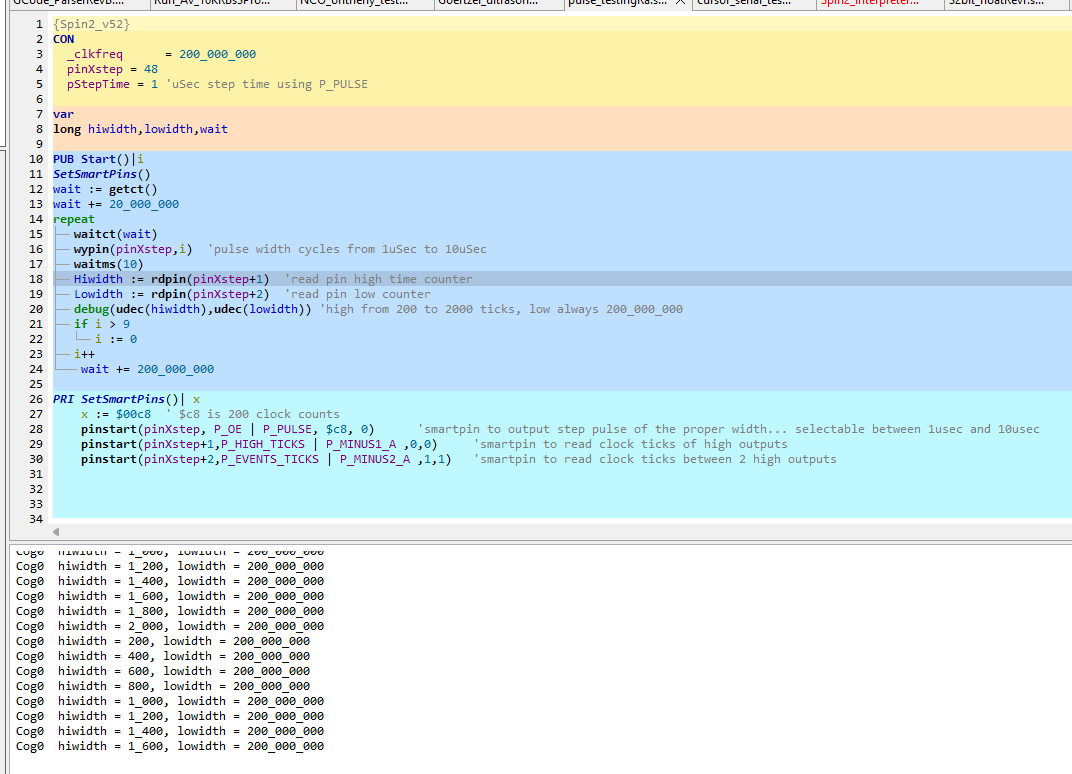

    I use pulse to output the step pulse for sw generated stepper pulses...
    initialize it..
    pinstart(pinXstep, P_OE | P_PULSE, $c8, 0) 'smartpin to output step pulse of the proper width... selectable between 1usec and 10usec
    then output a pulse with a unit width of 1uSec. at my 200Mhz clock
    wypin(pinXstep,pStepTime)
    I do the pinstart() once, then just do a wypin() whenever I need to output a pulse.

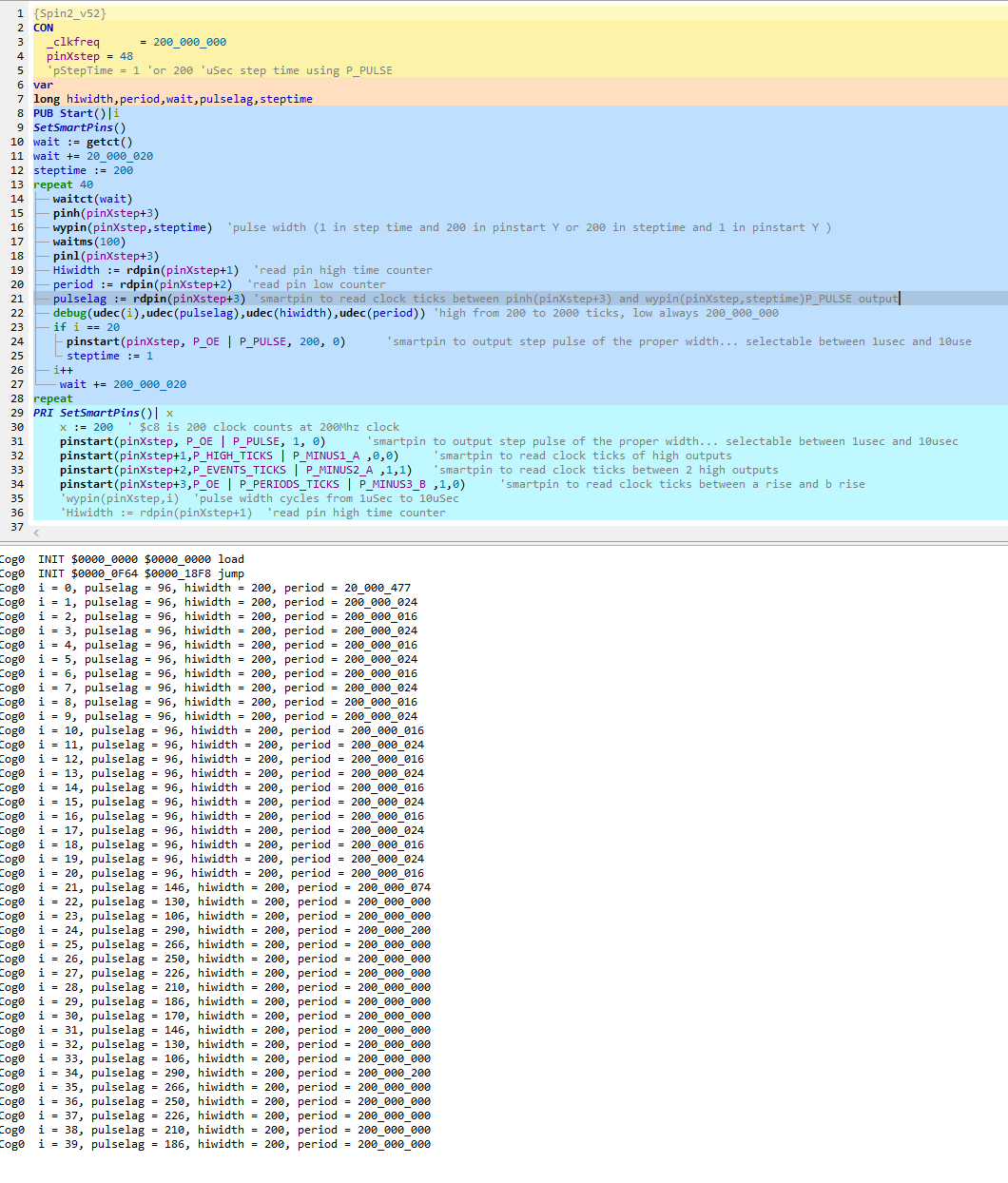

  • I am using the P-PULSE smartpin setting to output a proper pulse width for a stepper "step" signal.
    Turns out I was having a similar problem.
    I had the base period counter set to 200 with a 200Mhz clock making the base period 1uSec.
    Then with a WYPIN(pin,uSeconds) I could out output a perfect pulse width. But turns out there can be a lag between the WYPIN write and the pulse output start...
    It only starts when the base count gets down to zero.
    So, I did what Evan said, go with a finer base period. I set base period to 1, and have to write a value of 200 in WYPIN to get a uSec...
    My program has a waitcnt loop at 200_000_020 clocks, so after each loop the residual in the base period is 20 counts less, and the lag between the WYPIN write and the pulse output is 20 clocks shorter...
    The first 20 loops use the finer resolution on base period, the second 20 use a base period of 200... and in the second 20 you can see the lag time get shorter after each loop...
