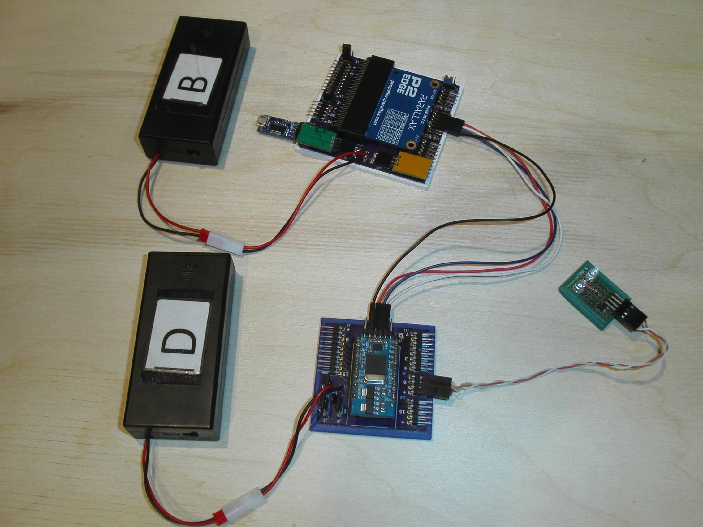

P1 loader for the P2
iseries
Posts: 1,541
Here is a program that will load a program onto the P1 from the P2.

This took several days of work to get to this end result. Like any good puzzle there where a lot of pieces and some of them were missing.
I first started out reverse engineering the Proploader program using Visual Studio in C++. This program has many functions and includes code to program the P2. I needed to follow the code to just send a program to the P1.
The code seemed convoluted to say the least, but I push on.
I then decided to look for the P1 bootloader manual and found this to be nonexistent. I then checked the forum and luckily found the boot loader manual from Chip. This explained a lot of the chaos.
The P1 bootloader was looking for binary data and not serial data. The Proploader program had to make serial data look like binary data. The crazy data being sent by the Proploader was actually binary data.
Now I had a manual that explained each step needed to program the P1.
I continue to write the program in C++ in Visual Studio so that I could get each step of the process to work and was able to use break points to see what was going in each of the steps. Like any good puzzle you need to see if the pieces fit.
After getting the Visual Studio program to load a program onto the P1 I moved to the P2. Now the P2 can just use binary data and didn't need to use serial at all. This meant starting over with different code structure since I could just program directly with no special characters.
Now for you new people, there is no P1 without serial attached to it. The P1 mini is no more. So, the only way you can make this work is to use the bread board version.
Using Visual Studio Code now I started writing the binary version of the loader. Sending binary data was simple enough and only required special timing to do the 1 and zeros. Getting the data back from the P1 not so simple. I decided to use a smart pin instruction that would give me the binary value returned from the P1.
Now it was just a matter of putting all the pieces together and getting the timing to work.
I now know why the Proploader program is so complicated and programming the P2 is so simple.
Where am I going with this. The next stop is to move the program onto the ESP32.
