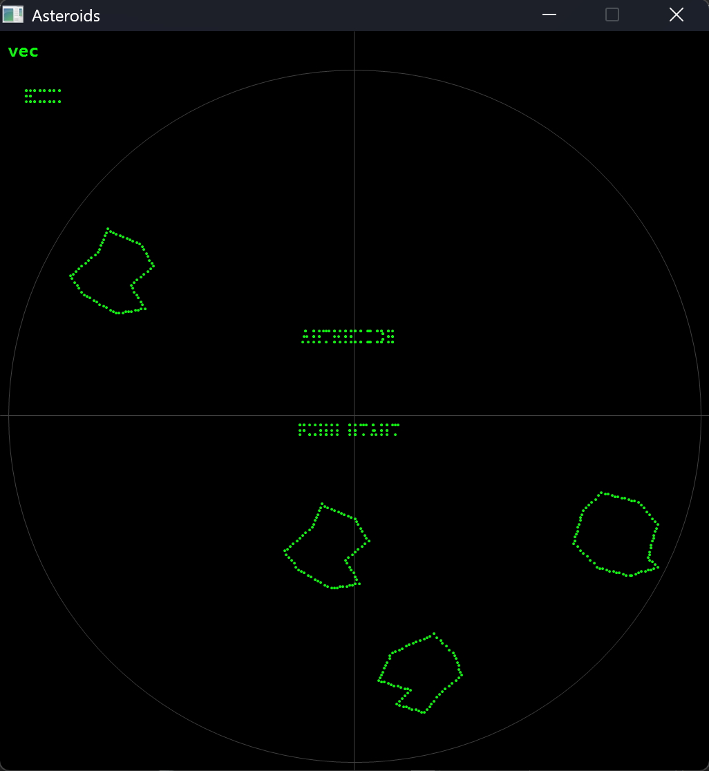

On a lark last night, I asked Claude to convert the original Asteroids 6502 asm to spin2 for the P2 and display the vector output in debug. After a few iterations, it boots and displays. Claude seemed to have an idea of what I wanted and made the decision on its own to remove the coin op functionality.
Kind of a fun little doodle before bed.

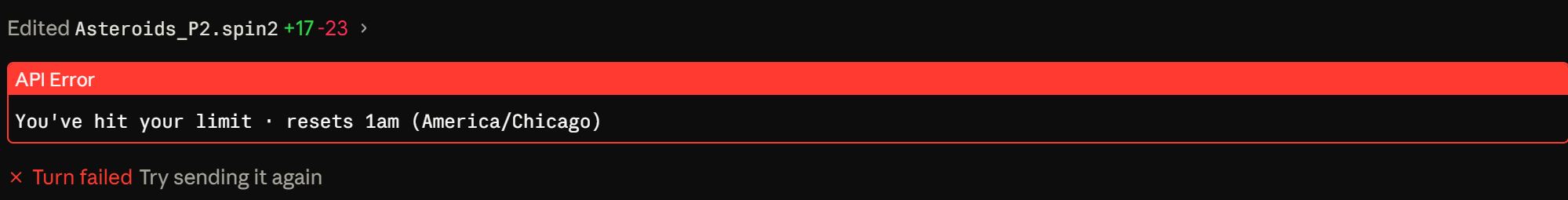

    I wish I could take credit for it, but I really didn't do anything but give it a few prompts. There were a couple of things it didn't understand about how the display "looked" so I told it to look at the debug and iterate. And it did! Then I ran it into my spending limit, LOL. ($20/mo) I had to wait 4 hours to finish this morning.

    Which probably indicates it threw away what you gave it and copied higher level code from other completed game ports instead. Asteroids must have been ported a hundred times over the years. On that note, it is nice to see how compact the code size is and how well structured the game as a whole is. I've not made a point of looking at such ports in the past.
    The game can't be very fast executing, one dot at a time, but then not a lot to display either.
    I suppose that's where the LLM has it easy. A couple of edits for init, plotting and joystick and that's all there is to port from boilerplate to Prop2. The only Prop2 hardware used is pin reads for the joystick.

    Imagined it drawing vectors instead of dots, but maybe that’s how the real hardware worked?
    If it were lines, could try the anti alias code on it…
  • AJLAJL Posts: 532
    The original arcade hardware had a true vector display. Pretty much every port since has had to approximate that on their raster displays.
    Some are better than others…
  • ke4pjwke4pjw Posts: 1,324
    edited 2026-04-23 01:26
    That is what I expected. I did a project where the P2 did vector drawings. Basically you had one pin for x, another for Y, both DACs, and one to turn on the gun. When you hook it up to a scope, you just see dots where the XY is set, but many of them at once due to the phosphorus persistence.

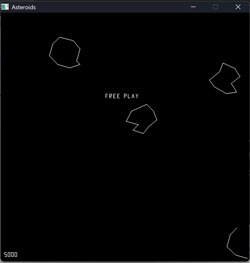

    I think if you had it use PLOT, in which case it could draw lines and UPDATE after a screen draw, it would be way faster. Then, you could try having it write the whole thing, in PASM, still using DEBUG for display. You, my friend, need the $200/month Claude deal.
    That's what I did with the other vector project and it worked amazingly well!

    I took @cgracey advice and changed it to plot. I did test it a little bit and it seemed to work, though I need to actually wire up some switches to see if it actually works well. I also changed the target FPS to 60.
