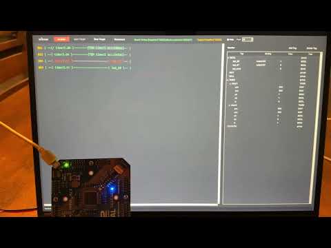

TLDR demo here:

So this morning, I was thinking about my next little test project and remembered that I'd always wanted to make a little PLC IDE that worked a bit like the Studio 5000 software I use at work, which connects to Allen-Bradley PLCs. I told Codex to take a look here: https://cq.cx/ladder.pl to get started with a GUI.
I had a Raspberry Pi Pico 2W not too far away, so I told it to make a runtime that runs on the Pico and would allow my PLC IDE to do live viewing of the ladder program running inside the Pico (created with the ladder editor in the GUI). It just worked. So I started asking for timers, counters, and integer instructions (compare, math, etc.).
I got my old P2 Engineering Sample board out and asked Codex to make a runtime for it. I told it the board was connected to a serial port on my Mac and the escape sequence to enter Taqoz to play with the propeller. After about 30 minutes of work, Codex replied that it was ready to test.
I put my source code here: https://github.com/speccy88/RSmicro
I feel both really lazy and really amazed at the same time. In 3–4 hours, I did what could have taken me months to do. Codex just spat out thousands of lines of code without complaining about what I asked it to do.
I know not everyone is keen to use these tools, but I think for a lot of the challenges we have as hobbyists trying to maintain and port a lot of code, these agentic tools are invaluable.
Just to finish, I asked Codex to explain in detail how it did the Propeller 2 runtime. Take a look at what I got:
