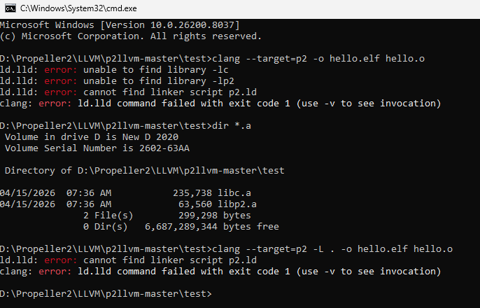

  • RaymanRayman Posts: 16,302
    edited 2026-04-15 11:45
    @rogloh Those seem to make it happy. Thanks!

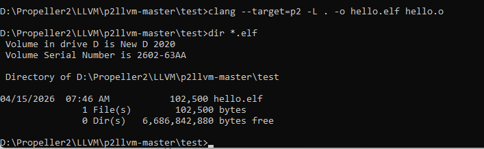

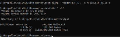

    Now, seems also missing p2.ld.. Searching for that now...
    686 x 440 - 35K
    Ok, found p2.ld... Made an elf! Guess should see if it actually works...

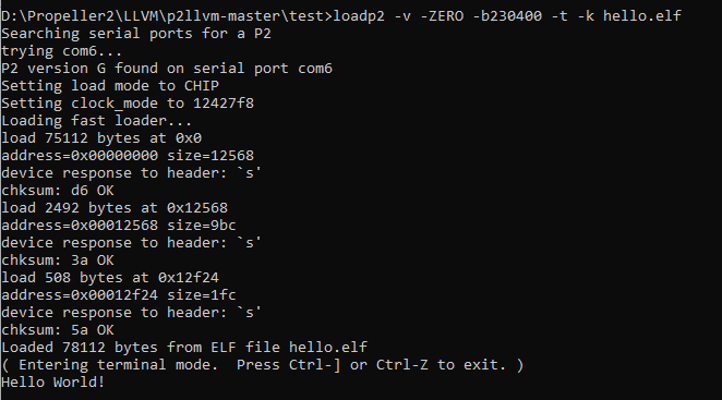

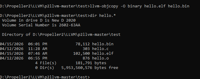

    edited 2026-04-15 12:07
    Borrowed loadp2.exe from FlexProp and it works!
    Build folder zips to 713 MB right now. This is mostly the bin output. Looks to be a lot of extraneous stuff, but hard to say. Guess will try to trim it down to essentials...
    662 x 367 - 21K

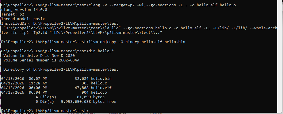

  • roglohrogloh Posts: 6,331
    edited 2026-04-15 12:27
    Good. Finally some progress. You can disassemble the code with llvm-objdump -d file.elf assuming that got built with Clang. You can also see the symbols and what got included with llvm-objdump -x file.elf.
    Strangely I did a simple hello world and it was only 24844 bytes while yours was bigger at 78112 bytes. Maybe you included a bunch of other stuff?
