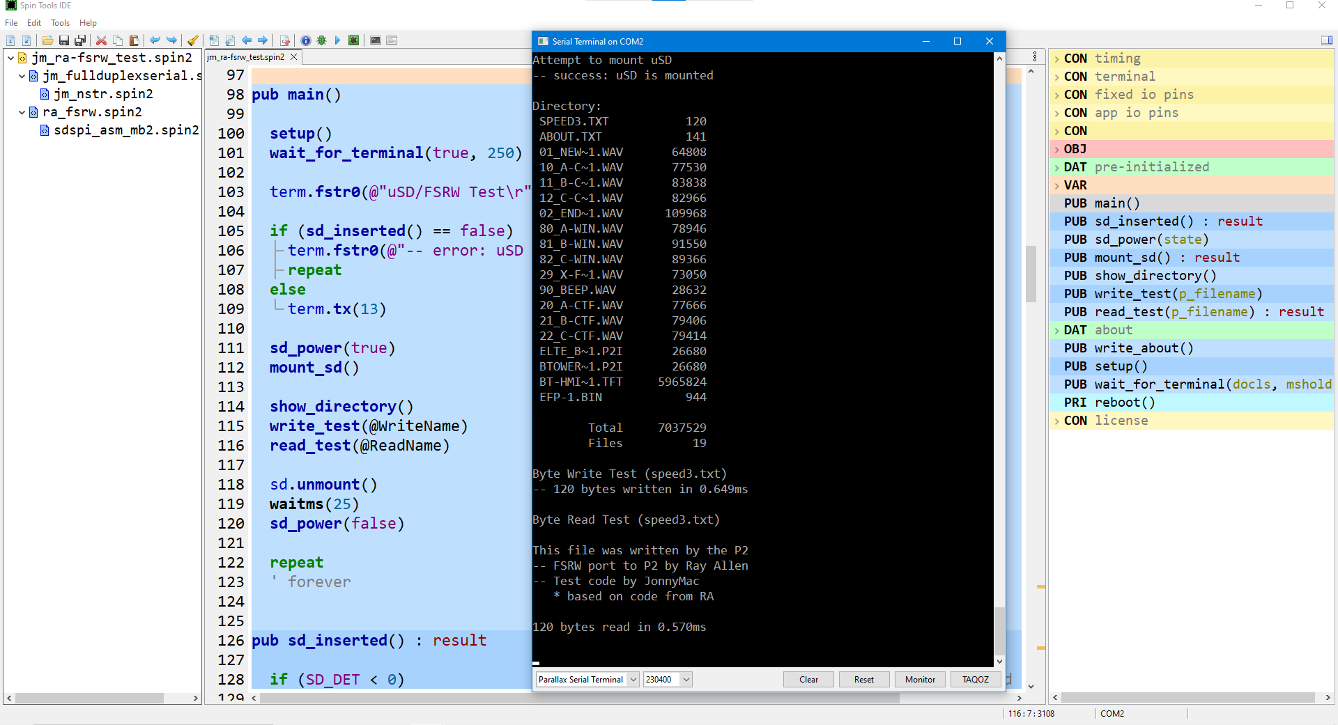

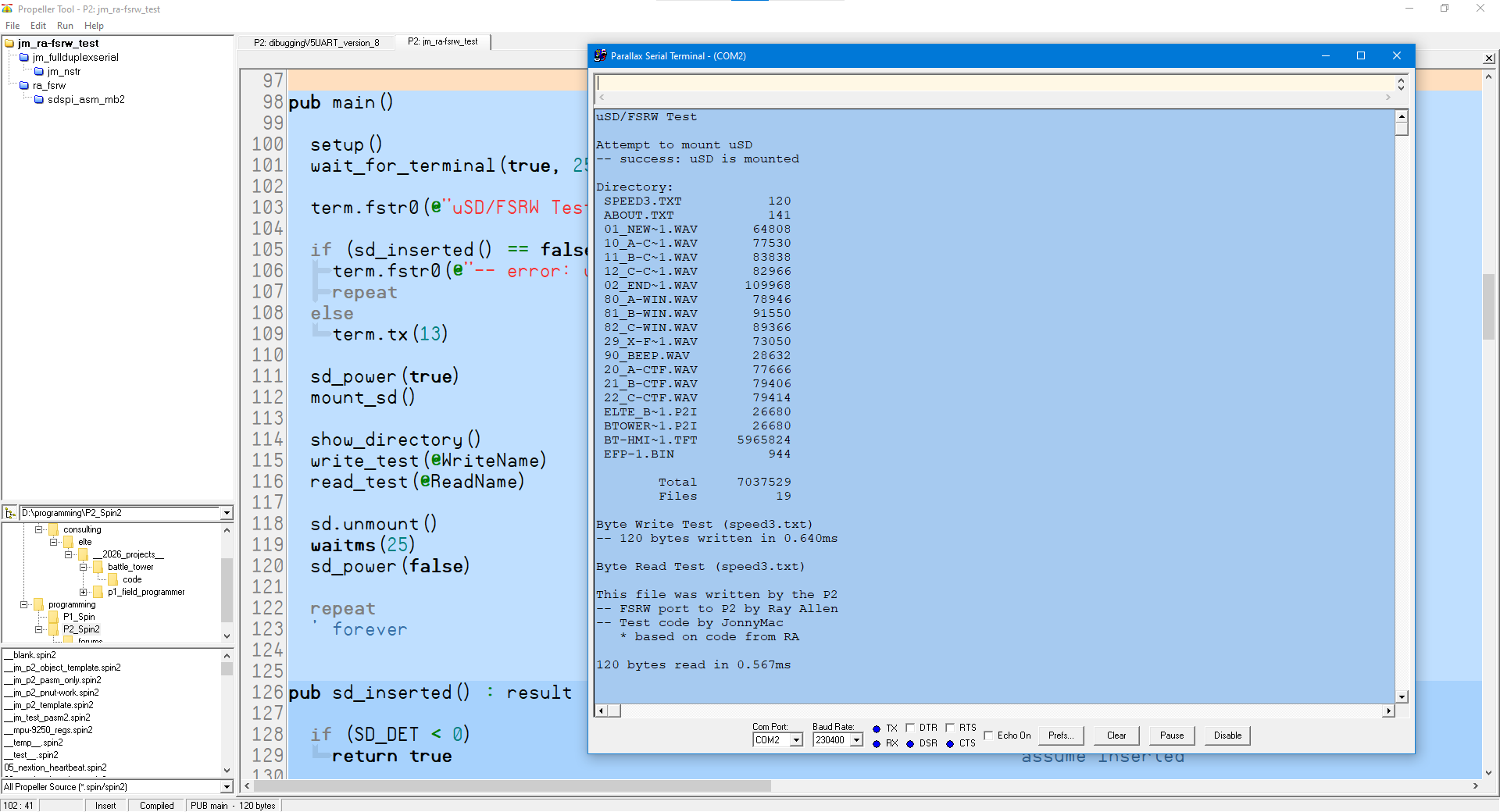

    so I’m currently unable to switch IDEs.
    You're at a very big disadvantage using Propeller Tool -- Parallax stopped development on it long ago and its version of the P2 compiler is very old. When you can, switch to Spin Tools IDE which is compatible with the latest version of the PNut (P2) compiler, but in an environment that looks-and-feels like a nicer version of Propeller Tool. It will also allow you to link to external compilers like PNut and FlexProp.
    I use a Propeller Tool compatible version of FSRW that Ray and others updated to the P2. My need is raw speed, and other uSD driver are slower than the P2 update of FSWR (I don't need long file names or folders). I made a very small touch-up to the mount() method because the return value is being used to note the card type; I had to reset the return value back to 0 after this test to get the proper result from a good mount..
    The attached demo looks like this in Propeller Tool:
    And like this in Spin Tools:
    Since timing seems to be important, there are lots of little things you can do to claw back a few microseconds here and there. For example, these routines:
