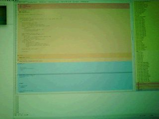

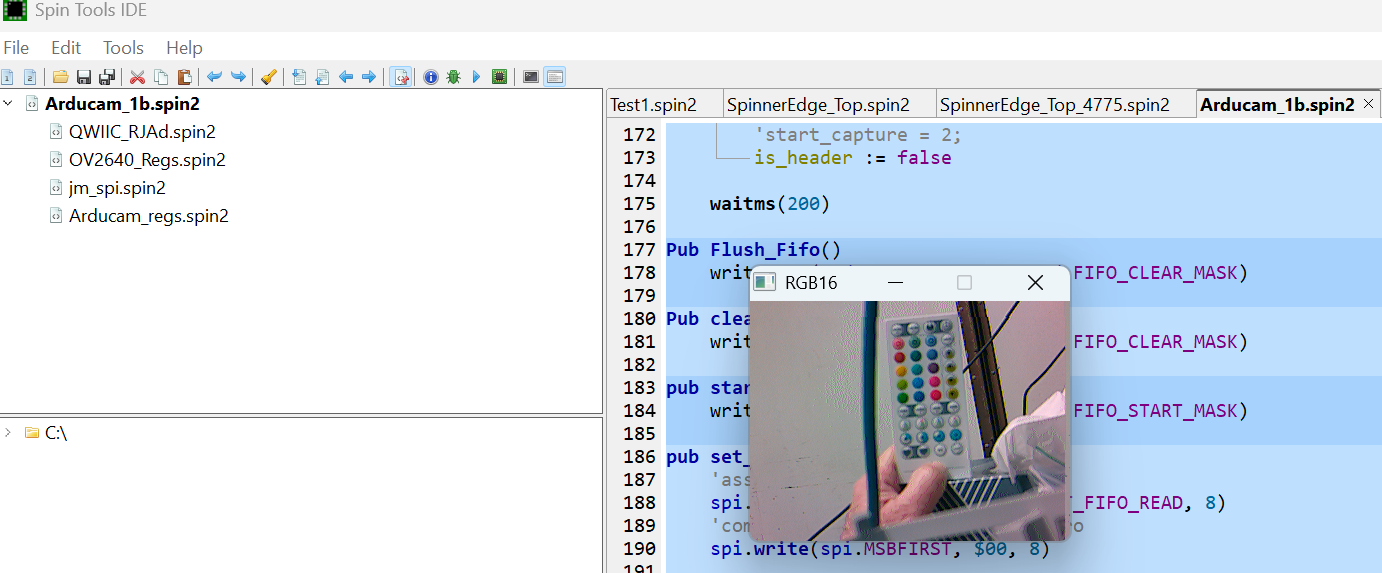

Been translating some Arduino code to get Arducam working on P2 in Spin2.
Think have the QVGA RGB16 preview going now.
Used debug to see the result, that is nice!
