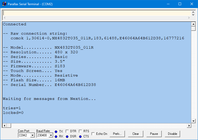

    Here you go. This simple demo shows the specifics of the connected display, and if it sends text strings the way I do in my projects, will display them onscreen.
    I found a display that had an Escape Room timer running it it. There's not a lot of interaction, but the display does report when the user enters a bad code (shows the number of current tries) and when successful, reports locked as 0.
    Here's the output on my system.
    You'll need to set BR_HMI, TX_HMI, and RX_HMI constants for your display and connections.

    Wonder if one really needs RX if just want to show things and not get feedback…
    You could do that, but not with my object because it verifies that the Nextion is connected. Underneath my Nextion object is a trim serial object (jm_xfds.spin2) that can be used in transmit-only mode (set the RX pin to -1). That said, with P2 smart pins one could make a cogless object that just sends bytes and strings for display-only control. I routinely run my Nextion displays at 230400 baud, and even switch to 921600 when uploading a new TFT file. As most display strings would be short, I think a cogless display-only object would work fine.
