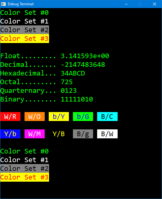

    A while back Ray Allen expressed an interest in a DEBUG Terminal object and I needed one for a work project. It took a while to get PNut and Spin Tools synced, but now they are and the DEBUG Terminal window allows arbiraty color changes (as well as the original four sets) , which is something I wanted for my project. The demo looks like this.
    Since it's a P2 DEBUG window the app can call the window directly, but I think you'll find most output needs covered with the object methods.
