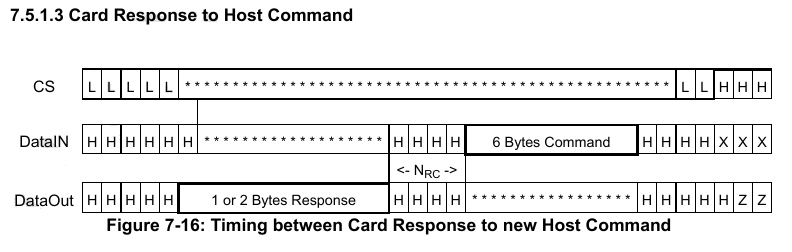

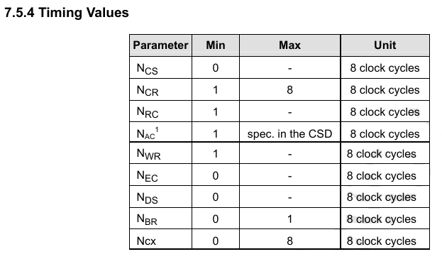

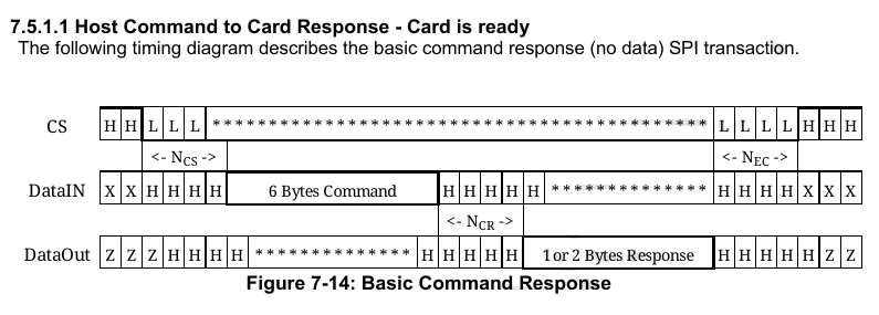

    I've done more reading of the spec and found the answer. Turns out there is a minimum of 1 byte gap and these cards are following the spec correctly. The timing diagram I posted above should have but doesn't specify the timing of relevance, Nrc. It is listed in the table but has it's own separate diagram:
    Sorry for not just uploading the PDF itself. It's one I found in a Web search that is not the free edition.
  • evanhevanh Posts: 17,308

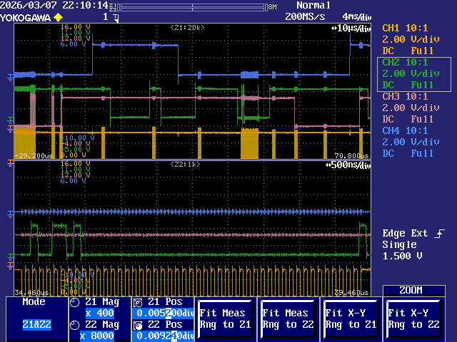

    So adding a padding $FF byte at the end of the prior sequence, before rasing CS instead of after lowering CS, should also do the job.
    edited 2026-03-08 12:50
    I suppose, to be fair, it's not clear, from the diagram at least, if Nrc holds true after CS rises. CS high could be considered a reset so then my previous interpretation would hold. It's a little fuzzy so not surprising different manufacturers might have interpreted different ways.
    Either way, it's clear the driver has to make the allowance for Nrc holding true irrespective of CS. And the best solution is to, like Flexspin's sdmm.c driver, combine it with the busy check.

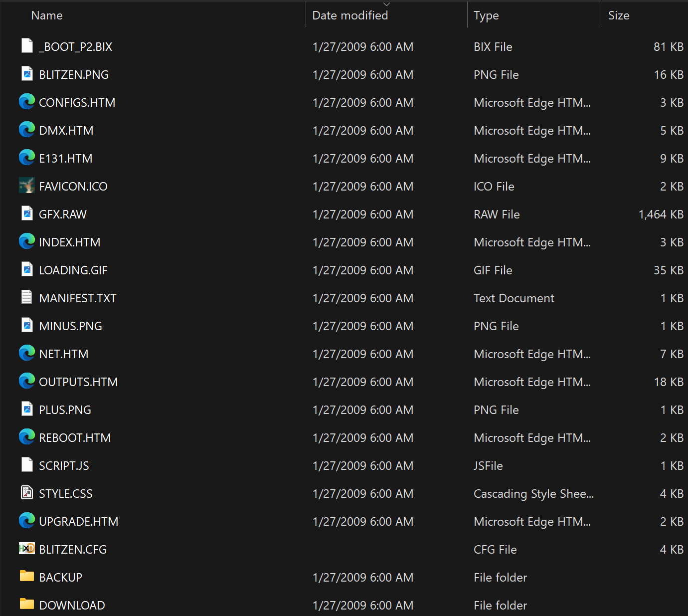

    @"Stephen Moraco" Claude swapped out FSRW FAT32.spin2 with your driver for me easy peasy. I have not done a full regression test, but the config reads from the SD card and the web pages are served up. Simply amazing! I had to upload the most recent version of my code and a zip of your driver. I used this prompt:
    Would you be capable of changing the filesystem object ( FS ) that the Blitzen 24 uses to access the SD card to use IronSheeps's SD card driver located at https://github.com/ironsheep/P2-uSD-FAT32-FS
    Below is the log of the whole process. Simply amazing!
    https://claude.ai/share/9e4eab98-9b67-4f30-84f6-13e97af39707
    @Rayman this might be the easiest way to integrate the new driver into whatever code you were looking at changing.

    I validated the following:
    • The uSD filesystem properly reads files.
    • The uSD filesystem properly deletes files.
    • The uSD filesystem properly writes files.
    • The uSD filesystem properly creates directories.
    • The uSD filesystem properly dismounts the card, leaving it in a state where the P2 can boot from the same SD card. Additionally, a couple of bugs that exist in FAT32.spin2 that do not properly update filesize and leave the filesystem in an inconsistent state when unexpectedly powered off do not occur with this object.
    • Windows does not want to perform a FSCK on the SD card after it is removed from the P2 when using this object.
    • My code transverses directories and the uSD filesystem properly transverses those directories.
    • File and Directory creations and modification dates are valid and have a date of January 27, 2009 06:00 AM (At least that is what is displayed on my machine in CDT)
    • The uSD filesystem appears to have slightly more performance.
    Blitzen 24 was converted to this object via CLaude without any code tweeking required by me. It just works and it works better than FAT32.spin2.
    Additional observation: Often with FAT32.spin I would get MD5 checksum errors of the files I download from Azure blob storage. I compare the MD5 of what Azure tells me with what was written to the SD card. I have not received a MD5 mismatch while testing.
    Well done @"Stephen Moraco" !!
