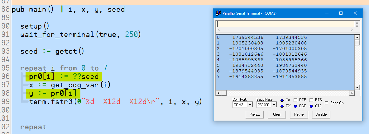

    There are eight longs in the cog called pr0..pr7 that are intended for Spin-to-cog communications, and are not used by the interpreter.
    If you can live with 8 longs, you're good to go with something like this.

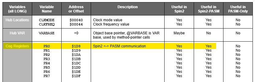

    The Spin2 docs have some suggestions:
    Read and write the following cog register and LUT areas:
    $000..$11F, which may contain PASM code and/or data which you previously loaded.
    $1D8..$1DF, which are general-purpose registers, named PR0..PR7, available to both PASM and Spin2 code.
    $1E0..$1EF, which are available for scratchpad use, but will likely be rewritten when Spin2 resumes.
    $1F0..$1FF, which include IJMP3, IRET3, IJMP2, IRET2, IJMP1, IRET1, PA, PB, PTRA, PTRB, DIRA, DIRB, OUTA, OUTB, INA, and INB.
    LUT $000..$00F, which are available for any use and ideal for streamer modes which use the LUT.
    Avoid writing to registers $120..$1D7 and LUT RAM $010..$1FF, since the Spin2 interpreter occupies these areas. You can look in "Spin2_interpreter.spin2" to see the interpreter code.
    See the "CALLING PASM FROM SPIN2" section...

    You can copy a hub array to the PRx regs with setregs().
      setregs(@array, $1D8, 8)
    You can copy all of the PRx registers to the hub with getregs().
      getregs(@array, $1D8, 8)

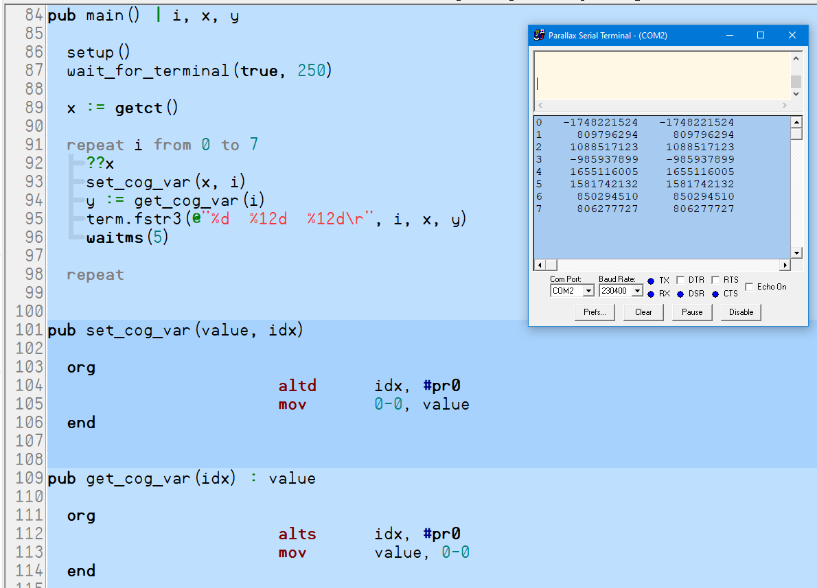

    It just dawned on me that Spin and PASM understand pr0..pr7 so there is no need for inline PASM to set or get one of those registers -- using Spin's inherent indexing does the trick without a special method.
