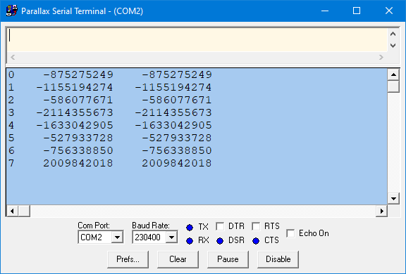

    The PASM2 gurus will jump in if I'm wrong, but this seems to work. Note, though, that inline PASM code is transient so this is impractical -- unless the need for the array is transient, too.
    pub main() | x, y, z
      setup()
      wait_for_terminal(true)
      y := getct()
      repeat x from 0 to 7
        y := ??y
        z := array_test(y, x)
        term.fstr3(@"%d  %12d  %12d\r", x, y, z)
        waitms(50)
    pub array_test(value, index) : result
      org
                            ' write value to array
                            altd      index, #longarray
                            mov       0-0, value
                            ' read value from array
                            alts      index, #longarray
                            mov       result, 0-0
    .done                   ret
    longarray               long    0[8]
      end
