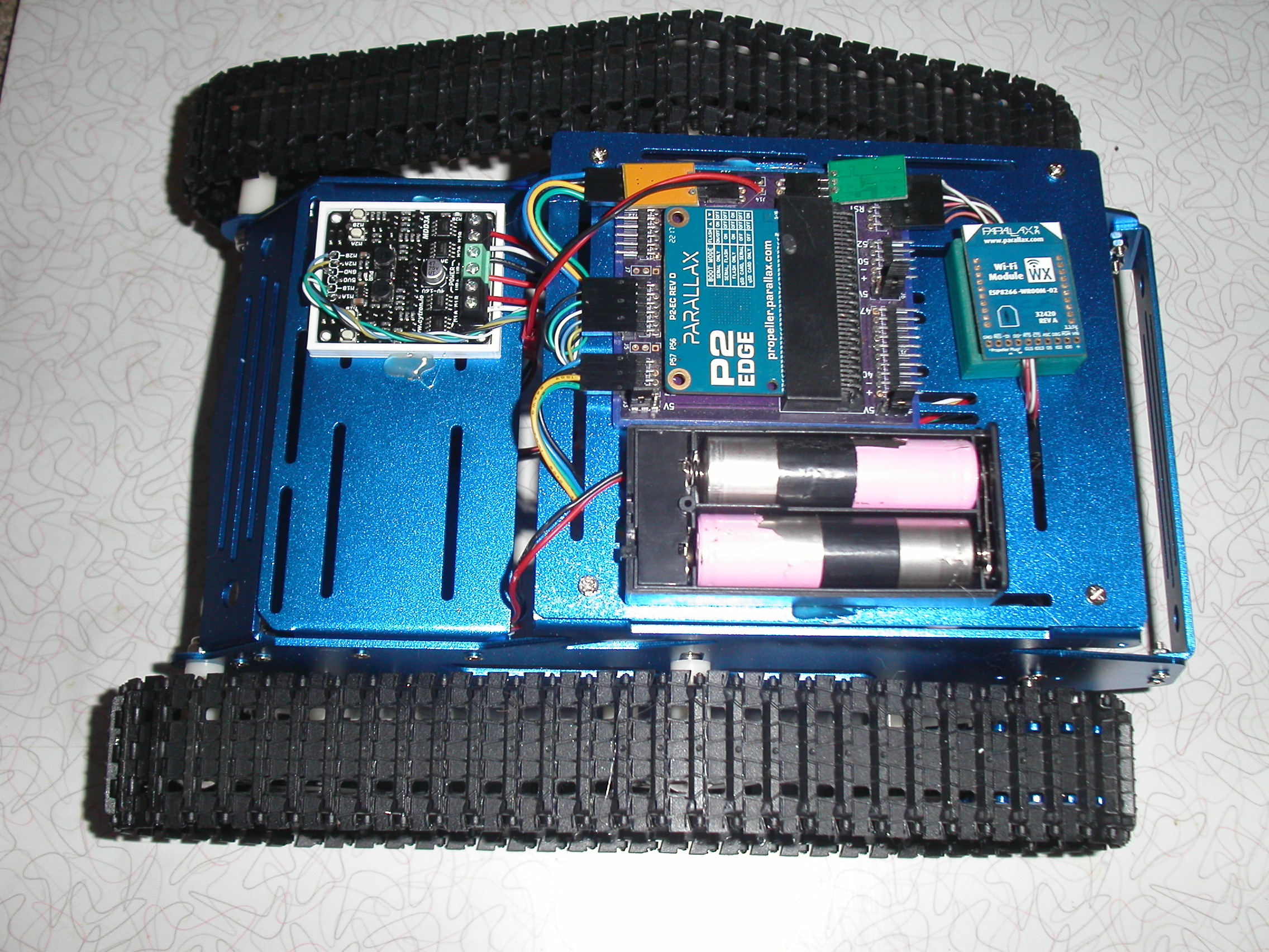

After getting the unit I first tested the motors with a MDD3A board I had laying around. This inexpensive board works very nicely.
I could have used the Parallax BLDC board I also had laying around but it was not plug and play setup for my P2 board.
The motors came with Quadrature encoders so setup a smart pin to record the motor turns was a snap.
_pinstart(H1A, P_PLUS1_B | P_QUADRATURE, 0, 0);
The motor came with a cable with both ends attached so I removed the one end and cut off the quadrature pins and installed new pins to fit in Harwin connector. The other two were inserted in the motor drive screws.

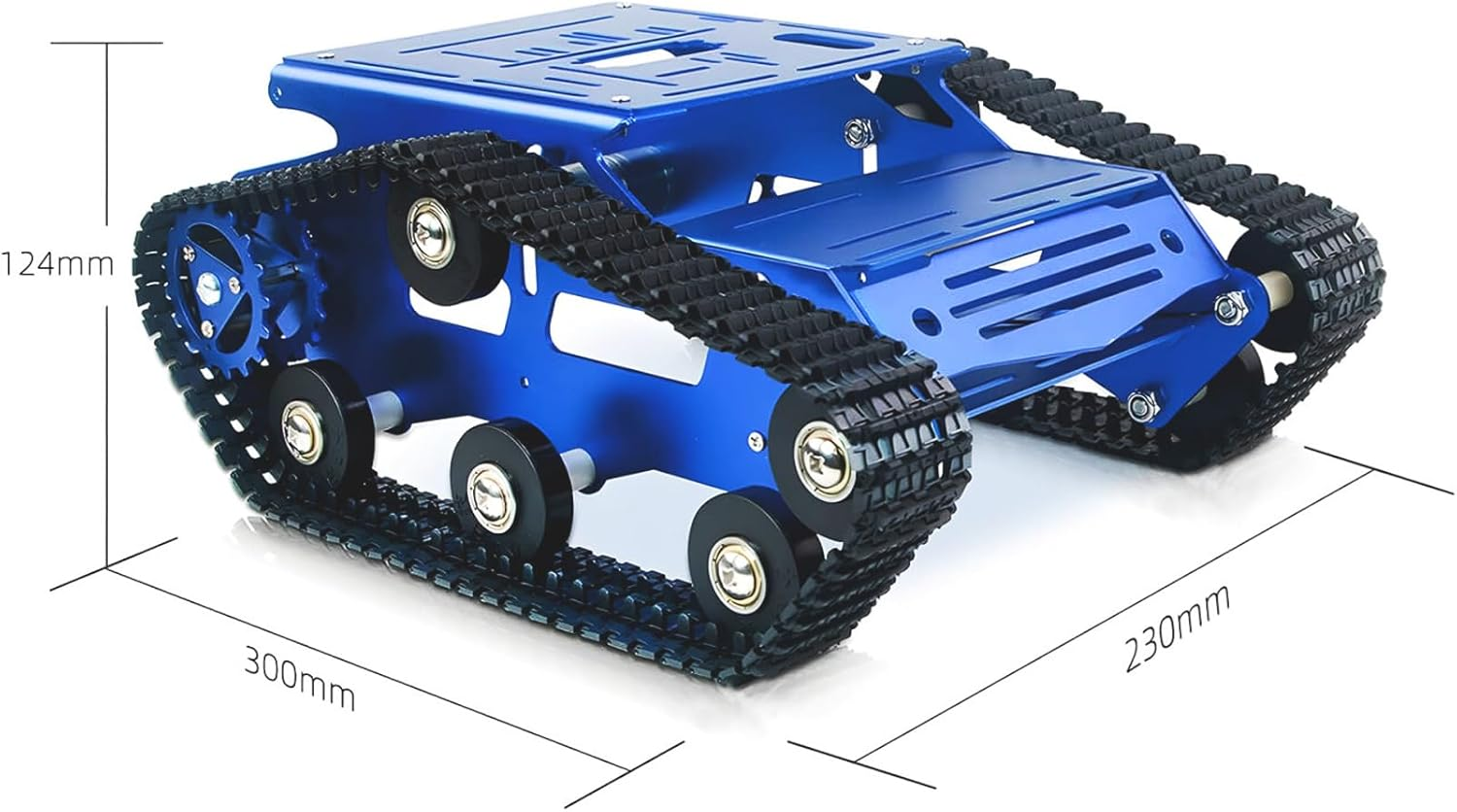

Assembling the tank was simple enough but at last a problem arose. One of the tracks was too small to fit and the extra track they supplied didn't have enough pins to make it work. I contacted them and they should be fixing my track issue. I had enough track to just make it fit on the one side.
I found a copy of my LOGO Program so I could make the tank move about the floor under command.
Using the WX module I can bring it online and give it instructions to have it move about the floor.
I like this tank because it's big enough to mount thinks on it. Now where is that huskylens...
