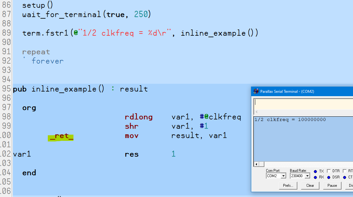

I never see this:
PUB DoNothingExample(V1,V2,V3):V4,V5|V6
org
                rdlong var1,#@clkfreq
                shl     var1,#1
var1            res 1
end
And indeed, some code where I tried it is acting up.. Is this not allowed?
Is there a way to get beyond the variable limit for inline code (6, I think?)
  • evanhevanh Posts: 17,242
    Without an explicit RET added after the SHL, you're attempting to execute whatever is placed in var1.
  • I just did this with an inline FFT. Both res and long are fine. You will need to "ret" before the cog tries to run whatever is in those variables as instructions.
    There are also named registers pr0 through pr7 that may be used by inline assembly.
  • I knew that... Hate when that happens
    THANKS!

  • JonnyMacJonnyMac Posts: 9,824
    edited 2026-02-17 16:37
    While I was answering an email and editing the demo, everyone answered -- but here it is. I have have used res inside inline PASM a few times.

  • The _RET_ prefix and the RET instruction do the same thing (return from the hardware stack).
    There are only a few differences / things to note:
    • If return target is in cog/lut ,The RET instruction takes 4 cycles. The prefix version takes only 2 cycles.
    • The RET instruction can take a WCZ modifier to restore the carry/zero flag values from the stack (stored in bit 31/30)
    • The RET instruction can itself have a conditional prefix
    • The _RET_ prefix can not be used on instructions like PUSH or POP that themselves use the stack
    • The _RET_ prefix on a branching instruction does nothing if the branch is taken. You can use something like _RET_ DJNZ for a loop and it will automatically return after the last iteration.
