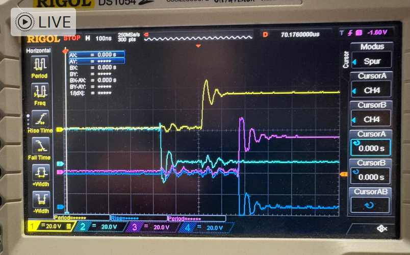

I'm running a P2 at 200 MHz. I'm writing Bit 0 to 7 using OUTA.
I observe, that not all bits switch at the same time.
Something, I didn't expect. Is it a bug or a feature?
I did no further tests yet, as it came as a surprise. But I create a sync-pulse
if_z Or outA, #%1000_0000 'Trigger setzen
AND OutBits, #%0011_1111 ' Reset Trigger
mov outA, OutBits
The sync pulse is as short, as it should be.
I think, I could have done it ANDing the bits directly, but didn't care then
a) post your code. It certainly shouldn't take on the order of microseconds(?) to switch the pins
b) generally there is some nanosecond-level difference in propagation delay between pins. You can use the P_SYNC_IO mode to reduce the difference, but now everything is delayed by a full clock cycle.

Hmm, that code looks alright - are you sure you are measuring it right? Or am I mis-reading the scope claiming a 70us view duration?

The next time, I intend to expose my stupidity, I'll impose tariffs! At least, I know how to attach a scope, I'll now exercise to attach it to the right pins....
