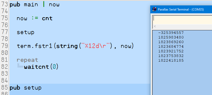

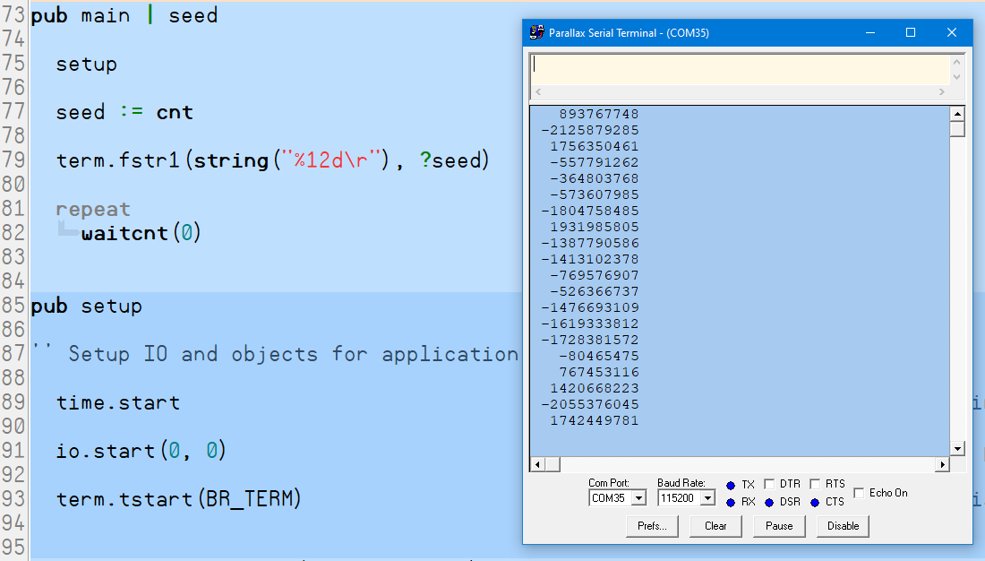

    Just to put this to bed, here's a ridiculously simple program that demonstrates the cnt register can be used and the random seed. I downloaded this program to EE (use F11) and pressed the reset button several times -- notice how the value is DIFFERENT every time.
    Final test: I captured the cnt register BEFORE doing anything else. Instead of pressing reset, I unplugged the FLiP module and then plugged it back in. Yes, the cnt register values (other than the first) are close, but they are NOT the same. Feeding this in to the PRNG will give you a different sequence each time.
