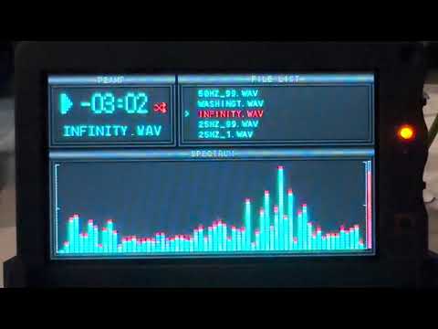

I would like to share with you a small project I worked on during Xmas holidays.
It's a simple wav player (Winamp Style) running on the P2 Thing + LCD 4.3" (480x272) display with a nice FFT real-time spectrum analyzer.
It includes:
  • Paletted display driver to save hub memory (130 KB vs 390 KB with 256 colors 8 bit palette)
  • Different Fonts directly loaded from simple bitmap images
  • Wav player based on @Rayman code with some additions (like interactive volume control etc ..)
  • FFT for spectrum analyzer including windowing (hanning, hammin, flat-top, rectangular etc ..) and all related calculations for graphical representation of the spectrum.
I implemented my own FFT working on 16 bit signed samples (to save some memory) on a 4096 samples window updated every 1024 samples (audio @ 44.1 kHz 16 bit stereo).
4096 samples window at 44.1 kHz allows a good resolution at lower frequencies (approx 11 Hz).
This works on 4 cogs: main program, FFT, wav player and LCD.
Credits @Rayman for the player and LCD driver.
I can share details if interested.

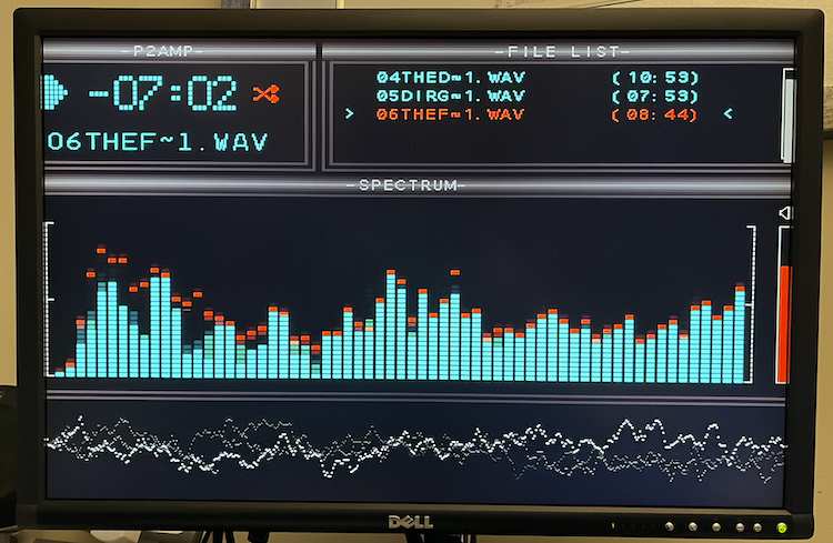

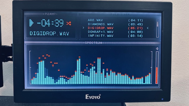

    Thanks @rogloh, your demo did the job! I was able to port the player to VGA display @ 1024 x 600 and it looks pretty cool!
    Also added the usb keyboard to control the player in case someone wants to try this on a different hardware.
    Pin definitions for different hardware can be changed at the beginning of main.spin2 (VGA, USB, AUDIO, SD).
    @Wuerfel_21 doesn't need to change them! :smile:
    Arrows UP/DOWN select song, ENTER play, SPACE bar pause/resume, PageUP / PageDOWN volume.
    Songs must be placed in the SD card root, WAV 44100 kHz 16 bit.
    Enjoy your favourite songs !!

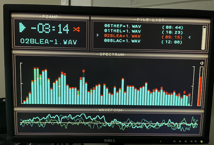

    @MXX I hacked up a quick proof of concept for an oscilloscope and added to your demo running 1024x768 output. It's probably better to dedicate a separate COG and get some other effects running. My simple dots are not as nice as real lines etc and there might be a nice way to setup triggering to try to align the waveforms more like a scope does rather than free run.
    Note if you want to run this yourself some VGA IO pins are different and won't match yours. Also the remaining scan lines are actually 84 = (768-600)/2 when line doubled so you'd probably have space to name the subwindow like you do above it and still keep a 64 pixel vertical range.
    EDIT: Added waveform view at bottom of screen to demo.
