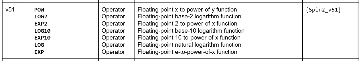

    From the latest Spin2 docs

    There is a LOG2 operator in that list. Does that match QLOG?
  • ersmithersmith Posts: 6,280
    @Rayman :
    QLOG is a fixed point logarithm using the cordic. Since it's an interface to P2 hardware it's not available on P1 (similarly for other cordic operations, like ROTXY and POLXY). However, the floating point LOG operators (LOG, LOG2, LOG10) are available on P1 in FlexSpin. On P1 they use the built in log tables in the ROM, so they're a little less accurate than the P2 versions. Ditto for QEXP vs EXP, EXP2, EXP10.
