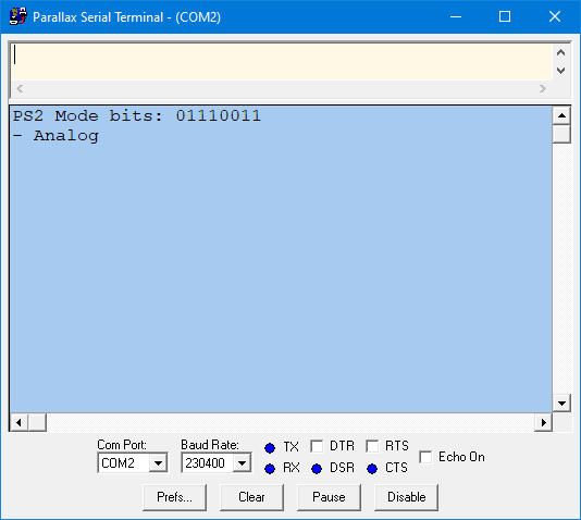

The Spin Tools terminal has a PST mode, but does behave a bit differently (this turns our to be good). Let's start with the OG: Parallax Serial Terminal
Note that at the top of the window, just under the title bar, there is an input field. In PST this is always present, and PST always takes a keypress and immediately sends it to the Propeller.

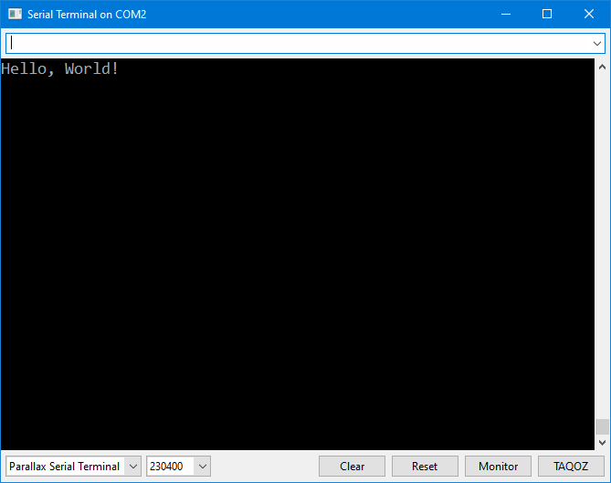

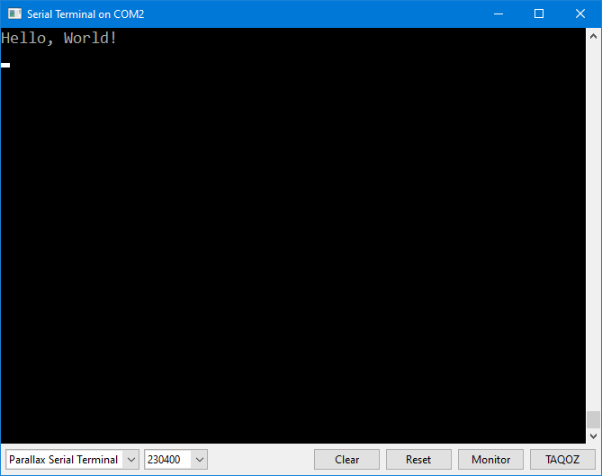

The terminal in Spin Tools has two modes: character input (like PST) and line input (the Schmarschmino terminal has this). Here is the Spin Tools terminal in CHARACTER mode.
And here it is in LINE mode.
The differences are a little subtle, but there:
  • Character input has a flashing cursor in the window, and no input field
  • Line input has an input field (under the title) and the cursor is in the field, not on screen
When I told you about the situation I was facing I had been fooled by being in LINE mode because 20 years of using PST had conditioned me into thinking there should be an input box at the top of the terminal window. This was my mistake.
