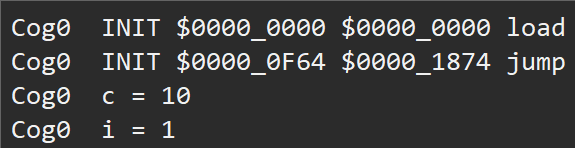

I am guessing that nested reps are a no-no?
{Spin2_v52}
CON ' Constants
    _CLKFREQ = 160_000_000
PUB start() | i, c
org
    rep @.outerloop, #10
     rep @.innerloop, #10
      add c, #1
 .innerloop
     add i, #1
.outerloop
end
debug(udec(c))
debug(udec(i))
