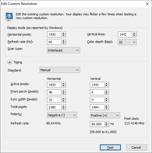

I am typing this on a 1920x1442i @ 70Hz display forming the left side of my Windows Desktop, and another display running 1600x1442i @70Hz for the right side. Both could be running the 1920, it's just the display on the right doesn't have quite the fine detail needed to make 1920 great. The display will do it, but there is fatigue. That all comes down to a couple things: One is the phosphor pitch and the other is how well tuned the circuit inside the CRT is. I have found quite a few displays are not focused properly, and I found that out when I got one that was!! (The one I am typing this on BTW)
Why Interlaced video?
The most basic reason is an interlaced signal makes very high resolutions possible on displays that normally function at 1024x768 or maybe 1280x1024. The displays I have done this with basically top out at those resolutions. One can get higher ones to sync, but it's obvious the display is working hard to run near it's maximums too.
The interlaced signal centers the signal sweep rates much closer to the middle of the range and seem to display nicely without too much fiddling with the screen size and position controls.
After running one for a while, I find higher resolution interlace mostly gets out of the way and I don't see it, except for the occasional fine line or pattern hitting the signal grid exactly. That flicker is seen easily, and it's at half the overall refresh rate being supplied too. And while a 70Hz display = 35Hz flicker and that is a lot better than the usual 50/60Hz and 25/30Hz flicker, the fact is for some people the flicker is not OK. I, for the most part, am one of those people and am surprised at my overall low reaction to it happening at higher resolutions. I've not really experienced this before.

I find you need a program that can edit the EDID info Windows either collects from your CRT display, or it supplies some generic info. That body of information is where display resolutions, whether they are native or recommended, and refresh rates are all stored.
You can get such a program here: https://customresolutionutility.net/

Finally, you need to know your display timing limits and have some idea on how to arrive at reasonable timing.
What I did was use the existing resolutions as a guide. The basic idea is to convert one of those to be interlaced so the whole process is vetted. You know before you start tweaking that an interlaced display is possible.
The article above gives an X Window System mode line for 1024x768 display interlaced.
You may have luck with the vendor tools too: nVidia custom resolutions tools on older driver sets will create interlaced timings for you and you can test them with a few second fall back if it does not work out.
I also prefer to setup two displays so I have one working and can be testing the other one.
Now that I have the timings I want, it is pretty easy to load CRU onto a machine, hook the CRT up, and then paste those timings into the CRT display entry, restart graphics drivers and see whether it works.
For now, I'm attaching display timing data for a Princeton Ultra 72 display that runs this resolution amazingly well.
Later, this evening when I have some time, I will also post a how to with more detail for anyone intereted.
In the zip file attached, you will find a test card that has patterns that will show artifact colors and or flicker on some displays depending on their dot pitch and phosphor color pattern. That test card shows vivid artifact colors on my Plasma TV, for example. They don't line up nice and neat like 8 bit computer artifacts to, but they are still a thing apparently. You can use this, viewed at 100 percent in your favorite viewer to verify you have an actual interlaced display and not some goofy thing mapped to a lower resolution.
The rest of the zip files contain items you can import, or run to set the resolutions you want. And you can see the displays I tried.
The picture below is from the nVidia custom resolution tool.
The other picture is the desktop from this machine running two CRT displays.
