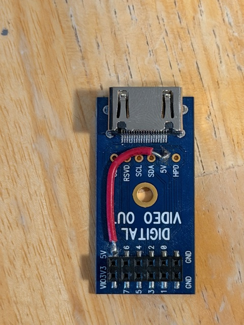

Hi,
I have a 5" round waveshare hdmi display and I have the P2 running the the spiral hdmi demo, it works on a normal hdmi display but doesn't work on the waveshare. I know the display works as i plugged it into RPI. Any thoughts on why the waveshare won't display it?
  • Possible issues:
    • Display does not like the pin drive mode used (try replacing the line that says wrpin ##%001001<<8,#7<<6 + hdmi_base 'set 1k-ohm drive on HDMI pins with wrpin ##P_REPOSITORY|P_OE|P_LOW_FAST|P_HIGH_1K5|P_SYNC_IO, #hdmi_base addpins 7
    • Specialty display wants special resolutions (try this on a PC or something - does it actually take 640x480 modes?)
    • Some sort of exciting protocol incompatibility (not sure if chip's example is 100% spec compliant)

  • RaymanRayman Posts: 16,312
    Also it might be the 5v signal. Some displays seem to need it. The parallax adapter needs a jumper wire added to provide that…
  • Oh the 5V pin, that's the No. 1 thing to check actually. Some sinks will not turn on without that. Simple electrical fix.
    Here's an example of the jumper wire... Could also be a resistor instead of a jumper, like 1k or so...

  • Brian_BBrian_B Posts: 844
    edited 2026-01-01 18:04
    1080x1080 , but after i tried It with the 5 volt jumper wire it won't even work on the RPI.
  • VonSzarvasVonSzarvas Posts: 3,634
    edited 2026-01-05 22:46
    The newer rev of the hdmi addon has pads labelled near the hdmi socket for adding a 1k resistor or jumper/shunt.
    BUT… first be sure that your breakout board is outputting 5V at the accessory headers (and not a higher voltage).
    That usually means the breakout is powered by 5V (and not a higher voltage). And also that the breakout board has the 5V outputs enabled.
    To verify, measure the 5V output pin on the breakout board header before attaching the addon.
