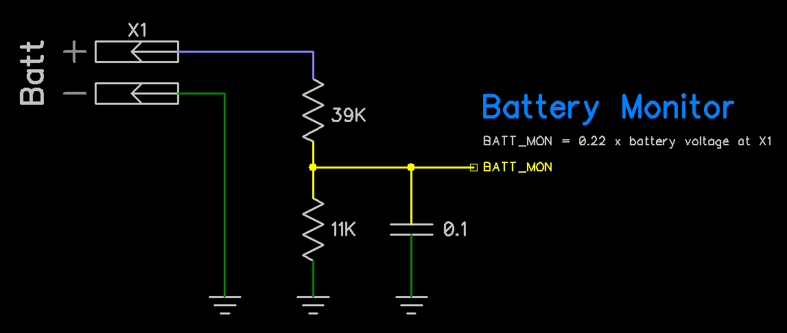

  • Remember that the P2 IOs are 3.3v so you need to keep your ADC input to that. In a recent project I needed to monitor the state of a 12V battery that feeds an offboard 5v regulator. I added a 12v battery input to the PCB and with a voltage divider that will allow me to safely monitor up to 15v.
    No matter what language you use, you'll need to activate the smart pin ADC mode to read an analog voltage. I've attached my Spin2 object for simple ADC measurements. It includes scaling factors to convert the ADC reading to match your situation. In my case, I can do this (for my circuit designed for 0-15v).
      adc.startx(BATT_MON, 0, 15_000)
    After this I can use adc.read() to get the battery voltage in millivolts.

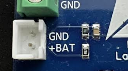

  • I need some serious help with this one. Parallax sells the mikroBus boards, so I went to the mikrobus site, and found a board, BATT-MON Click. Not sure what thing does exactly, but it deals with 3.3v and 5v inputs. I have never worked with any mikrobus products. I do not know if this would do what I want, or how I would go about working with this thing. If this thing plugs into a P2, is there spin2 programs that can deal with this. As for the input voltage, I have some little boards that takes in as much as 25V and knocks it down to 5V. I wonder if that would work with the P2 board, using the BAT-MON Click board. Thanks in advance if anybody decides to give a hand.
    This board would reduce the complication some what, I think, and make a less messy situation with the connections to the P2.

  • It looks like you are suggesting I make my own prototype board. Actually I am trying stay away from that, I am dealing with wet amd. I do not want to screw up too many boards and still not get the thing to work. It is hard for me to make a public admission like that, but I have to except reality.
    Ray
  • evanhevanh Posts: 17,162
    edited 2025-12-21 14:13
    As per Jon's diagram, yes, add two resistors, a capacitor, and terminals to the mini prototype.
    Desoldering and resoldering the same components can be done in the process of getting it right. The mini prototype board is perfect for messing up with. It starts with no electronics and only gains what you add to it. It's easy to plug and unplug to try again. You'd be hard pressed to break anything.
    PS: You only want the two X1 Batt terminals. The other four terminals aren't needed for a simple voltage monitor. And the Prop2 will have its own power pack.
  • I have a question about Jon's diagram, what the heck is 'C2 0.1', does that have some thing to do with the battery monitor hook up. My interpretation is, the diagram is showing the battery side connections. What ends connect to the P2. Does the 'R11 and R12' connect to the ground on the P2 and the does other wire joined with the ground off the battery connect to, lets say, P0 pin.

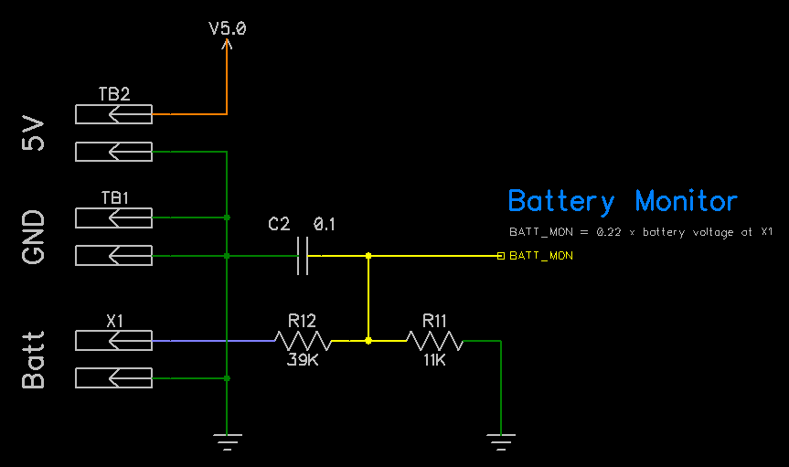

  • JonnyMacJonnyMac Posts: 9,777
    edited 2025-12-21 21:41
    Jumpin' Jiminy on a cracker... I was hoping not to have to redraw this simple schematic, but that time spent is better than getting blamed for a problem I didn't create.
    As you can see, the resistors form a simple voltage divider. The middle of the divider connects to the BATT_MON pin on the P2 (with smart pins, any pin can be an ADC). The capacitor is to help keep the ADC input quiet as the battery also feeds a switching power supply that provides 5V to my board (connected via terminal block in the schematic I first posted).
    By convention we typically specify resistor values in ohms and capacitor values in microfarads. So that is 39K ohms, 11K ohms, and 0.1 microfarads (uF).
    This circuit is really simple, and exists in the real world, that is, I'm not posting theory that haven't actually worked with. Here's that circuit on my board. The battery is connected using a 2-pin JST plug.
    I selected the resistor values to allow the battery input to go up to 15 volts, and I can get those values in 1%. It's just simple math (11 / 50 = 0.22; 0.22 * 15 = 3.3).
    It's a minor noise suppression. Helps remove possible high frequency fuzz. The value is 0.1 uF (100 nF) ceramic capacitor.
    The yellow BATT_MON goes to a Prop2 I/O pin. And yep, all grounds connect to Prop2 ground. No, Prop2 I/O pin P0 is not a ground.

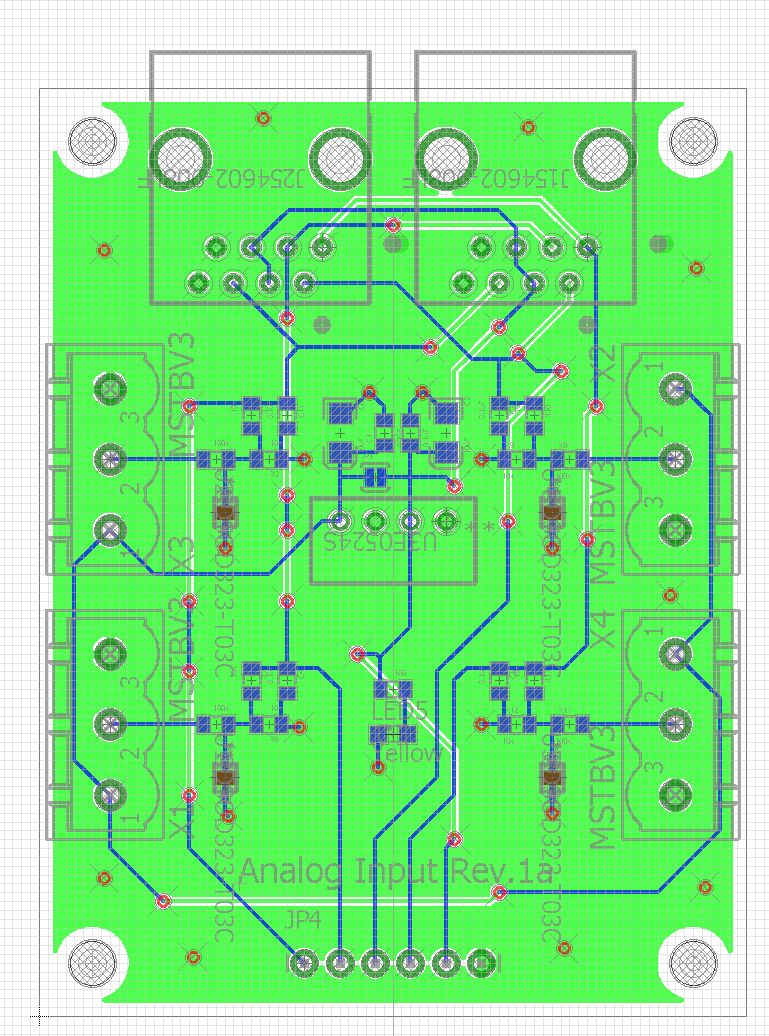

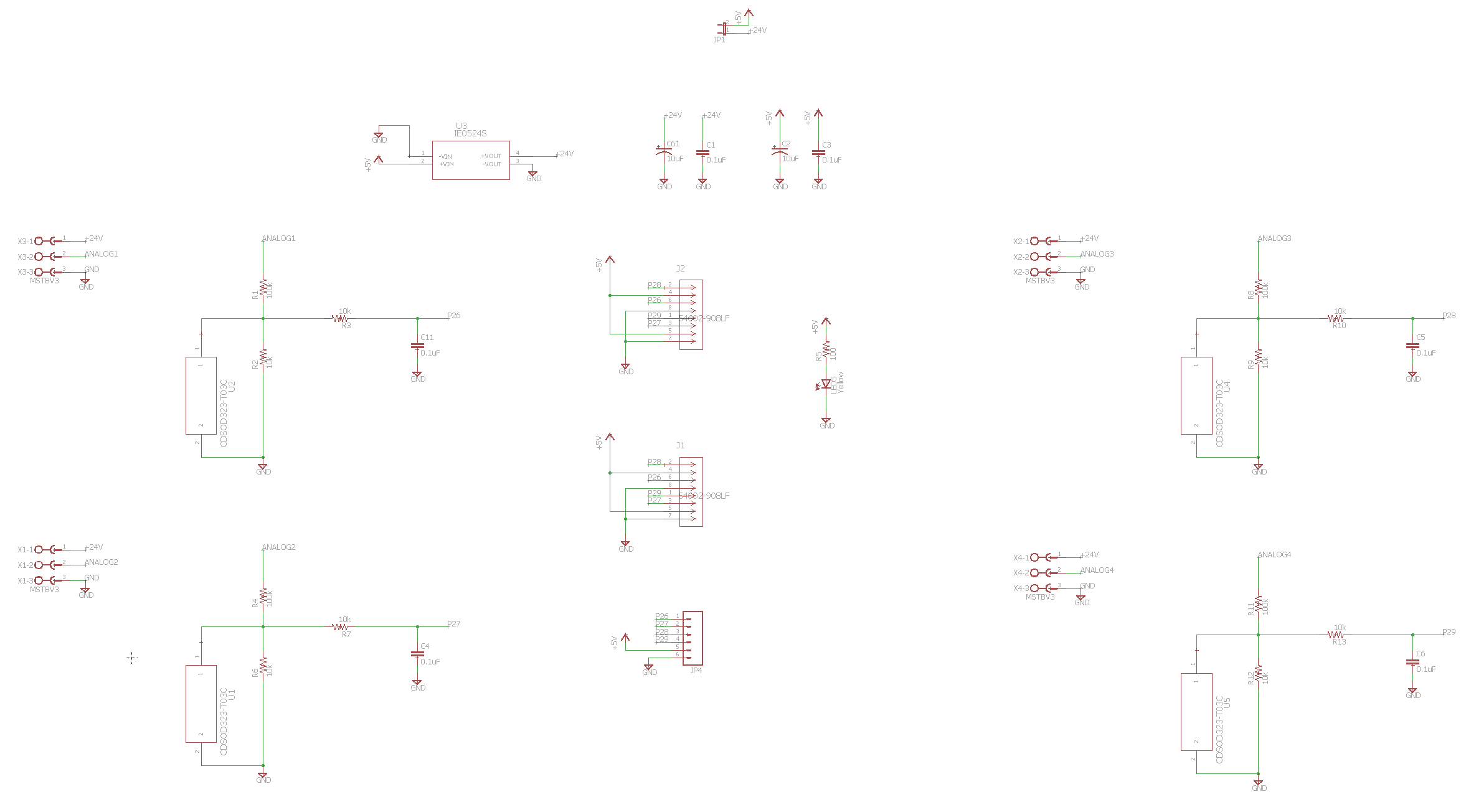

  • RaymanRayman Posts: 16,212
    Here's a similar board for the P2 PLC project.
    Not really a help here...
    Am thinking about making a version that plugs into a standard P2 header and will have 8 analog inputs...
    The CDSOD thing is a TVS diode meant to protect P2 pins for overvoltage.
    The actual values here are subject to change, depending on needs.
    Note this is meant for very slow changing inputs.

  • Lets see if my brain is still working properly.
    3.3/17 = 0.194 ; I am using 17V, as a more accommodating number, considering at some point the charging levels.
    x/y = 0.194
    if x= 10k, you solve for y. I know I have lots of 10K resistors. y, whatever that number turns out to be, I could probably divide that number in two, and get some combination of resistors that I have.
    I hope this not some kind of 'new math', that just came up with LOL.
    edited 2025-12-22 14:29
    if x= 10k, you solve for y...
    10k / 0.197 = 50.76
    50.76K - 10K = 40.76K
    If you want to use your 10K stash, you could put five in series and tap the resistor closet to ground -- but your conversion ratio now becomes 0.2. This would let you measure up to 16.5v (3.3v / 0.2). Otherwise, there are these magical places called Digikey and Mouser (and others) that have a very nice selection of 1% resistors that will allow you -- with a bit of work -- to find a combination that gets you closer to a tap ratio of 0.197.
    If you don't want to do the calculator boogie, this is where one of the AI engines can be helpful.
    -- https://chatgpt.com/share/69495306-d29c-8006-9638-7b97eff4f01f
    -- https://grok.com/share/c2hhcmQtNQ_3fa5c9ce-d28d-4567-a5a8-a73a3b52c413
    ChatGPT recommended 66.5K over 16.2K.
    Grok recommended 82K over 20K.
