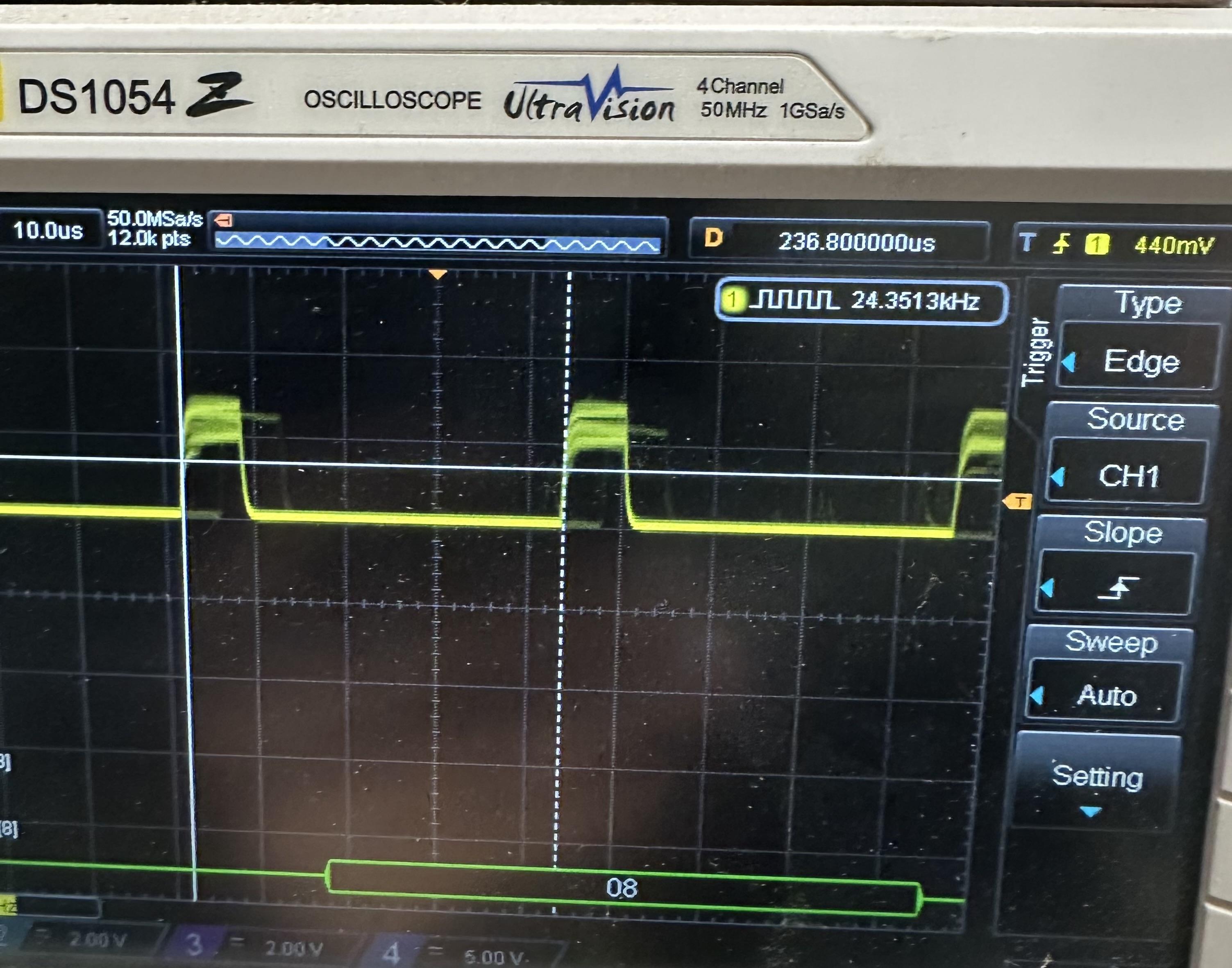

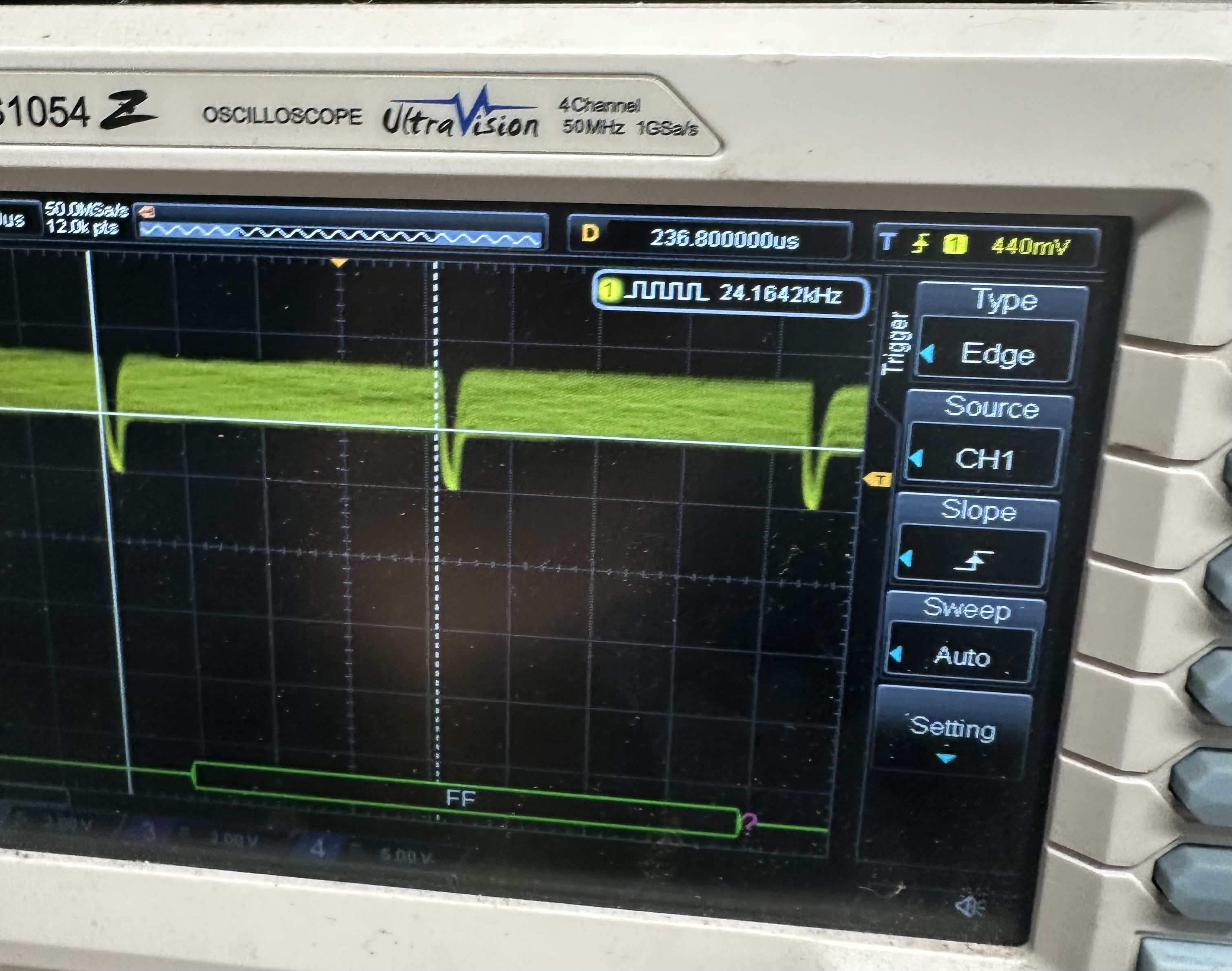

I want to see if there is a way to convert this to P1 so I can get a value ie 20% as the small one looks or 95% on the big one. Any ideas ?
  • T ChapT Chap Posts: 4,260
    edited 2025-12-05 03:19
    Better said, I want to see if I can send this signal direct to the propeller and convert it to a value 0-100. Counter?

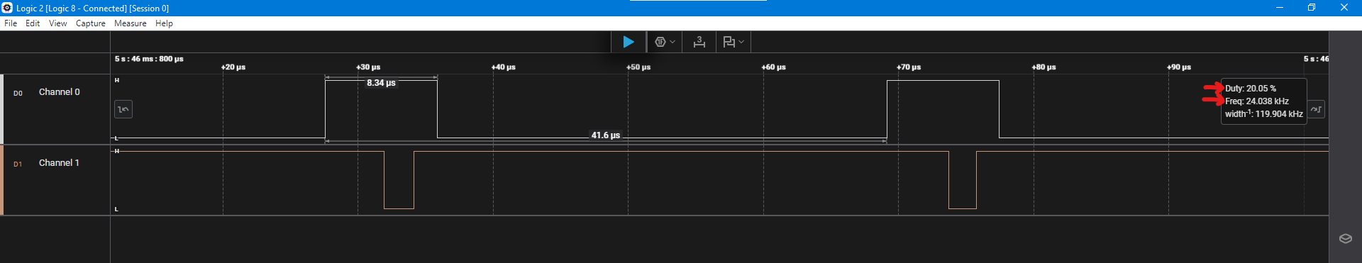

  • The recipe for fixed frequency PWM on the P1 is pretty easy, but it does require a cog. I've used the attached strategy to drive motors and LEDs and other devices that need fixed-frequency PWM.
    Here's the outputs captured on my LA; frequency is set to 24kHz with ch0 set to 20% and ch1 to 95%.
