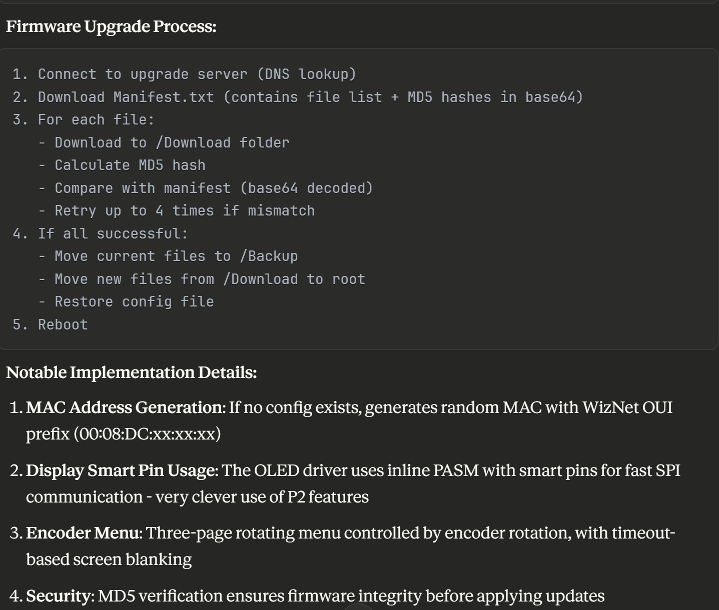

It's understanding of my firmware upgrade process is mostly correct. (The MD5 hash is actually a part of the header returned by Azure Blob Storage, not in the Manifest file.)

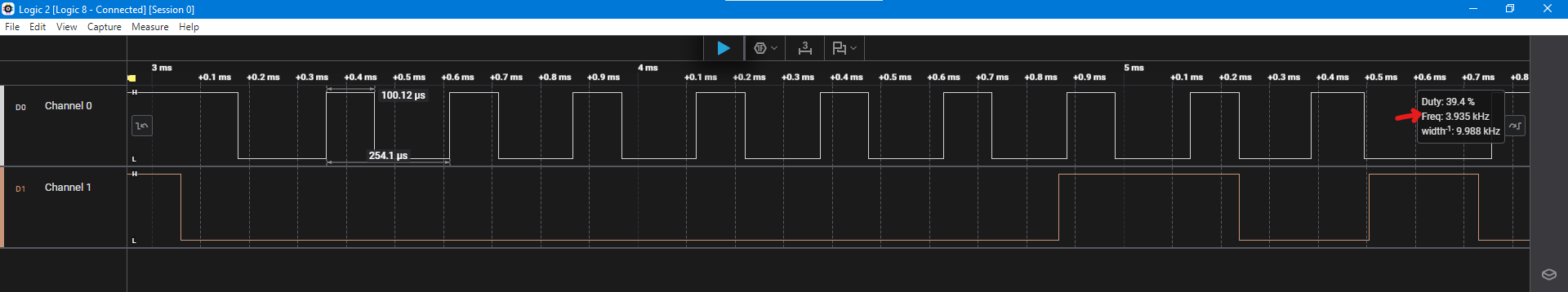

    Playing with a TM1637 module (4-digit 7-segment display) from AliExpress, I tried a TM1637 demo and driver I found on the forum from Mr JonnyMac, (massive thanks to Jon for sharing so much, it's really appreciated) but that didn't work for me, after checking all the pin assignments, wiring, voltages etc., I 'scoped the data line and it looked like it was struggling to charge the line fast enough.
    I asked Claude for a 'slow TM1637 driver' - it gave me the attached which worked first time, (I have since reduced the DELAY_US = 100 'Microseconds delay for bit timing - investigating the issue with my setup/code).

    Did you determine why my driver didn't work for you? I ask because I don't publish stuff that isn't working for me, and that driver was used in a prop for the TV show "For All Mankind." I recently ended up with more of those modules, so I'd like to see how your version differs from mine. Can you post your/Claude's version?

  • I haven't had time to investigate my set-up any further, here's the Claude driver:

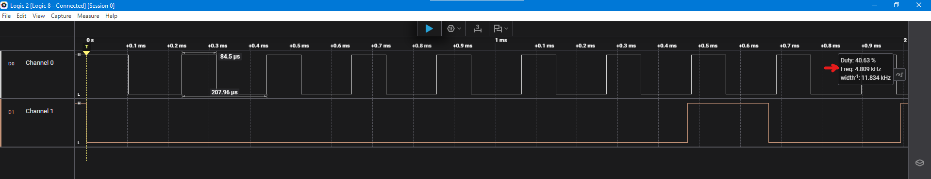

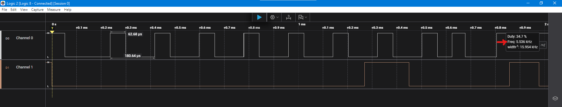

  • Must be a hardware issue with my bench lash-up - display power is +5V, i'm driving the clk and data directly from P1. Attached 'scope traces of the the data line, haven't had time to investigate my set-up much further. Here's the Claude driver.

  • Please attach your code as a file. Simple copy-and-paste into the thread destroys important formatting. Thanks.

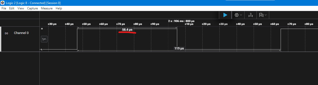

    Just a note. AI "helpers" don't understand the full nature of the Propeller, so they produce code that is expected to be compiled. This isn't something I do with the P1 because I need all the code space I can get; critically-timed code ends up in a cog. For example, When I toggle a pin with your DelayUs() method and run in with the interpreter, what is supposed to be 10us turns into 58us. This doesn't cause any harm in this application, but in other situations it could.
    If the code is run through FlexProp the clock time is about 13us -- certainly closer to what Claude wanted to have.
    I do in fact use Claude from time-to-time, but never to develop full code; I ask for something generic and then tune it to the P1 or P2. Recently I needed a SHA256 hash object for the P2 and used Claude, some prompt tuning, and some manual editing to get an object that works like the P1 code that I inherited from another programmer.

    I will connect a display and try your code this weekend, but a couple things jump out -- I don't know if you're responsible or claude.ai is responsible; if the latter, depending on AI without question might be interfering in your opportunity to learn a language completely. For context, I write code for a laser tag company and in our current P1 product we're always looking for opportunities to shave time and code space.
    This stuck out like a sore thumb:
      if num < 0
        num := 0
      if num > 9999
        num := 9999
    The code is fine, but is slower and uses more code space than if you take advantage of Spin features. You could start with a fix that doesn't check the second if statement when the first if statement is true
      if num < 0
        num := 0
      elseif num > 9999
        num := 9999
    If num is less than zero there is no need to check if it's greater than 9999, so the elseif fixes things. Still, this clamping operation can be wrapped into a single line of code:
      num := 0 #> num <# 9999
    This does the same as the original four lines but it faster and lighter (by 10 bytes in Propeller Tool). I do time testing with this bit of P1 code.
      t := cnt
      ' test code here
      t := cnt-t-368
    At the end of this section t will hold the number of system ticks required to run the code. The 368 constant in the second timing line removes the overhead of those two lines. Here's the result of testing three versions: A is the original, B is with elseif, and C uses #> and <# in one line.

    Your driver has two __ToSeg() methods, when you only need one. If you add a second parameter (desired base), you can use one method like this:

    In the end, you'll decide what works best for you. My suggestion is that AI -- in most cases -- be used for guidance, not finished code.

    The code worked fine with an older display, but not with a recent purchase. It turns out that the TM1637 -- especially when used in open-collector/drain mode (per its design) -- is pretty slow (despite a basic web search claiming a clock speed of 250kHz). I noticed that an Arduino driver for the chip used a 100us delay for the half-bit timing. I tried this and it worked with the new display. I ran that code through FlexProp and it worked just fine.
    In Propeller Tool, the clock rate is about 3.9kHz with my updated driver.
    The same program compiled with FlexProp gives a clock about 4.8kHz.
    I reran your demo and noted your clock rate -- using driven IO pins (that are supposed to be open-collector/drain) -- is about 5.5kHz
    I will post my updated driver in the original thread.
