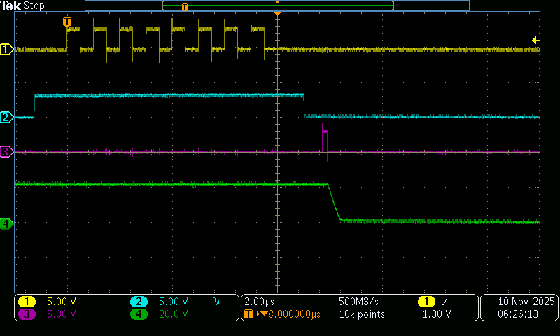

So, I just tried to use jm_ez_spi to operate a TPIC6595 (Shift register with open drain high voltage/current outputs.
I tried slowing things way down (1 khz) and still had some strange going on.
So here is what happens:
In the attached archive I have 'Hardware_00' with 3 possible tests that can be selected in 'Setup()'
Test1 After fiddling around, and then turning ALL outputs on and off, this works. see Test.png where yellow is clock, cyan is data. magenta, is output latch load, green is output. it works

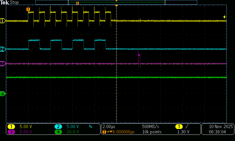

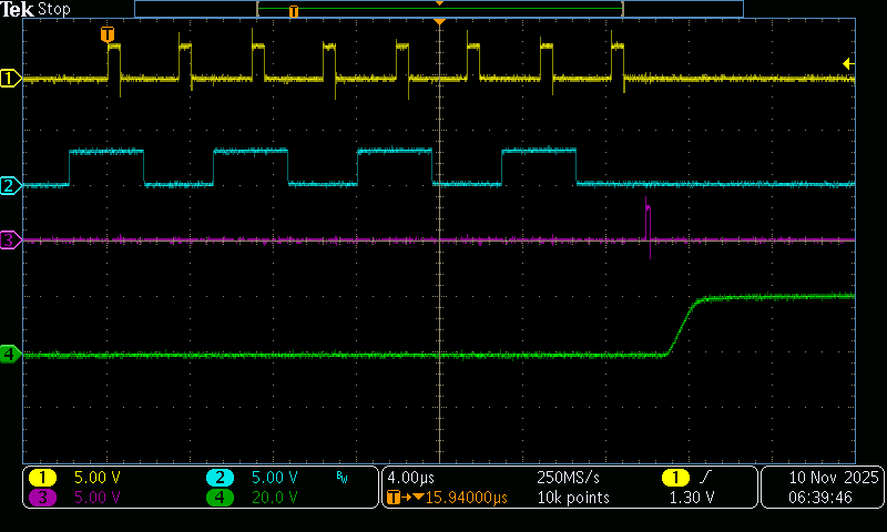

Test3 is with the outputs alternated. it does not work. It is my understanding that spi clocks data in on the falling edge of the clock, and the waveform looks perfect for this interpretation. It just doesn't work..
From this I surmised that the chip wants to clock on the leading edge of the clock, so I built Test 2, which works just fine, but ignores the special capabilities of the P2.
so, my question is:
Can the SPI mode be adjusted to land the clock in the middle of the data? or switch edges?

    I figured out how to do the inversion, (perhaps not the only possibility, is there a better one??). It shifts the change of the next bit of the dat to about 38 nS after the positive clock, i think the chip doesn't like that... it's just not that fast.
    Here is what I tried in jm_ez_spi:
    Perhaps I have misapplied ez_spi here, since this isn't really spi...
    Thanks!

  • Jon,
    I think you are absolutely right. My Test2 data above was originally almost exactly like your Spin example above... it was too fast for the TPIC6595 and I had to add delays to get it to work!
    That solution is perfectly adequate, and is as you said much shorter than the smartpin version. Just not as cool... and I am still done with all 8 bits in < 12 uS (Using FlexProp).
    Thanks!
