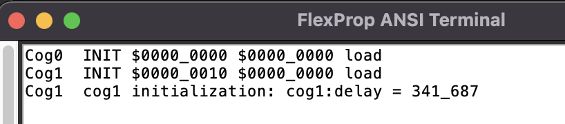

I've attached a super dumb p2asm program I've been experimenting with to try and understand these details. (I realize I can use events for both loops :) this was just previously all in one loop for some other testing) The hubset / pin stuff at the top came mostly from the silicon docs, I hope I got that right. It does all seem to work.

    In your file you did it wrong because you're starting cog 1 in cogexec mode, but the code is assembled in orgh mode.

    This isn't entirely clear to me yet. In my program I have 3 variables, and for instance delay_count which is currently being used from code assembled for hubexec (thanks for that explanation! I had in fact not understood that either...) what cog ram address does delay_count end up in, and why? Based on what you said just now I'd expect it to be at 0 then? or is the address of delay_count actually just whatever address the end of the cog 0 (the stuff I called entry) code was?
    The way you've written, yes, they end up after the code. delay_count is at $020 (you can see this if you assemble with the -l flag to get a listing).
    Generally you'd use cog RAM like this: code first, initialized variables/data second, uninitialized variables last, then finish off with a fit directive. You can see this Data/code can really be mixed and are the same, but uninitialized registers (RES directive) must go at the end. This is obvious when you consider that the code/data part needs to be loaded in one contiguous block (either stopping at the end or loading unrelated data beyond the end). If RES is used in the middle, the cog address count and the assembler position desync and nothing makes sense anymore. (Flexspin will print a warning if it detects this). I've attached a file that's a good example of a typical Spin-usable PASM object that showcases this code/data/res layout.
    The use of delay_count in the second cog's code is erroneous, because $020 is only relevant to the first cog's memory layout. If you made that code any longer (remember, you're (also erroneously) starting into cogexec mode), you'd be overwriting one of your instructions that got loaded to $020. This is a general footgun hazard when having multiple different cog codes in the same asm file. If you look at big single file ASM projects I've done, you'll notice that all the labels have prefixes: https://github.com/IRQsome/NeoYume/blob/master/neoyume_lower.spin2 There has recently been a namespace feature added to flexspin to reduce the tedium, but I haven't gotten around to using it in a serious project yet.

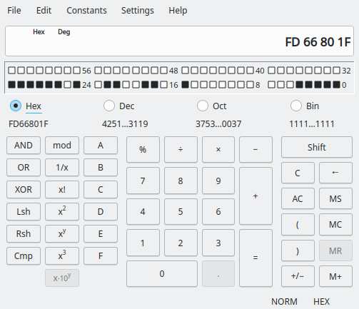

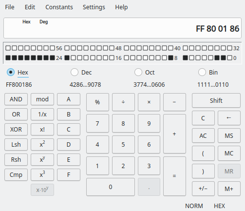

    It is a brain twister. The hexadecimal format doesn't align nicely with 9 bits, and little endian doesn't help either.
    Start with the easy one: WAITX ##20_000_000/100
    200000 is 0b00000_000000000_110000110_101000000. I've divided it into lots of 9 bits (lsb justified) to help find this binary pattern in the two instructions. First one is the prefix, it contains the upper 32 - 9 = 23 bits in its lower 23 bits. An easy match of 0b00000_000000000_110000110
    Second instruction contains the lower 9 bits: 101000000. But because it's the D operand then that's positioned from bit9 to bit17, which you can see here is a match
