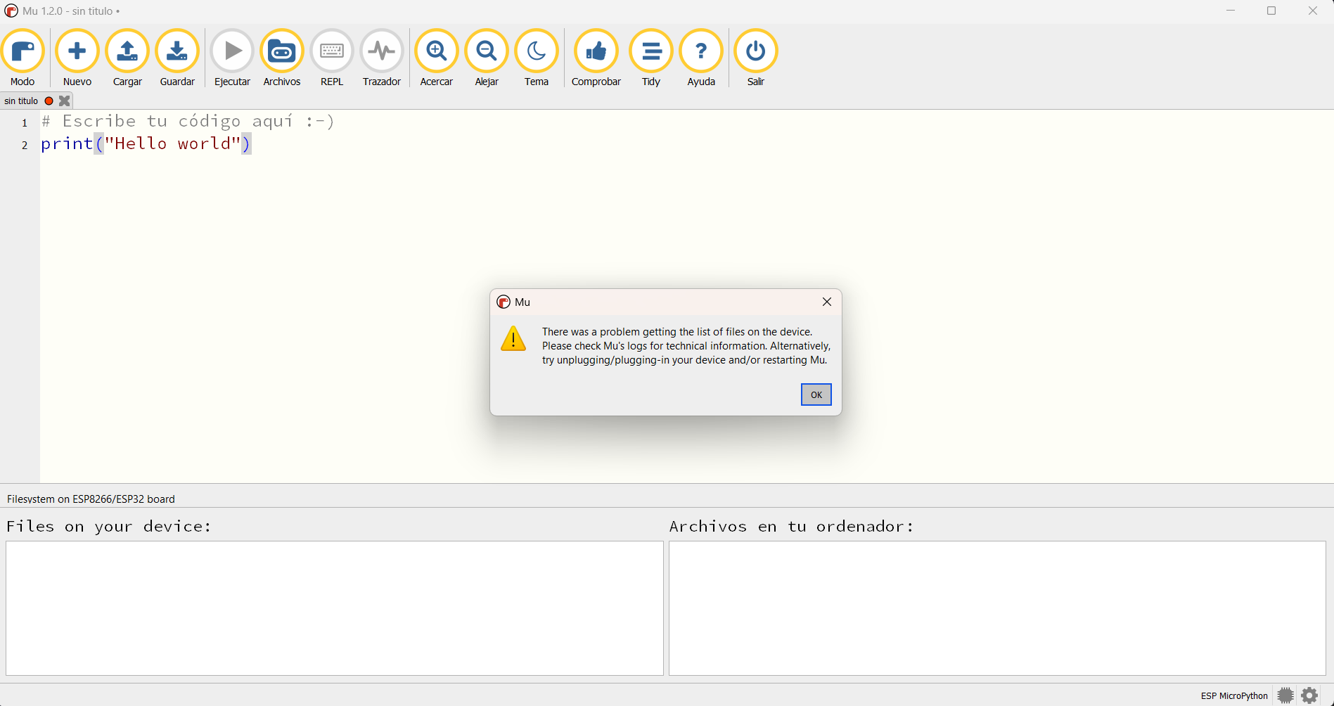

When I click on “Files” in Mu, I get this popup:

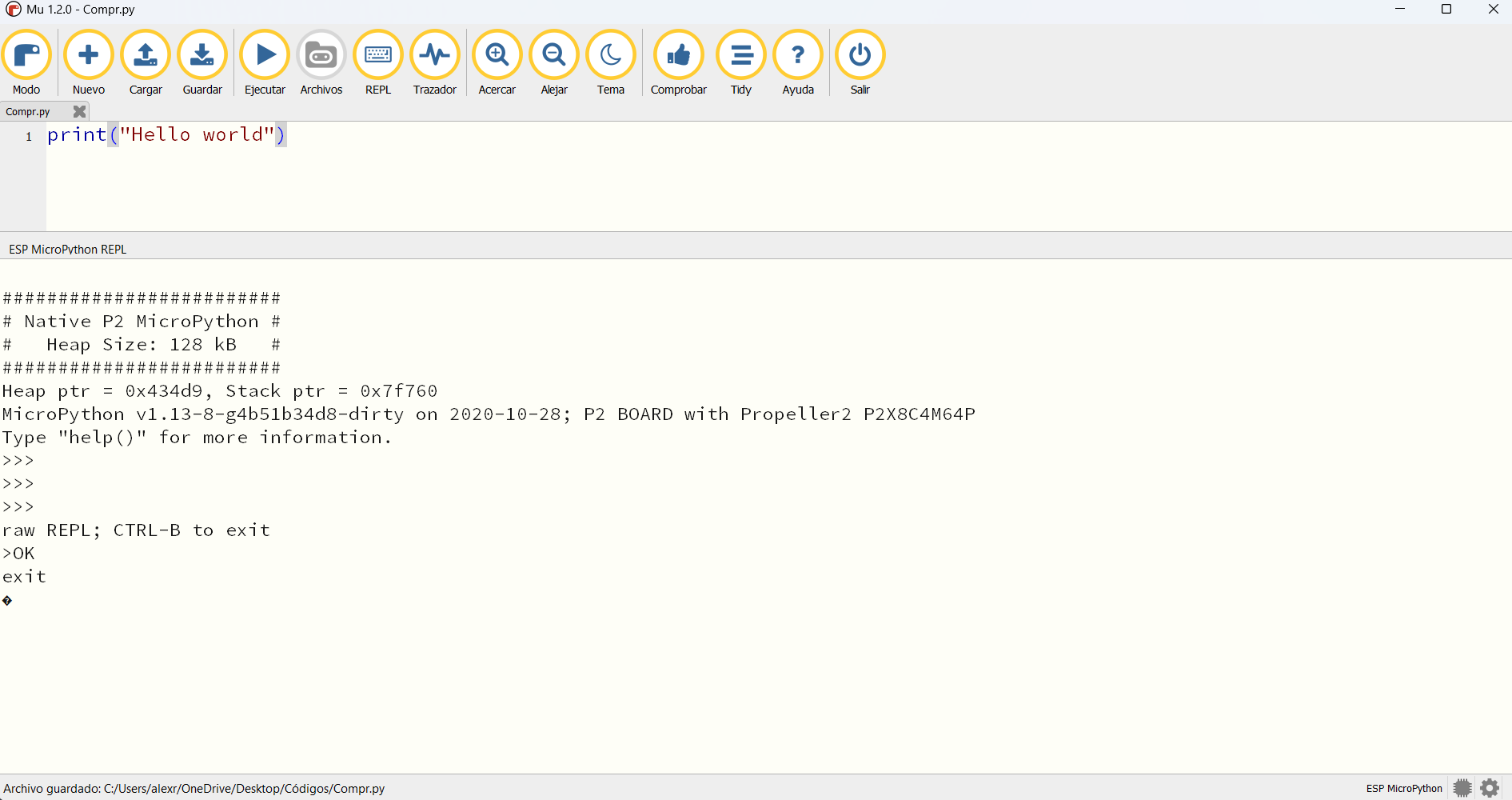

Running a script gives this error:
where the REPL becomes locked and I have to restart it.

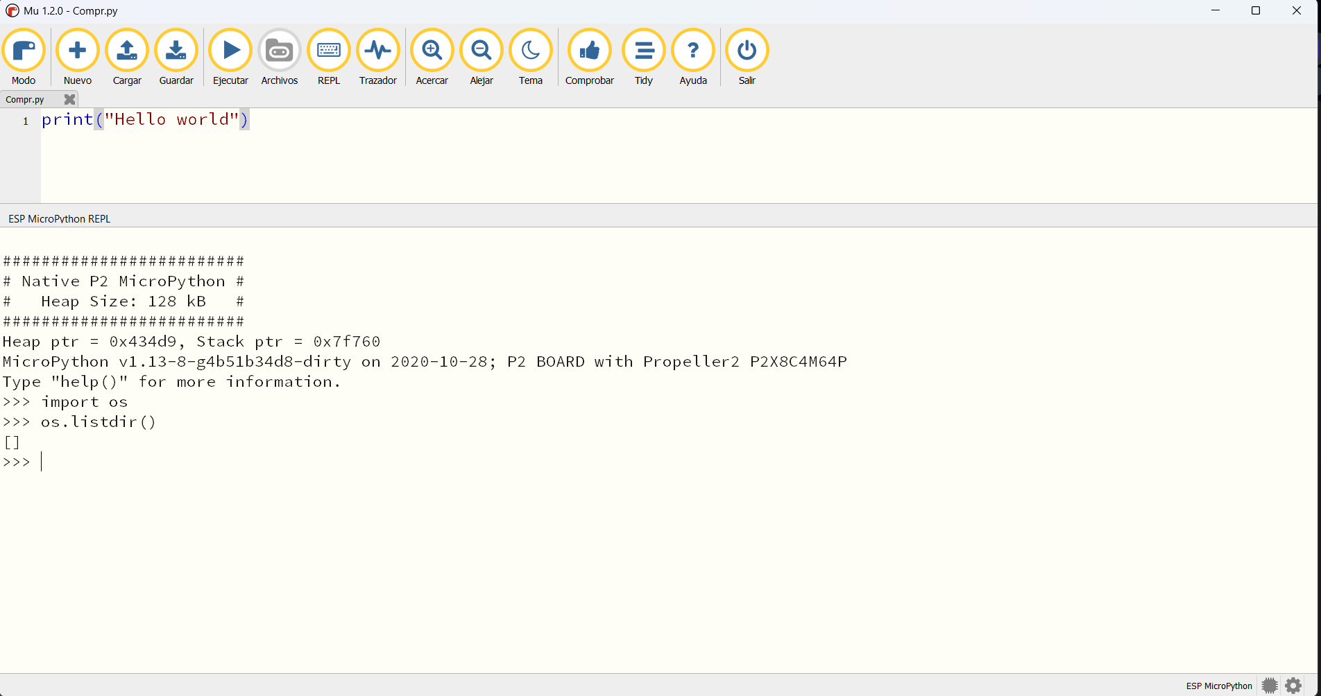

In the REPL, importing the os results in:
So it seems there’s no filesystem detected by MicroPython.

    The P2 Native Micropython build goes back 13 or 14 versions now, to a time before littlefs being implemented. We put OzFFS in there to plug the gap but this was something fairly minimal to plug a need at the time. It just resided in the standard 128Mb flash common to all boards (P2Edge-32MB included).
    I don't recall trying Mu's 'files feature', I think this likely makes use of the ability of RP2040 to emulate a flash drive, which we never did with the P2 native Micropython, it was also prior to tinyusb being folded into Micropython.
    None of this probably helps you much, sorry. Is Mu required for what you need to do? A lot of the MP work we did was actually with a keyboard and monitor attached to the P2, I think some features were only available this way. If you can tell us a bit more about what you're hoping to do we can at least comment on whether there's a way.
