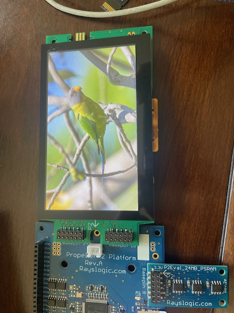

Been learning how to use the exMem (external memory) driver with the raycasting code:
https://forums.parallax.com/discussion/169389/90s-style-3d-now-at-16bpp-using-psram#latest
Now, trying it with something perhaps more useful, an exMem based video buffer.
Thinking 16bpp in WVGA is a good place to be.
This allows use of a single PSRAM chip with plenty of extra bandwidth (probably).
Could be regular VGA, HDMI, or IPS LCD display.
Here testing with a 4.3" WVGA IPS display in 16bpp mode, as described here:
https://forums.parallax.com/discussion/176069/4-3-and-5-0-ips-tft-16bpp-adapters-for-platform-eval-edge#latest
This code is showing a WVGA bird image from exMem (specifically the 24MB PSRAM module).
Pretty sure just using the first of three PSRAM chips.
Just got it working a minute ago. Seems perfectly stable and there's no flicker at 300 MHz.
Think needs about 250 MHz to prevent flicker completely. Will need more like 300 MHz for HDMI...

    Thinking there's enough bandwidth and HUB memory to do an HMI type application where a new frame is put together in HUB RAM and then sent to exMem for display. Should be able to make it fairly responsive.
    Not enough HUB for full image though, so maybe have to do half at a time.
    Or, use exMem for both image buffers.
    That might be a bit slow, have to check.
    Using the 16-bit wide PSRAM would surely be enough.

    Cleaned up the code a bit and turned it into a slide show.
    Every 5 seconds it copies an entire image from one place in PSRAM, to the display buffer in PSRAM.
    This appears instantaneous even with no syncing with display cog.
    That's a good sign that bandwidth is plenty, even with 4-bit PSRAM.

    Using my graphics requests within my memory driver you can easily update window data fast. As well as HUB to ext-mem and ext-mem to HUB I also have a ext-mem to ext-mem graphics copy request so you can blt window portions about in single requests in the background while you do other things. It does slow down more for very hires and deeper colour configs but a paint API that refreshes only rects that are needed would easily allow windowing/GUI applications on the P2. The key is to keep your drawn window parts in external memory and only repaint what you need (i.e. not the entire screen every time). Also dragging window outlines instead of window contents can help if you are moving windows about with a mouse, prior to the final update. Rendering optimized for line at a time transfers into graphics memory is also more efficient. e.g. text.
