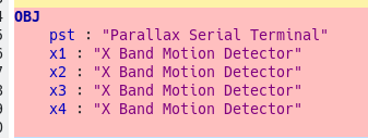

when I have 4 of these X Band devices hooked up, and code it this way, does it use 4x the memory? Do I have to make a clever multipin X Band Object to make better use of memory?

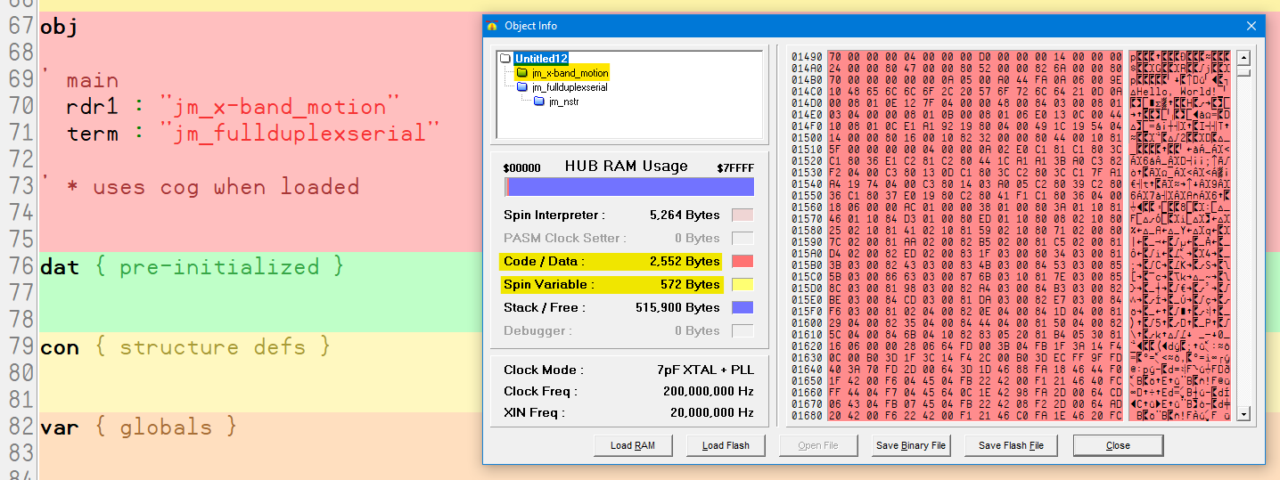

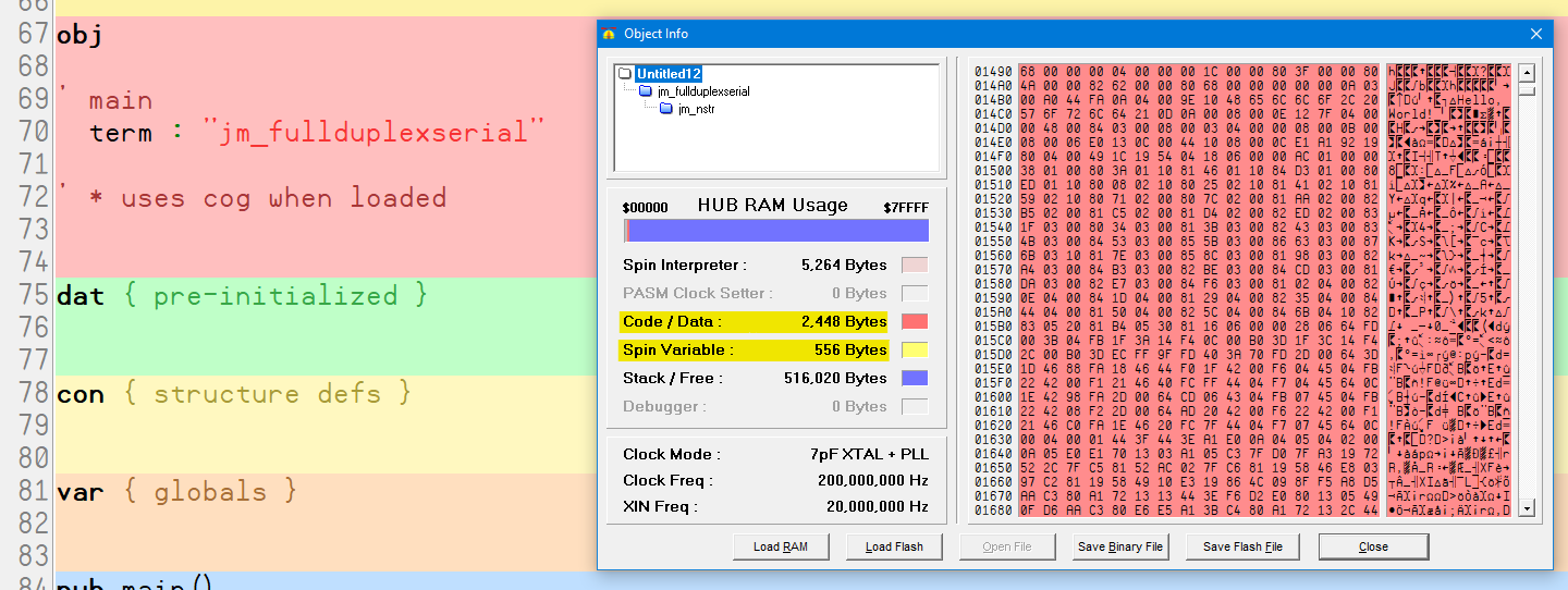

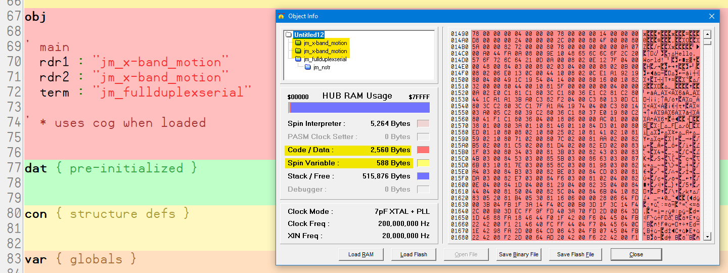

    Quick test with my version of the x-band object.
    #    Code  Delta    Vars  Delta
    0    2448      0     556      0
    1    2552    104     572     16
    2    2560      8     588     16
