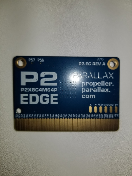

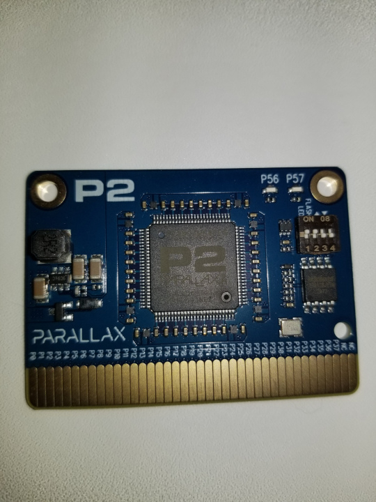

    evanh - Thank you for the quick reply. It is a Rev A Edge Module. Does that mean it has a Rev A P2 as well. Here are pictures I took.
  • evanhevanh Posts: 17,005

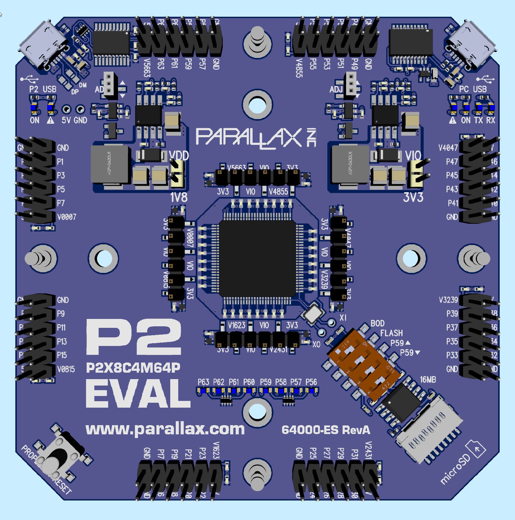

    You're all good with full support, that'll be a revB or RevC chip. RevA chips were exclusively on revA Eval boards.

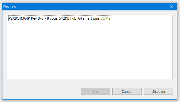

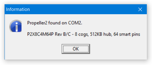

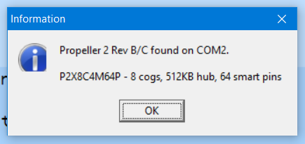

    BTW how can you tell the difference from a Rev B and Rev C P2?
  • JonnyMacJonnyMac Posts: 9,554
    Perhaps by the date on the chip. PNut, Propeller Tool, and Spin Tools can't distinguish between B and C.

    As I recall, there are only about 160 Rev A Eval Boards in the world.

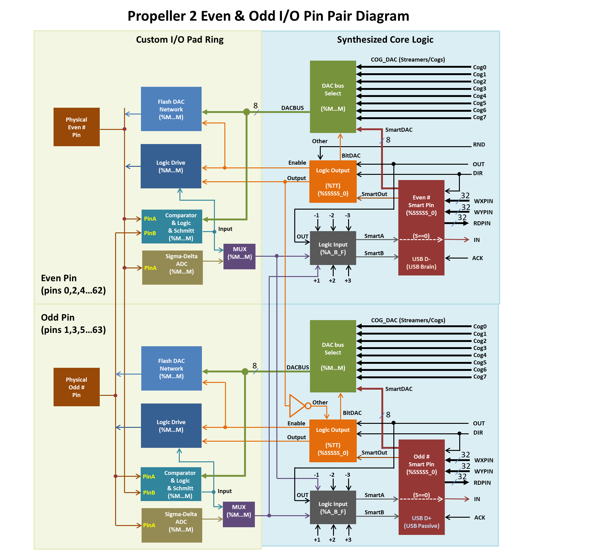

    I think the only change in the revC chip is the signal path of pinB inside each ADC has been cut - Done to prevent crosstalk onto pinA. Presumably done by a hand modification of the relevant mask - Since that was part of the custom pad-ring and wasn't eligible for any changes. ie: It may have been snuck in unofficially.
    I believe that was the only change - To save money and time. The whole Prop2 development had been a long one and OnSemi were getting crabby about no production occurring.

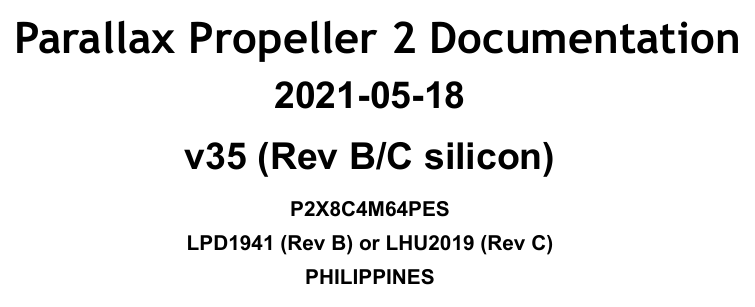

    EDIT: Here' we go. There is a marking difference on the package:
    EDIT2: Ah, that's just the batch numbers for the "Engineering Sample" batches. Newer revC's don't have the ES at end of part number and have different batch numbers again.

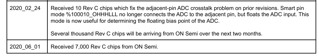

    In the function block diagram where only PinA goes into each ADC, in revB silicon the ADC could select between PinA and PinB.
    Further reading: HTML version of the detailed and useful Silicon Doc written by Chip - https://p2docs.github.io/mirror/p2silicon.html
    It contains the dates of involvement with OnSemi. Pertinent revC entries at the end:
