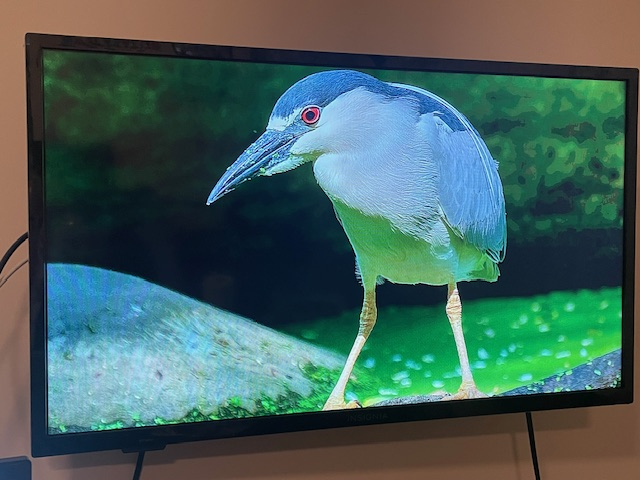

  • RaymanRayman Posts: 15,895
    edited 2025-09-28 18:03
    Guess one thing to consider is that Chip's driver is faster (at least that's what I'm seeing).
    Here's it doing 720p. Doesn't seem like the exmem_mini can do it... (Well, not at 16bpp anyway, think can do 8bpp)
    (should actually tweak the platform driver if want to do 300 MHz. There's a barely noticeable few pixel flicker. All good at 280 MHz though...)
