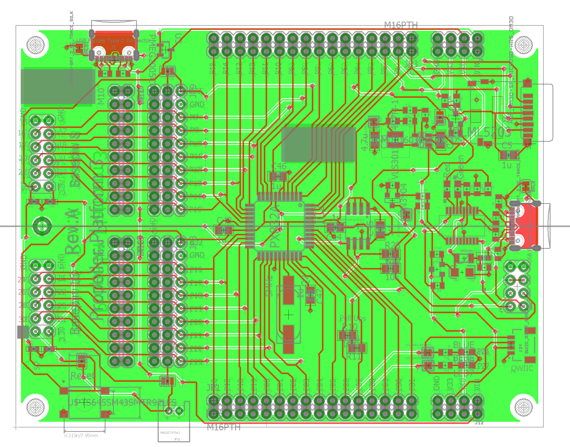

Need a new P1 board for a battery powered full color E-Ink display...
Haven't made a P1 board in a very long time, so this is fun.
Here's the concept so far (see image).
Think the last "platform" board for P1 that we made was called "Express".
This is an expanded update.
USB connectors updated to USB-C
FTDI chip updated to FT231X.
Doing this in Eagle, think was ExpressPCB last time. That was smaller, this is full size...
Adding a QWIIC connector (cause that's an easy way to add peripherals).
Added two P2 style headers, not sure what will do with those yet.
Adding a middle proto area. This is where the E-Ink adapter will connect.
Could have two of them...
Adding a second USB-C connector for power only (no serial).
Adding two pull-up resistors to uSD, even though maybe not 100% needed.
Adding a couple blue LEDs.
Think that's about it...

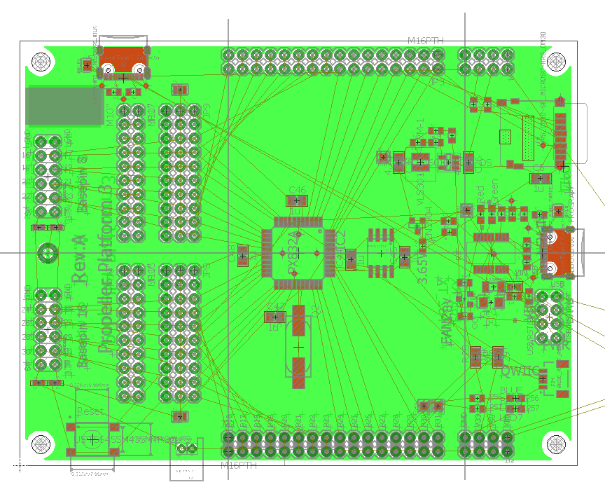

Update: Here's initial layout...
Update2: Made a blunder with first version and programming lines were not connected to P1 due to copy and paste error from P2 circuit :(
But, just assembled some of the revised boards and all looks good :)
864 x 695 - 151K
1852 x 1453 - 467K

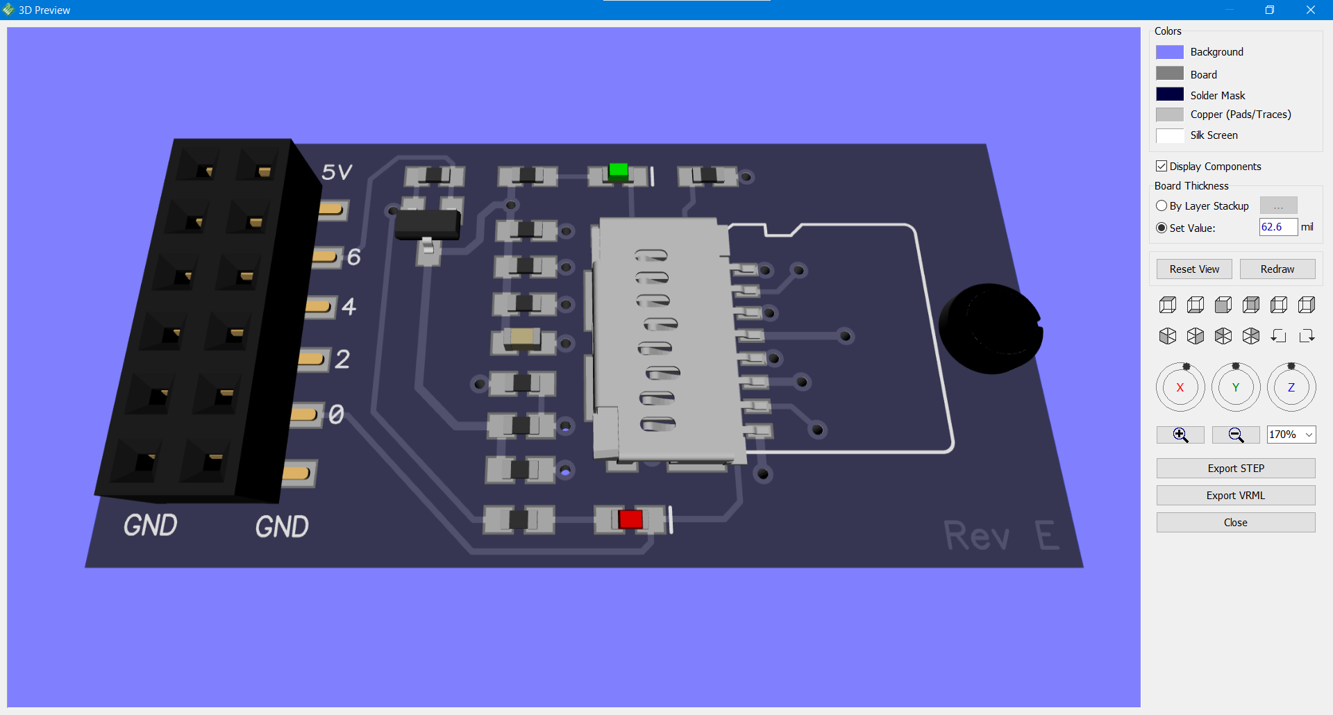

    Do you have a power pin (PFET) to cycle power on the uSD?

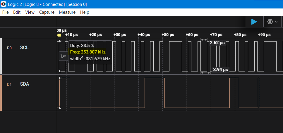

    Is the Qwiic port shared with the EE I2C pins? One thing to be mindful of is that the P1 drives the clock line and the boot-up I2C frequency is a little over 250kHz. Devices that can only tolerate 100kHz (usually devices with small processors) can interfere with writing to the EE. I had this happen with a Sparkfun I2C 7-segment display and had to move it to its own set of pins.

    @JonnyMac Is there any P1 board with power pin for uSD? Could add one with option to bypass if need the pin.
    You might be right about I2C pins. Do not want anything messing with boot from EEPROM. Can add solder jumpers to disable the pullups. Actually, think most QWIIC things come with pullups. Is that true? Think so...
    I created a P2-type accessory that works with the P1 and the P2. Having power control requires an extra pin, but given the tricky nature of uSD cards, might be worth it.
    I think you're right. You might put light pull-ups (e.g., 47K) on the EEPROM so that if nothing is plugged into the Qwiic port (assuming it's shared), things don't get too stiff (though that's usually not a problem in my experience).
    1920 x 1030 - 183K
  • Don't need power switch if you're just going with SPI mode, don't think I ever saw a lock-up even under extreme access patterns. It is needed for native SD mode, since if you enter it once, you can never ever get back out of SPI mode without a hard reset, but we're not doing that on P1. Also the pull-ups for the SD data pins need to be behind the power switch for it to work 100% properly, which would be annoying for secondary use of the SPI bus.

    Here's an initial design. Don't see room for PSRAM. But, think have plenty of memory boards for P1 Platform in the stash somewhere...
  • RaymanRayman Posts: 16,154
    edited 2025-09-23 18:12
    Added connectors for bluetooth (HC-05), wifi (ESP-01), and ultrasonic distance (HC-SR04). Haven't used any of these before, think they might work.
    Added a coin cell battery connector on the bottom.
    Also added a place for a large capacitor in case want to connect servos...
    The second USB-C power can be isolated from main power so that servos can't take down the P1 with power glitch.
    Think it's in good shape now...

    Finally put one mostly together :)
    Seems made a rather bad copy and paste error from P2... Seems P1 doesn't have P62/P63 for RX/TX... :(
    Works with jumpers, but have to get this fixed...

    About to test the mosfet controlled power to uSD. Maybe the need for it is questionable, but it is there if needed and can be bypassed with solder switch if not needed.
    But, one reason maybe to want it is when operating P1 off of a coin cell. Actually, have to make sure uSD will work with coin cell 3.0 V...
    Anyway, to save power might be good idea to turn off power to uSD and the pullups.
    Was looking around the web and seems that idle current draw in SPI mode may or may not be something to worry about... It's not 100% clear to me...
    The default state is to not use P4 for power control. One would need to flip the solder switch to enable it...
  • JonnyMacJonnyMac Posts: 9,742
    edited 2026-01-11 19:54
    I use a PFET in my new designs. This is my P2 code, but it easily converts to P1. It has worked well in our Battle Tower product.
      if (sd_inserted(sddet) == false)
        return false
      repeat 5
        sd_power(sdpwr, true)
        waitms(50)
        mount_sd()
        if (mounted == true)
          quit
        else
          sd_power(sdpwr, false)
          waitms(50)
    I got the power cycle timing from ChatGPT and then made it a bit longer.

    Tested QWIIC and it's good. Connected to P26 and P27 'cause maybe don't want to risk messing up the I2C eeprom for boot. But now, maybe will add solder jumper so can pick either P26&P27 or P28&P29 for the QWIIC. Might be useful of low on pins...

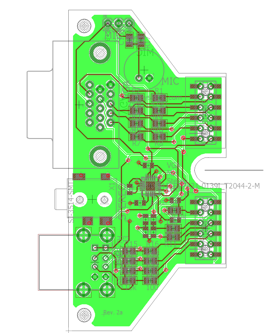

    Wanting to make a VGA/keyboard&mouse/audio accessory board for the eval style headers here...
    Thinking about using USB connectors instead of PS2 connectors. PS2 to USB connectors are 4 for $8, so not really a big deal. Also, I'm hopeful that regular USB keyboards and mice will work in PS2 mode if they detect the 10k pullups. Will be interesting experiment...

    Anyway, going to go forward with dual USB wired for PS/2 instead of real PS/2 just because is smaller and looks better.
