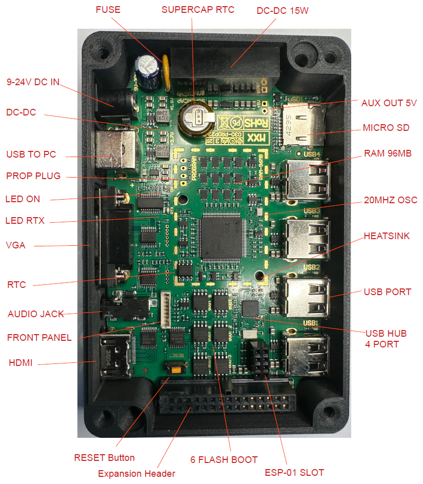

Dear All,
let me introduce the latest (final?) version of my P2 board, You can find the first version at P2EDGE gaming/standalone breakout discussion.
It briefly consists of:
  • 96 MB RAM with 16bit Bus (previous 8 bit bus)
  • USB port for programming and power supply (USB type B )
  • Additional PROP PLUG header
  • Additional 9 - 24 V power supply input (for 5V 15 W)
  • Additional leds for power supply and rtx signal (previous rtx only)
  • Front panel connector
  • High precision RTC (supercap backed up)
  • Selectable boot from 6 different flashes (previous 4 flashed)
  • SD card high speed 4 wire bus (previous slow mode)
  • USB hub 4 ports for joystick, keyboard and mouse (previous 2 ports)
  • VGA connector
  • Stereo Analog audio out (headphones or line)
  • HDMI connector (previous not available)
  • ESP-01 or ESP-01S connector (previous not available)
  • Shared 16 bit expansion connector (previous not shared)
  • ESD protection
  • Optional dedicated heatsink Code 345-1744-ND (previous not available)
  • 6 Layer PCB (previous 4 layer)
A major difference compared to previous PCB is about heat dissipation. The two additional layers increase heat transfer to external connectors (acting as heatsink).
I designed this board in an attempt to reduce the connections mess between P2 and the various peripherals typically used.
Furthermore, this board will make it easy to experiment with all those fantastic software related to the world of retro consoles and audio-video systems in general.

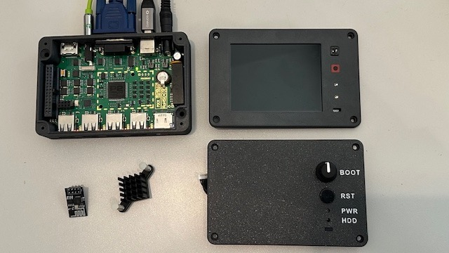

Another difference is the front panel which is now interchangeable with various options such as the 3.5" display and the 4.3" display which will be coming soon.
In the photo we can also see other accessories such as the heatsink and the ESP-01 module....

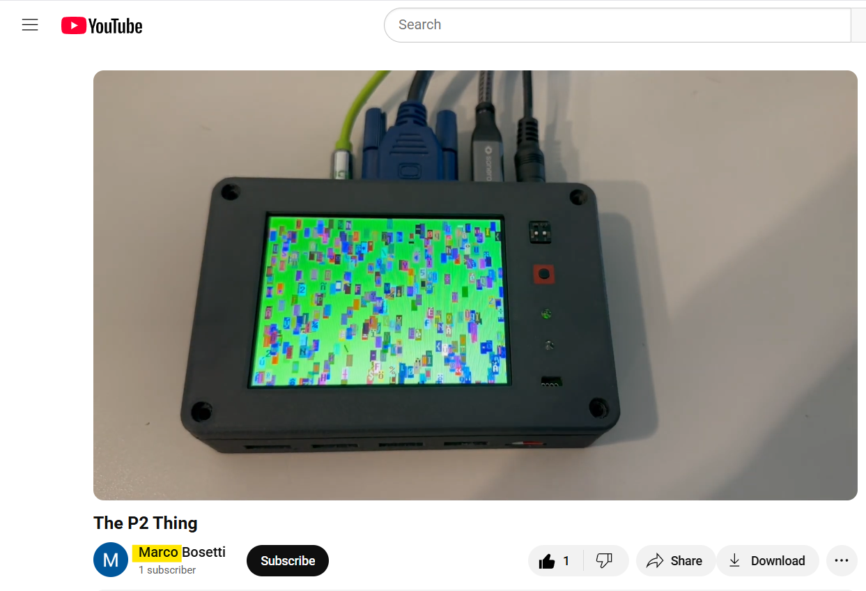

The LCD display is driven with 16 wires but in 24bit RGB configuration thanks to the help of latches so it does not require any initialization.

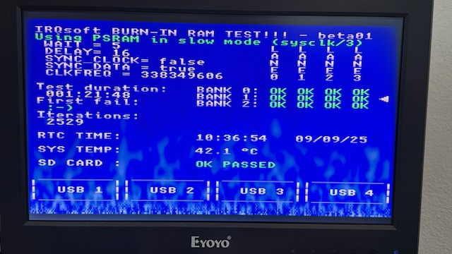

I also prepared a modified version of the Burn-in RAM test software created by Werfel_21 in order to quickly test the other peripherals on board.
    Nice re-use of the RAM tester text driver thing!

    Most of the hardware is tested and working as expected so far. One thing left to try is the fast 4 bit SD card interface, some help needed here.
    The LCD panel responds quickly because it was inserted "hot" with the firmware already running...... also, perhaps by mistake, I compiled the demo with FlexProp that's why it's very fast (about 10x compared to propeller tool).
    LCD test software is thanks to @Rayman, I only adapted the pasm LCD driver to fit my circuit.
    No big issues in running the LCD panel as it's a raw 24 bit RGB parallel interface, (latched as 8 bit R / 8 bit G / 8 bit B to save some pins).
    I would say PSRAM block was a bit tricky.

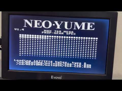

    I just realized the NeoYume you pre-loaded isn't using 4bit and when I build with that it doesn't work!
    Uuhhh, I think that's a problem. I apologize profusely for forgetting to test it. (I was in a total rut for a few months...)

    Okay, so I've narrowed it down a bit:
    The problem seems to be with the card power switch.
    If I set the following config to disable it, SD4 is working:
    #define USE_SD_4BIT
    SD4_DAT0 = 16
    SD4_CMD  = 20
    SD4_CLK  = 21
    SD4_PLED = 22
    SD4_PPWR = -1
    But the expected problem of only being able to mount the card reliably on cold-boot appears. Launching any other program that puts the SD card into SPI mode needs a power or insert cycle afterwards.
    Relevant bit of schematic:
  • Wuerfel_21Wuerfel_21 Posts: 5,689
    edited 2025-09-09 22:14

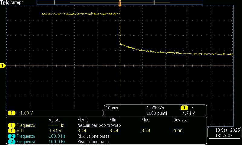

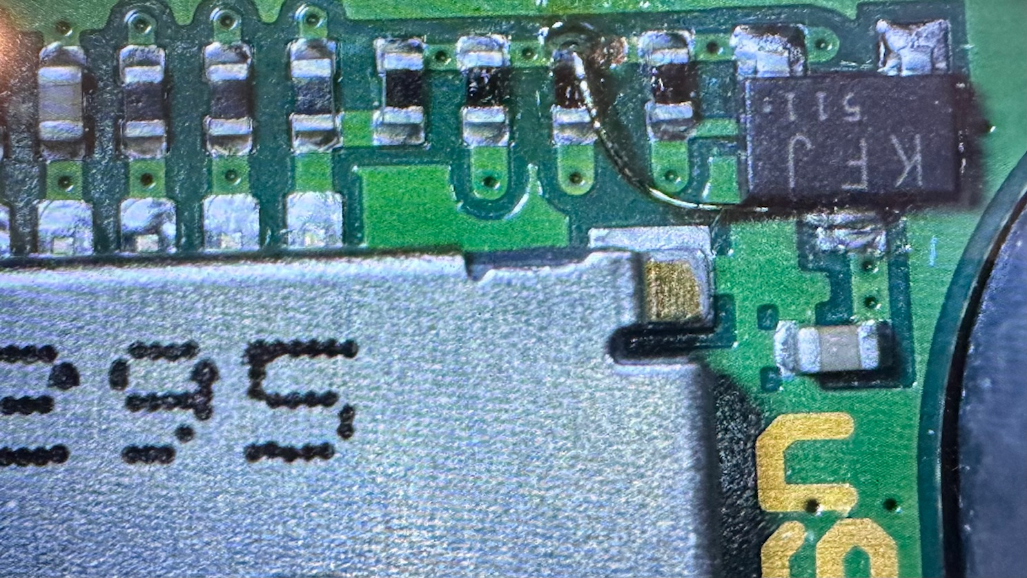

    Building with -DSD_DEBUG begets us Error: Stuck high at SD power-down.
    I think I see the problem! The actual power switch does work, but you've routed the pull-up resistors to VIO (pre-switch), but they must go to VDDSD (post-switch) instead. The driver tries to make sure the power is actually off by sampling the CLK pin with the P2's voltage comparator. This doesn't work if the pull-up is always high instead of being referenced to the SD power.
    This is the correct setup as seen in the reference schematic:
    Luckily this is a software issue that can be worked around! ( @evanh will try to kick me, I'm sure )
    Go into sdsd.c (included in NeoYume in blkdrvr directory) around line 242 and change
    Correct. It is intended to comply with the SD spec of requiring a power cycle to be below 0.5 volts on VDDSD for at least 1.0 millisecond.
    A software workaround for a hardware issue, thank you very much!
    EDIT: I've also pushed this nasty patch to the bundled SDSD driver to NeoYume's GitHub/SourceHut repos
    You're now relying on a 500 ms delay for the capacitors to discharge and just assuming it works without confirmation. The routine could be notably reduced in size ...

  • evanhevanh Posts: 16,856
    edited 2025-09-09 23:43
    It is still problematic. The whole power cycling sequence still may not be working because all those pull-ups will be supplying power to the SD card.
    You'll need to get a scope on the SDVDD power rail to see what is really happening.
    EDIT: I've changed the routine above to hopefully drain the capacitor by overpowering all the pull-up resistors. I guess it's not too different to the original sequence since most of the pull-ups were driven low there too. Just the CLK pin extra now.

  • MXXMXX Posts: 15
    Thanks @Wuerfel_21 and @evanh for trobleshooting this SD issue, meanwhile we found 2 things:
    • Card detect isn't working as expected. The card is always reportes as inserted.
    • Better to move pullups after MOS switch
    I made a crappy patch on the board to move the pullups after the switch, a quite easy task hopefully.
    Now 4 bit SD driver is working and is blazing fast! (see video, 700 MB in 5s, impressing)
    I checked with scope before the modification and in fact the SDVDD signal was not dropping low enogh (probably due to pullups always high).
    This is the patch :smile: one trace cut and a wire added
    The next board revision will include this fix for sure.
    edited 2025-09-10 20:15
    Tidy fix, good to see!
    Thanks for posting the scope screenshot too. Good to see how bad it was.

  • You can see that the big graphics data ("Type 6", LOAD_CROM) is much slower to load than the other data. This is because it has to read from 2 files and interleave the data. This means it's reading disjoint 16K blocks instead of a nice contiguous file. The interleave code also probably becomes significant at that point. See also: https://git.sr.ht/~wuerfel_21/NeoYume/tree/master/item/neoyume_upper.spin2#L442 (I think the code is fairly optimized, but those block reads might still have some wiggle room for optimizing stall cycles)
