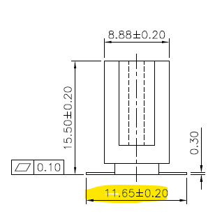

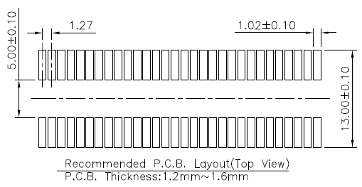

Hi, I made the footprint for the P2 Edge SMT socket according to the datasheet:

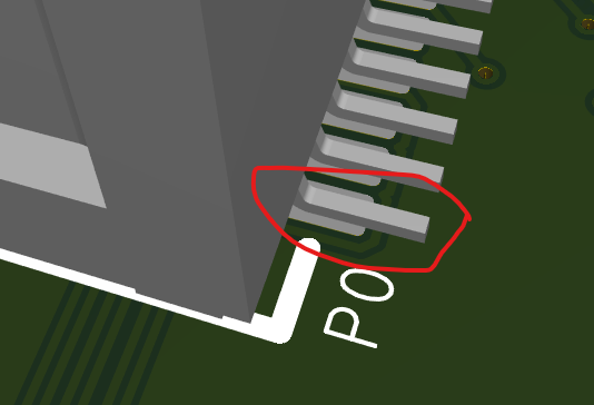

but the 3d model looks wrong.. I presume the datasheet is the one that is correct, but i just don't get warm/fuzzy from this. If anyone has one on-hand could you please verify this measurement?
Here is what I get in 3D:

    Just measured 11.61 mm. So guess that model is right...
  • RaymanRayman Posts: 15,895
    Footprint used before from Eagle has distance between pad outer edges at about 13 mm
  • Thanks! the datasheet is correct! 3D model difference isn't a biggie, but shook my confidence a bit.
