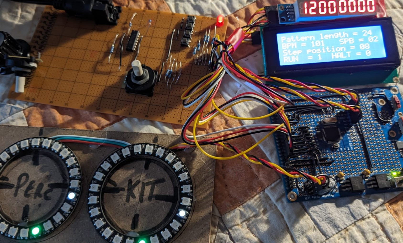

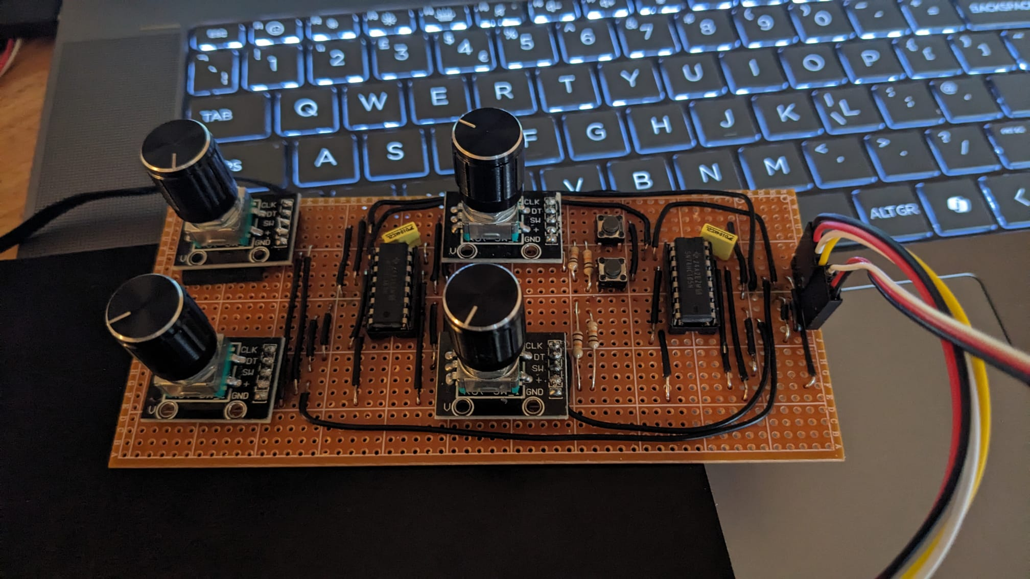

    To keep it simple I'm only using two '165s for 4 encoders and 8 push buttons.
    Here's my stripboard lash-up.
    Attached are Claude's (almost) first attempts at a driver and test program, seems to work, buttons are fine but the encoders are a bit sensitive and seem to miss a few steps.

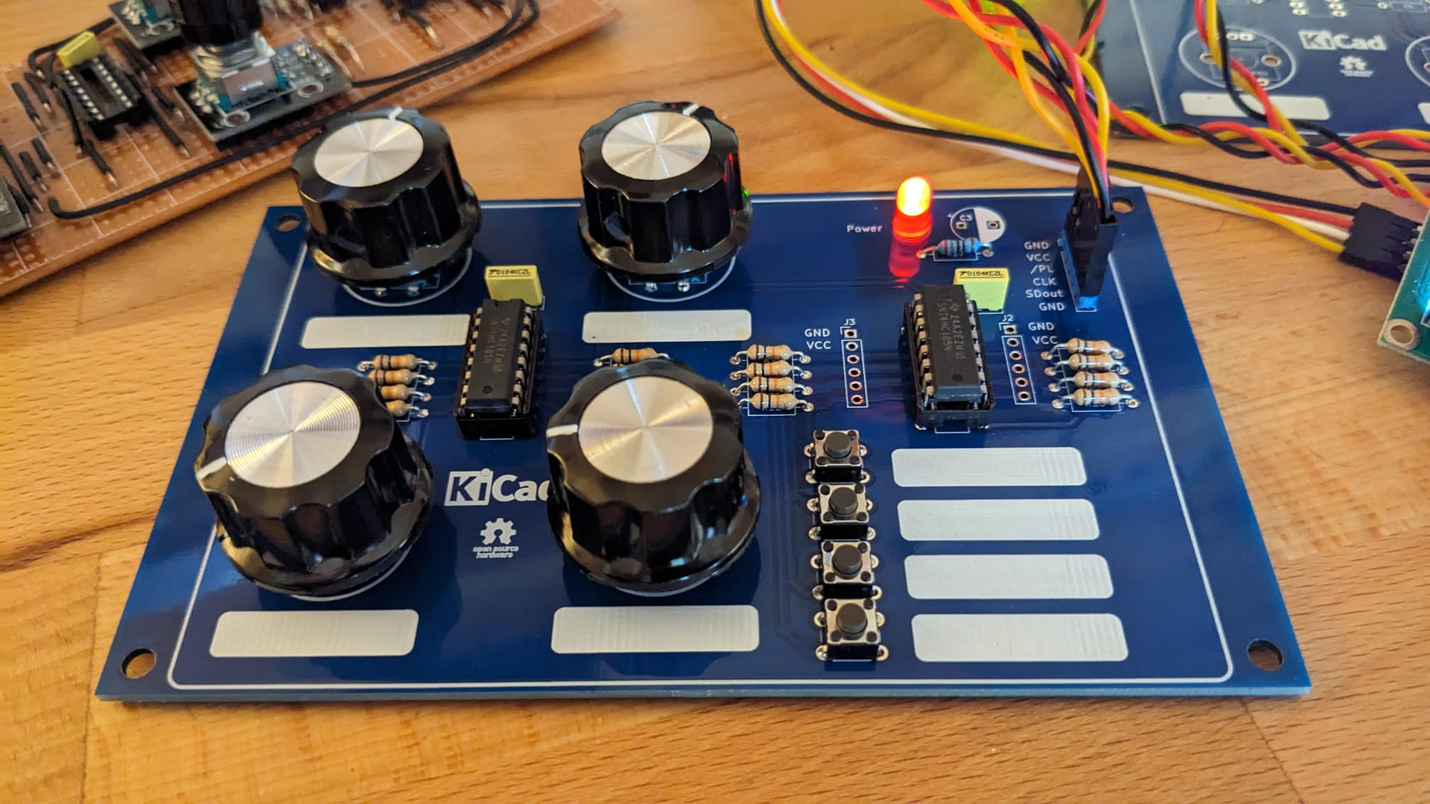

  • Now on a PCB, will try using Claude to improve/modify the driver and demo.
    edited 2026-02-13 10:38
    That looks very useful for instrument control / software radio experimentation. Four encoders would cut the menu 'hunting' quite a bit and make usage more pleasant. I remember HP once produced an oscilloscope with only buttons on the front panel. It was an awful user experience. Now scopes have long been back with a smattering of knobs and are much more intuitive again.
    I wonder if the encoders are such that their screw collars would fit through a front panel, along with the 'power' led if extended on it's leads. The buttons would need some 3D printed extensions to be tall enough to do the same. The connector could be fitted with a right-angle so as not to not get in the way. Cheers, Bob
  • Thanks Bob! PCB is working OK with some Claude AI generated code. I'm hoping to improve the code by pushing as many features as possible into the driver, such as setting the initial values, value clamping (so encoder changes beyond limits are ignored) and then just reading the values directly from the HUB memory in the main application. I used some buttons and knobs that I had to hand but I couldn't find my right-angle header strip :(
  • JonnyMacJonnyMac Posts: 9,809
    edited 2026-02-13 17:15
    If you want clean behavior you need to have your caller code clamp to your limits, and have the hub value called and updated by the PASM code. This topic came up when someone thought that I'd appreciate a, "Aha, JonnyMac! The AI found an error in your P2 encoder driver!" and went public without the courtesy of asking me about it first. It turns out that I knew the P2 better than the AI, and I would suggest that more than 75% of the programmers in these forums do, too. The problem was not in my driver, it was in the AI's limited knowledge of the P2, and practical, real-world programming with it.
    This is what I do with my P1 drivers (P2 has encoders built into Smart Pins):
    A) Read the new inputs
    B) If no changes, back to A
    C) For each channel
        -- if change in this channel
           * read current value from hub
           * update
           * write new value back to hub
    It's simple, but sometimes missed: Instead of simply returning the clamped value to the caller, write it back to your Spin-level encoder array so that the update is used during the next detected change at the PASM level.

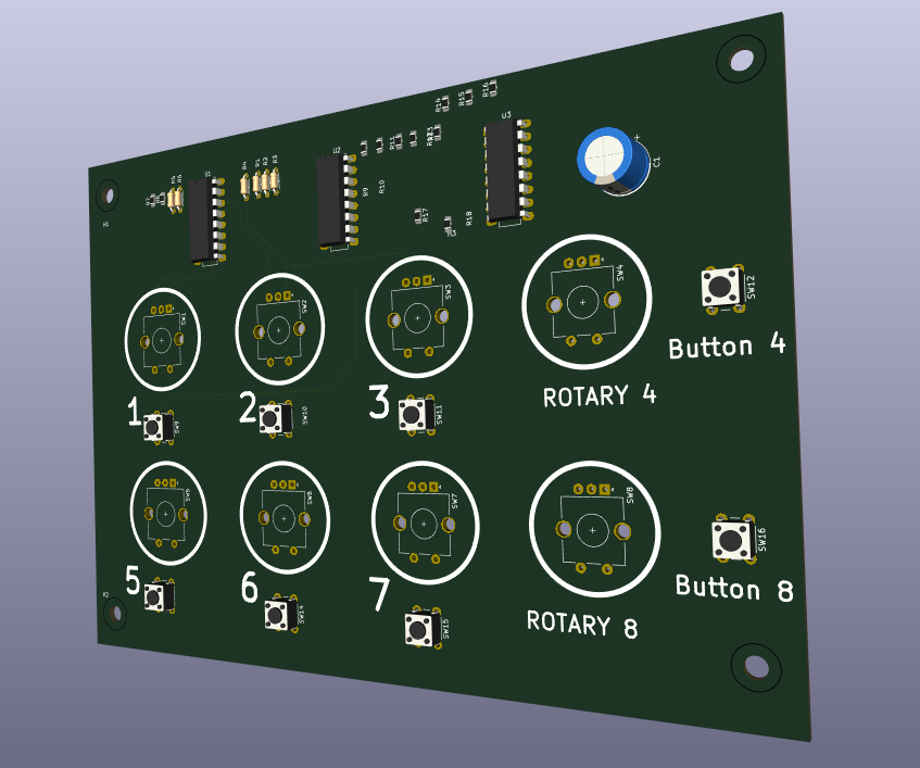

    BTW, f anyone is interested in the KiCAD project let me know and I'll share.
    Cheers, Tony
  • I chained a couple of boards together and helped Claude AI with creating an 8 encoder / 16 button '165 serial driver object and demo.
    Seems to work well. PCB needs an input header and switchable GND/ Serial_in for the first '165.
