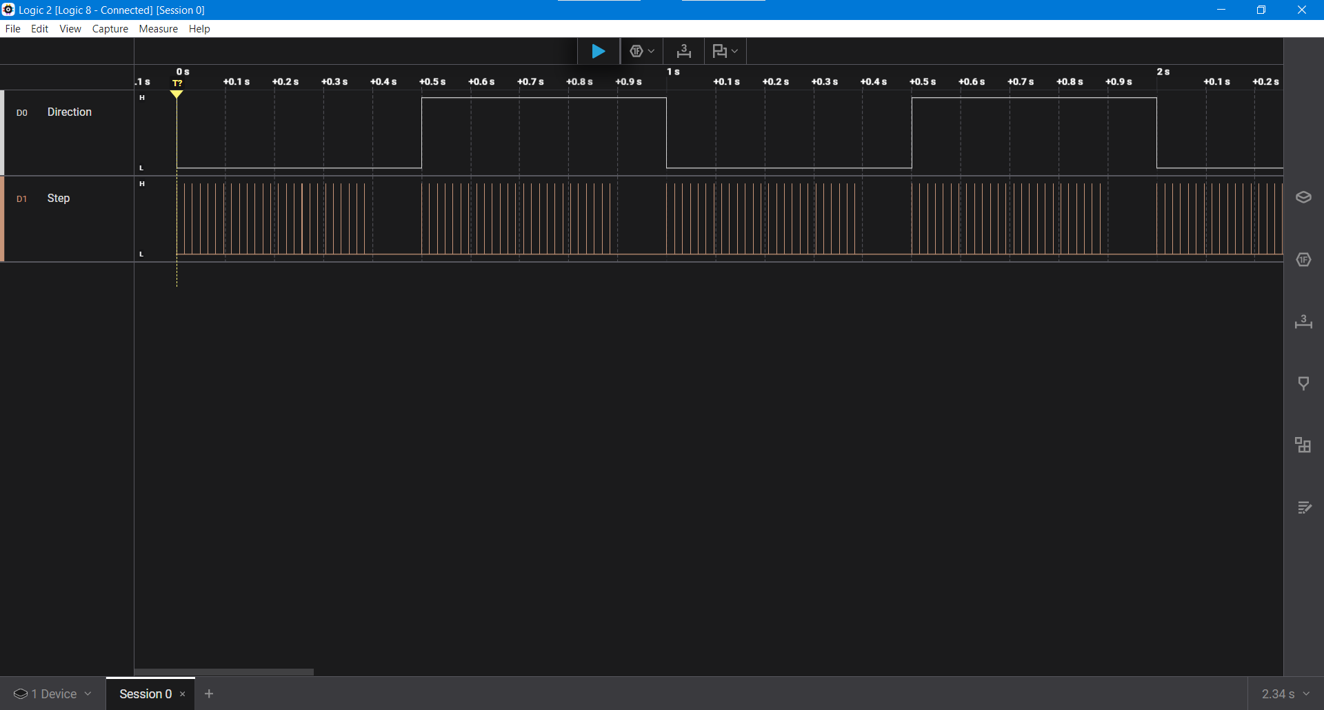

    I write a lot of code as a break time exercise and then forget about it. Apparently, four years ago I did that with the Click Stepper-2. It's a very simple object, but does seem to work based on connecting the control pins to a logic analyzer. I did freshen the object a bit (to match my current template & standard) and made a really simple demo.
    That said, remember the MIT License: there are no guarantees.
