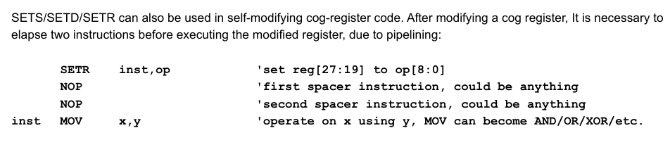

Is the correct translation of
                        movs      :getins, reg
                        movd      :setins, reg
this?
                        sets      #.getins, reg
                        setd      #.setins, reg
I used # because ChatGPT says the destination field of sets and setd is an address. Am I being too literal?

  • evanhevanh Posts: 17,215
    edited 2025-08-12 18:32
    I don't know Pasm1 all that well but it does look correct to me. SETS and SETD are the direct translation instructions and using # is the correct way to hit the target register number. If the # is removed then that D register gets loaded to reference another register. to be modified. EDIT: See example from Silicon Manual in post #7 below. EDIT2: In fact it's not possible to use a # in that position. It'll generate a syntax error.
    Rayman is correct that SETS/SETD are used far less often with the Prop2. It has ALTD/ALTS/ALTI instructions which will often do the job better - Via instruction modification in the pipeline instead of modifying the code in memory. This is also known as instruction-prefixing - Which doesn't get the bad rep associated with self-modifying-code.
    PS: Whether calling cogRAM a set of registers or a memory array is something of a terminology preference thing. I've used both. Sometimes It's just clearer described as a memory array, but mostly using register terminology works better since hubRAM easily fills the main memory definition on the proviso that the Propeller is considered a strong load-store architecture. It has no hubRAM addressing modes beyond RDxxxx/WRxxxx instructions.
    edited 2025-08-12 18:25
    @Wuerfel_21 said:
    However, due to changed pipelining, if you translate code 1:1, it probably doesn't Work Like That,
    True, two NOPs are needed on the Prop2. Here's the blurb from Silicon Manual:
    EDIT: Oh, looking at this example it looks like Rayman is correct about not using # as well.
